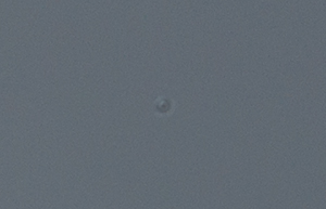

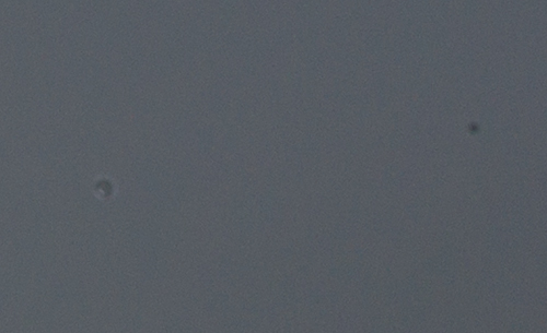

keithlaban.co.uk Posted December 8, 2014 Share #797 Posted December 8, 2014 I'd be grateful if some kind soul could take a look at the following links and confirm (or not) that the marks on the sensor are evidence of the M9 corrosion/delamination problem. They are quite unlike anything I've seen in the past consisting as they do of rings with a dark centre. http://www.keithlaban.co.uk/Corrosion.jpg http://www.keithlaban.co.uk/Corrosion2.jpg Thanks in advance. Link to post Share on other sites More sharing options...
M9reno Posted December 8, 2014 Share #798 Posted December 8, 2014 They look exactly like mine (pages 22 and 32 of this thread). I would say yes, this is de-lamination. 1 Link to post Share on other sites More sharing options...

k-hawinkler Posted December 8, 2014 Share #800 Posted December 8, 2014 They look exactly like mine (pages 22 and 32 of this thread). I would say yes, this is de-lamination. I had the same thought. It looks like the process has started. How old is that camera? 1 Link to post Share on other sites More sharing options...
