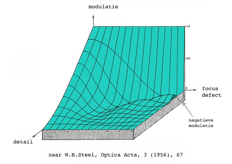

Dear Thomas,
MTF curves are always presented as measured or calculated in the plane of sharpest focus. Since Bokeh is a phenomenon defined outside the plane of sharpest focus, you need a three dimensional diagram including an axis with the defect of focus to say something about bokeh. Such diagrams exist in the optical literature. Below an example. Hopefully this solves your dilemma of searching for bokeh in MTF curves.
Sorry for the dutch labels, I have included them for a lecture series on optics. They translate as
detail = detail or spatial frequency.
focus defect = defect of focus or distance from the focal plane
modulatie = modulation or difference between white and black in the image
negatieve modulatie = negative modulation
Note that this is plotted for a single line through the optical center of the lens. You need a fourth axis for the radial distance to the center of the image, like in the diagrams you showed from the literature.
With the words "in principle" in your point 4, Erwin implies an extension of MTF plots outside the plane of sharpest focus.
My advise to look at more aspects of photography than MTF curves I would like to repeat here.
I have no disagreement with the quotes you give on the fact that unsharpness can help in 3D impressions from photographs. It is among others a powerful artistic tool that is not unique to Leica lenses.

Dear Bert,
Thanks a lot for your advices.
In fact, I understand that "Bokeh" is something on the focal plane. Please see my last post "Bokeh + MTF diagram = better 3D-like rendition? (1)"
I'm trying to make the best of the limited knowledge I have trying to view the best from M240, partly for my own interest, partly because of my intention to convince my friends in "The Gang of Leica" here how versatile and how wonderful the M240 will be. They are in the precision machinery or semiconductor industry and used to acquire very expensive and sophisticated production facilities. Only hard evidence can persuade them, therefore, my manuscript in this thread could become some kinds of "academic literature" for them.
Of course, I will take a broad view not the trivial on photography after I get the M240 featuring an output closely resembles transparency film. At that time I surely enjoy taking lots of picture with both M and R lenses.
Thomas Chen
If we agree that the "focal plane" is the plane of sharpest focus (see definitions in dictionaries and handbooks), bokeh is not on the focal plane, but outside the focal plane, for instance in the plane where the sensor is at the moment of exposure.
On transparency film: that has its limits and qualities. The M 240 will certainly not produce images close to those from transparency film, unless you postprocess. Fortunately the dynamic range is much larger in the DNG files than in images from transparency film.
I think it may be a good idea to step out of the past into the present when you buy the latest camera from Leica. Be pleased with the developments of Leica optics and the Leica philosophy of retaining the rangefinder, but try to create your look with present day technology. If that resembles transparency film, so be it, but don't expect Leica to have optimized the M 240 to produce images looking like transparency film. If they would have done that I would never buy an M 240!
