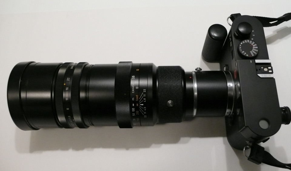

jc_braconi Posted January 1, 2013 Share #70 Posted January 1, 2013 (edited) Wilson, the one on the camera is M-M so if you want to use the 280 VsII you can use the intermediate ring OUBIO the Vs III directly on the tube M-M Edited January 1, 2013 by jc_braconi Link to post Share on other sites More sharing options...
wlaidlaw Posted January 1, 2013 Author Share #71 Posted January 1, 2013 JC, Having spent quite a lot of money in the middle of last year buying a minty S3 280, that is the lens I want to use. I will sell my S2 + OUBIO with a Muscelli adapter attached, as and when they arrive. Wilson Link to post Share on other sites More sharing options...
jc_braconi Posted January 1, 2013 Share #72 Posted January 1, 2013 IHaving a M with the live view it will looks and works like this : Welcome, dear visitor! As registered member you'd see an image here… Simply register for free here – We are always happy to welcome new members! 3 Link to post Share on other sites Simply register for free here – We are always happy to welcome new members! ' data-webShareUrl='https://www.l-camera-forum.com/topic/189144-flange-to-flange-distance-of-a-visoflex-body/?do=findComment&comment=2203066'>More sharing options...

jc_braconi Posted January 1, 2013 Share #77 Posted January 1, 2013 JC, Having spent quite a lot of money in the middle of last year buying a minty S3 280, that is the lens I want to use. I will sell my S2 + OUBIO with a Muscelli adapter attached, as and when they arrive. Wilson Wilson With the S3 you can min.focus at 3.50m the S2 is 6.00m Link to post Share on other sites More sharing options...
