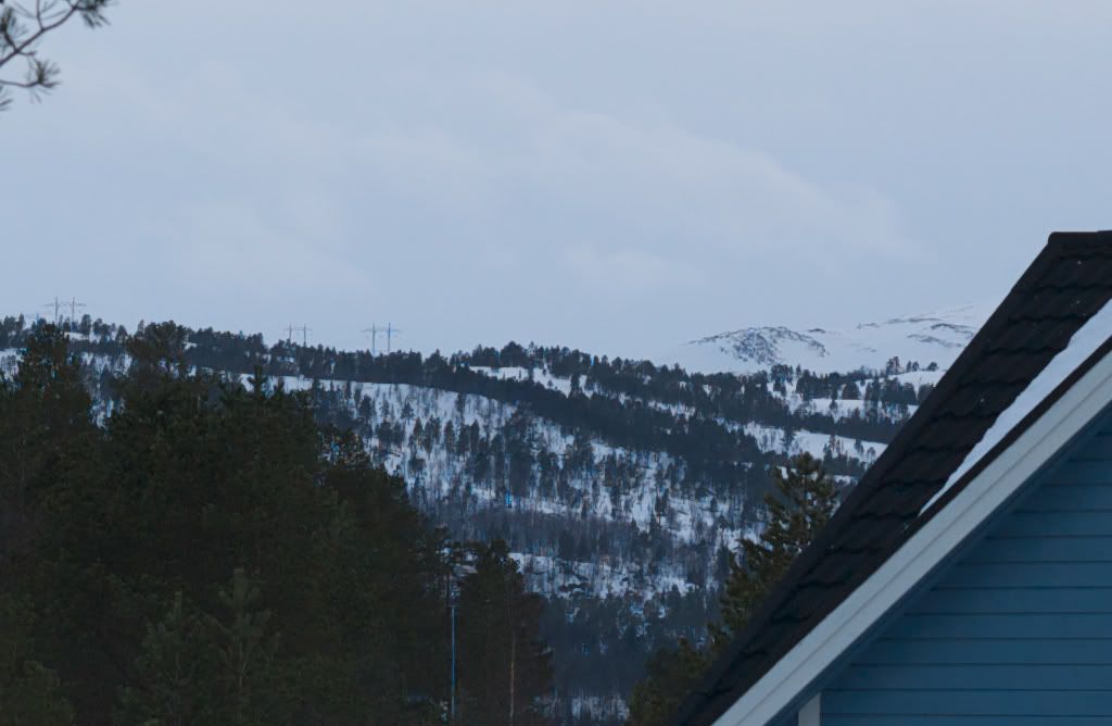

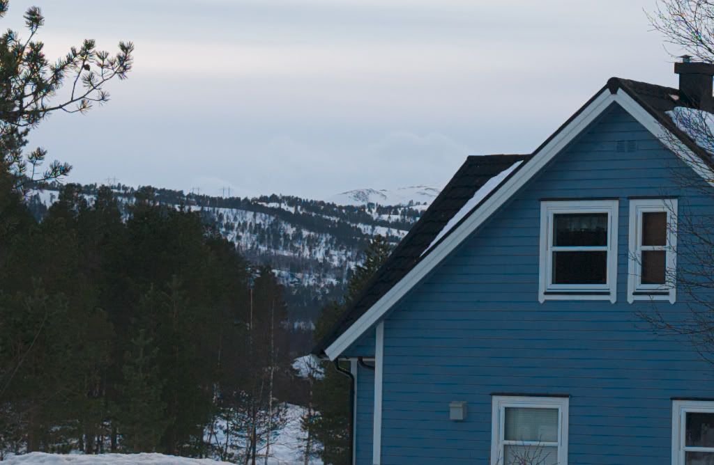

Nordvik Posted March 8, 2012 Share #1 Posted March 8, 2012 Advertisement (gone after registration) Hi, I think I have a problem with focus at infinity. 28mm ZM wide open and at 5,6: The lens is set at infinity and the rangefinder shows infinity. Focus is correct at 1m. Link to post Share on other sites More sharing options...

lct Posted March 8, 2012 Share #2 Posted March 8, 2012 Welcome to the forum Please show a 100% crop at infinity. Link to post Share on other sites More sharing options...
Nordvik Posted March 8, 2012 Author Share #3 Posted March 8, 2012 Thanks! They are 100 % crop from centre at infinity. Link to post Share on other sites More sharing options...
jaapv Posted March 9, 2012 Share #4 Posted March 9, 2012 A ZM lens often needs calibration to perform optimally on a digital M. Zeiss adjust their lenses to the more loose tolerances needed for film. Link to post Share on other sites More sharing options...
Nordvik Posted March 9, 2012 Author Share #5 Posted March 9, 2012 It looks to me like the house is in focus at 2,8 (looks the same as at 5,6) and that the mountain in the background is out of focus. Do you agree? I don't think the lens should be "soft" like this in the centre even at 2,8. Link to post Share on other sites More sharing options...
lct Posted March 9, 2012 Share #6 Posted March 9, 2012 Are you sure you've focused at infinity? If so, at f/5.6, your pic should be sharp from about 6m to infinity normally. Link to post Share on other sites More sharing options...
Nordvik Posted March 9, 2012 Author Share #7 Posted March 9, 2012 Advertisement (gone after registration) Yes, I am sure. And, yes, at 5,6 (2. pic) the background is "sharp". At 2,8 it is not sharp. Is it because the lens can not reach infinity or is it because the lens is "soft" wide open? Link to post Share on other sites More sharing options...

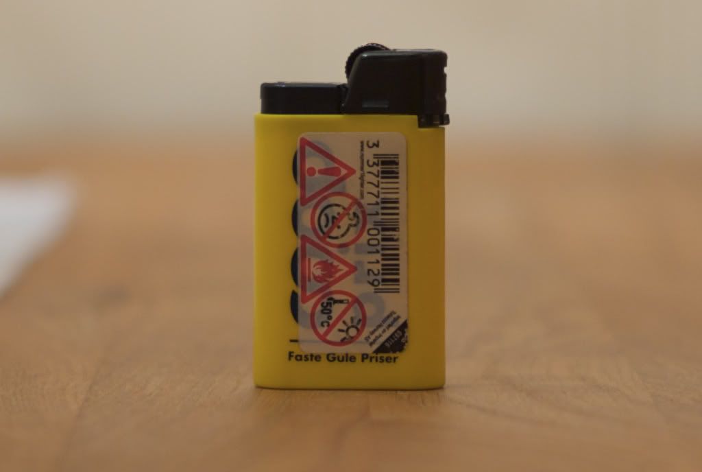

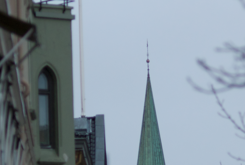

Nordvik Posted March 10, 2012 Author Share #12 Posted March 10, 2012 Today I went to the dealer and tested a 90mm Summicron. Is this what can be expected from a handheld shot wide open at 1/250 set at infinity? The distance to the church tower is maybe 400-500m. This lens focused better at 3-5 meters then my 50mm. Link to post Share on other sites More sharing options...
Nordvik Posted March 16, 2012 Author Share #13 Posted March 16, 2012 Today I took some test pictures again with the 50mm. Now at 1m using 2,0 and 5,6: It is a bit softer at 2,0 but not as much as at infinity to my eyes. I found this in a review: ZEISS 50MM F2 PLANAR ZM LENS REVIEW "As always, there are some trade-offs. Infinity focus with Zeiss 50mm F2 ZM Planar is very difficult to hit. I have tried four or five copies across four M8’s and without a doubt, infinity focus is NOT the lens’ strong suit. When the ZM is stopped down, DOF hides this shortcoming. My advice is - if shooting landscapes at or near infinity focus, stop down to F4 to F8" Should I send the lens to Zeiss? Link to post Share on other sites More sharing options...

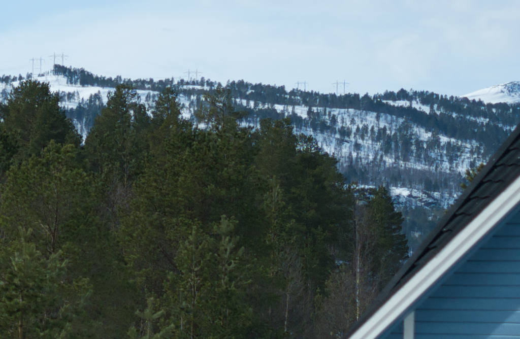

Nordvik Posted April 19, 2012 Author Share #19 Posted April 19, 2012 Hi, I got the 50mm back from Oberkochen 20m ago. Got outside and took this picture at 2,0: That is more like I expected it to perform. Very satisfied and relieved now. And very happy. This is what Zeiss wrote to me: "Service provided: Readjustment of flange focal distance and cam hight. Test for MTF and flange focal distance. Test on camera. This service is covered by warranty." Link to post Share on other sites More sharing options...
