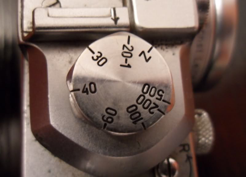

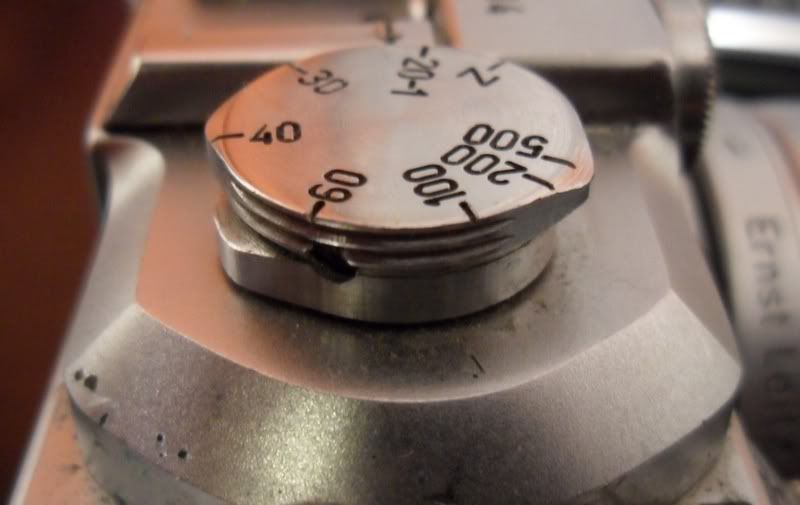

I like scewmount Leicas. I met strange shutter speed dial in Leica III.
Camera is from 1934 (by number) but on bottom plate is engraved "closed" and "open". Lens number tells it is from 1946 and is coated. After number of lens - Elmar 3.5 / 5 cm - there is asterisk "*".
I guess camera went back to factory in 1946, bottom plate was changed and lens was renovated with new number and "*". Till now everything seems to be clear for me.
But camera has strange shutter speed dial. There is one tooth on it and 3 smaller tooths upper.
Could you tell me why shutter speed dial is not typical ?
I think it can be related to flash synch but I don't know which way.
Below you can see few photos of the shutter speed dial

In the early 1950's non-synched Leica cameras could use the Vacu external synchroniser, for the CAVOO flash unit. The synchroniser was screwed on the shutter-release guard thread and fitted over the shutter dial. A synch cord went to the CAVOO. There were six different lobed dials, to fit different cameras, named CAVOO-A to CAVOO-F.
A Leica III from 1934 should take a CAVOO-A.

I have a IIIb which is equipped with this camed shutter dial to work with the Vacu (like a ruptor for dispatching to the sparks plug on an engine)
My aunt's 1948 IIIc came to me with one of the synch cams pressed on the normal shutter speed dial. Its larger diameter actually helped grasp and adjust the dial. Too bad the flash unit was gone by the time the camera came to me...

Lars, wasn't it CMVOO the specific code of the "cammed" speed dial ?
Anyway... Welcome to the forum, Planistigmat !!! You see... HERE YOU CAN FIND ANSWERS !!! :p
CMVOO seems to have been the dial supplied with the COOIF synchroniser for electronic flashes.
