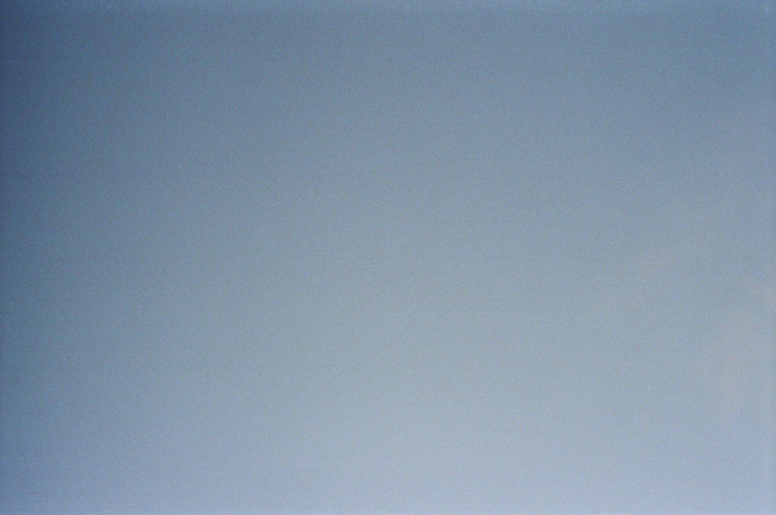

  1. Okay so, a month ago, when I had my M3 serviced (again), I wrote the following post: So the 2nd and 3rd issues (since they are owing to the same reason) I mentioned in the previous post still remains even after the service this time round. The photo I uploaded here is one of the 76 frames that I only took a bright sunny blue sky to test the performance of the shutter. (I’ve used two rolls only for this, they look practically almost the same so I only present one here). The settings were f/8 and 1/1000s (ISO 400 film), and the lens was Summicron 50 mm. We can assume that vignetting can be ruled out. You can see the left upper side of the frame is much darker than the other part of the frame. The right side of the frame is also slighted darker probably because of the same shutter issue, but it is not as severe, so let’s ignore that for now. What I wanna ask you is, if you were me, would you just ignore this shading issue and just use the camera or try your absolute best to fix this? Somewhere in RangefinderForum, I read someone saying “even at Leica, the tolerance limit for the 1/1000 shutter speed is 20% as it is prone to be out of calibration”. (Link: https://rangefinderforum.com/threads/leica-m-1-1000-uneven-shutter-issues.79230/) Also, the experiment was conducted under a very extreme conditions, so I presume in practice it won’t be as noticeable. Additionally, I’ve seen many people saying that even for newer Leica M film bodies, the 1/1000 speed tends to be an issue quite frequently. Considering all this, does this seem to be an acceptable condition that you’d use this camera after biting the bullet, or would you try your absolute best to fix this issue by trying other servicemen as many of you suggested? I’d like to see what you guys think. Thank you.
