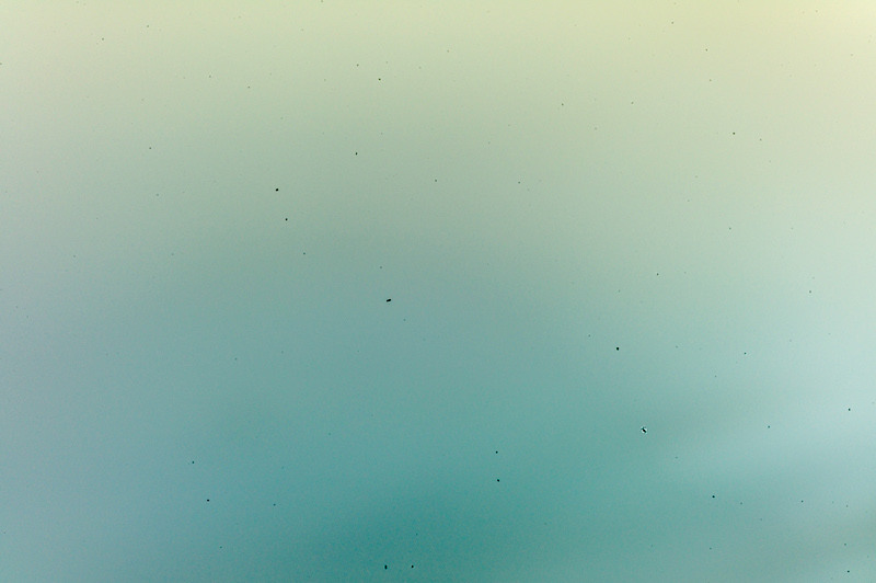

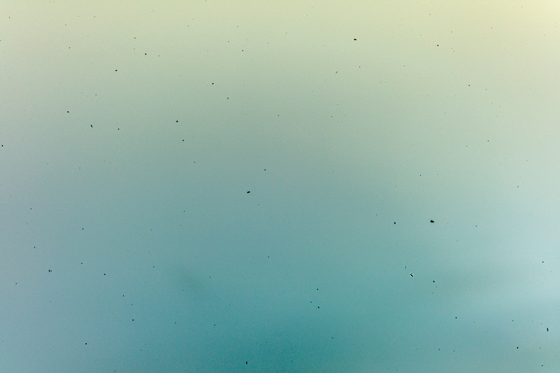

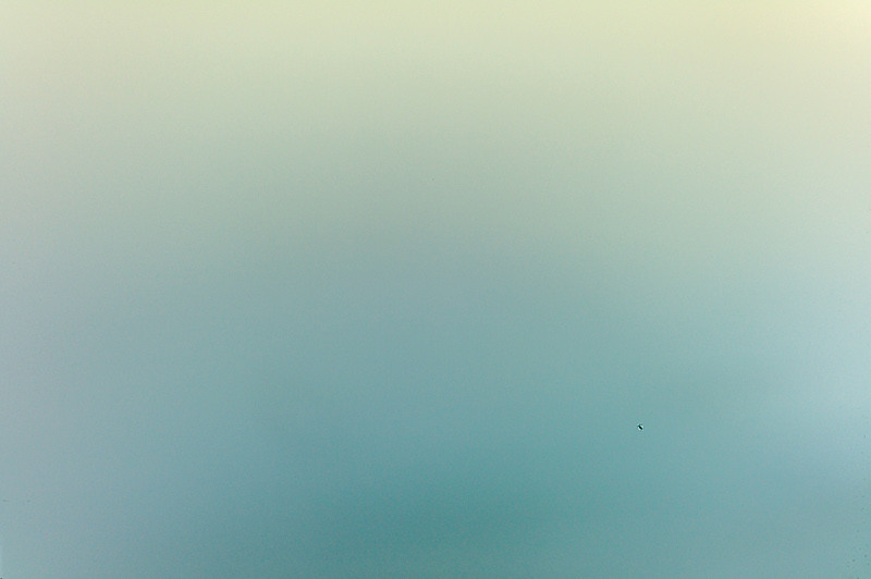

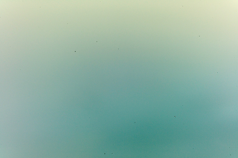

  1. Hello everyone. I'm a long-time M photographer who just joined this forum. My first M was a 6, followed by an 8, then a 9 and most recently a 10. I really love the M9 and my camera is one of the early production ones and in original condition (never repaired or had anything replaced.) I've not cleaned the sensor for about 5 years and today finally took the time to do so. The images in this post have been processed in Lightroom to add as much contrast as I could to increase the visibility of specs and dust. The small images inline in this post have had "auto levels" applied, so they are extremely compressed, greatly exaggerating the particles. Link to full-res images at end of post. I started with a reference shot against a light grey wall, summicron 50 at f16 out of focus. Pretty damn dirty: First round of cleaning was with a rocket blower. This got rid of quite a lot of minor dust particles: Second round of cleaning was with a VisibleDust Arctic Butterfly statically-charged brush, which got rid of a new "class" of particles: However there were still a few "sticky" particles left. Final round was wet cleaning with swabs of Eclipse. This is a really scary step as it's easy to make mistakes, but I managed to not screw up: There's now just a single impossible-to-get-rid-of spec (even after five Eclipse swabbings), and I can live with that one. Pretty remarkable how much cleaner the sensor is after this. Strongly recommend taking an hour out of your life to clean you sensor (very carefully) :–) Full-res images (lightly compressed and processed to increase particle visibility): https://www.dropbox.com/sh/0q9tht2js82u1zs/AAB6M-98wkRWTfmDtTke-duha?dl=0 Equipent used: Giottos AA1900 Rocket Air Blaster VisibleDust Arctic Butterfly 724 VisibleDust Quasar R 5x Sensor Loupe Photosol Sensor Swab ULTRA (24mm) Photographic Solutions Eclipse fluid
