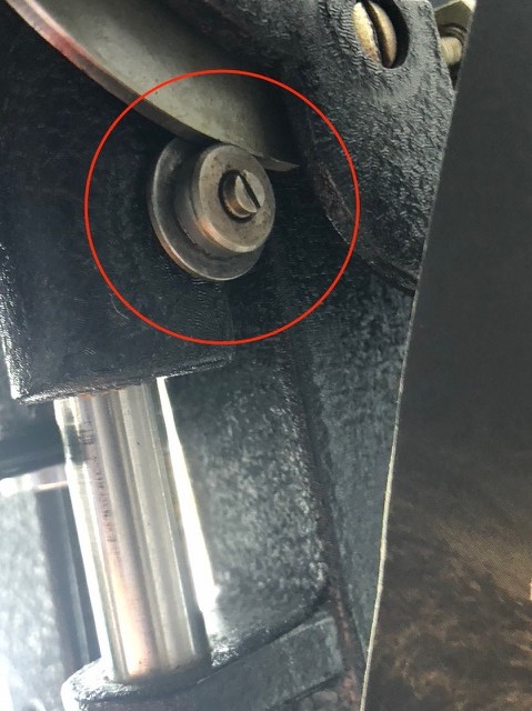

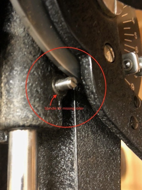

  1. I am restoring a Focomat 1c (complete with Ilford Multigrade HLZ system) and all seems fine except it is missing one small but important part. I attach a photo of the part on another 1c as well as the bare spindle/screw on mine. I donโ€™t know what it is called but Iโ€™m guessing it is a roller bearing and is roughly 10mm in diameter. It supports the curved autofocus cam and without it I need to manually focus all the time. Now I am aware that Leica stopped support for enlargers some time ago but I wonder if anyone could help: is this a standard component I could source from a roller bearing supplier or would I need to have it fabricated? Second query is does anyone know of a good lens repair place that could clean the haze from a couple of Focotars I have. Leica no longer provide this service. I'm in the UK. Thanks
