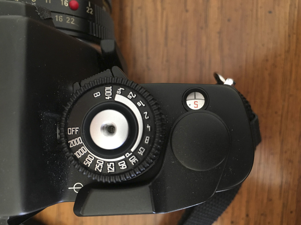

  3. Hi! I have to disassembly the top plate of my Leica R7 for cleaning contacts (selector mode not recognize all the modes as it should). The ASA dial it's not a problem but the program dial and wind advance lever are quite difficult. I've seen some Minolta's XD disassembly videos but all of them had an indentation for tools on the shutter dial. If anyone can show me or tell me how to put this 2 things apart.. (pic found in the web, only for demostration) Thank you very much. Davide
