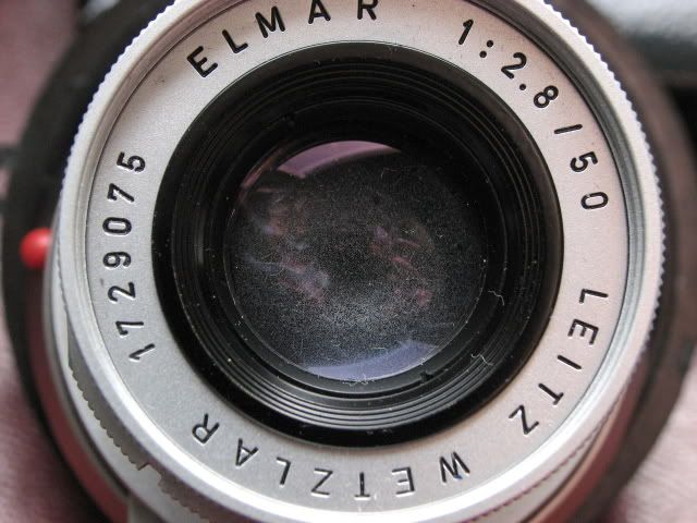

jaffercake Posted March 27, 2009 Share #1 Posted March 27, 2009 Advertisement (gone after registration) This is one of my dads lens for his leica m2. Could anyone tell if it is reparable with out costing an arm and a leg. Link to post Share on other sites More sharing options...

russell c. greenberg Posted March 27, 2009 Share #2 Posted March 27, 2009 Have you taken any pictures with this lens? Looks like fungus inside front element. Your pictures may be soft or you may have a flare problem, post some pictures (in varying conditions) shot with this lens. You might like the results, if not, send in for repair, get estimate first, then decide if it's worth repairing. Russell Link to post Share on other sites More sharing options...
Mystic Posted March 28, 2009 Share #3 Posted March 28, 2009 I'm not sure if it makes sense sending this lens to Leica. You got a pretty big fungus problem there and the chance to remove it completely(!!!) isnt big. Fungus often comes back after a while because the spores. The best thing you can do is call Leica and ask the experts about this issue. Best regards Daniel Link to post Share on other sites More sharing options...
Frase Posted March 29, 2009 Share #4 Posted March 29, 2009 Have a shot at taking it apart and cleaning it you are not going to make it any worse. Link to post Share on other sites More sharing options...
Finnkare Posted March 29, 2009 Share #5 Posted March 29, 2009 Our local repair guy said that the funguses can normally be removed and they haven't come back. So I would not throw this one into the sea. Link to post Share on other sites More sharing options...
russell c. greenberg Posted March 30, 2009 Share #6 Posted March 30, 2009 Have a shot at taking it apart and cleaning it you are not going to make it any worse. Frase, Not a good idea. 1)This lens has the diaphragm right behind the 1st element, could be damaged by a non-expert disassembling a lens. 2) You need a collimator to check proper alignment of all lens elements (4 in this lens), if he doesn't align all the elements perfectly, the fungus will be least of his problems. Leave disassembly and cleaning to certified repair people with the proper equipment at their disposal. Russell:eek: Link to post Share on other sites More sharing options...
doubice Posted March 30, 2009 Share #7 Posted March 30, 2009 Advertisement (gone after registration) Actually, it is quite simple to remove the front lens group and no re-collimating is necessary upon re-assembly. A rubber block pressed against the black ring will unscrew it. Unfortunately, the fungus is probably between the front elements and will be very difficult to remove. About a year ago John van Stelten of Focal Point still had some original front elements for this lens - may be a good idea to contact him: Welcome to Focal Point - Lens Repair, Lens Cleaning, Camera Repair Best, Jan Link to post Share on other sites More sharing options...
jaapv Posted March 30, 2009 Share #8 Posted March 30, 2009 Even if you kill off the fungus and remove it, the glass will be etched. These lenses are not expensive. Buy a good one and replace the front element (After having a professional remove all fungus spores!), as the lens clearly has emotional value. Otherwise, just replace it. Link to post Share on other sites More sharing options...
jaffercake Posted March 31, 2009 Author Share #9 Posted March 31, 2009 Thanks guys. Had a go at repairing it myself, though i could loosen the lens locking ring the outer ring would not budge. Don't know if its glued in place. I still have a 90mm 2.8 in good condition that i can test the camera with. The camera has not been used much recently, though it was serviced regularly in its day. Link to post Share on other sites More sharing options...
Guest maddoc2003jp Posted March 31, 2009 Share #10 Posted March 31, 2009 Zeiss and also Leica don't accept any lens for repair / service that is infected by fungus. While opening the lens spores can spread all over the place and contaminate other lenses or optics. See this older thread here. Link to post Share on other sites More sharing options...
ErikFive Posted March 31, 2009 Share #11 Posted March 31, 2009 Dont send it to Leica. They told me to toss it in the bin. John Van Stelten at Vocal point fixed it in two days without any damage to the lens. It was as good as new. Leica stated that it was un repairable. You couldnt even see signs of fungus unless you used a flashlight and looked for it. I dont think your lens will qualify as repairable either Link to post Share on other sites More sharing options...
Frase Posted March 31, 2009 Share #12 Posted March 31, 2009 re-collimating shouldn't be that dificult and its not like its going to be any worse than it is now, mind on the re-collimating I say it should't be dificult but my dad has been building astronomical telescopes for almost 50 years! Link to post Share on other sites More sharing options...
