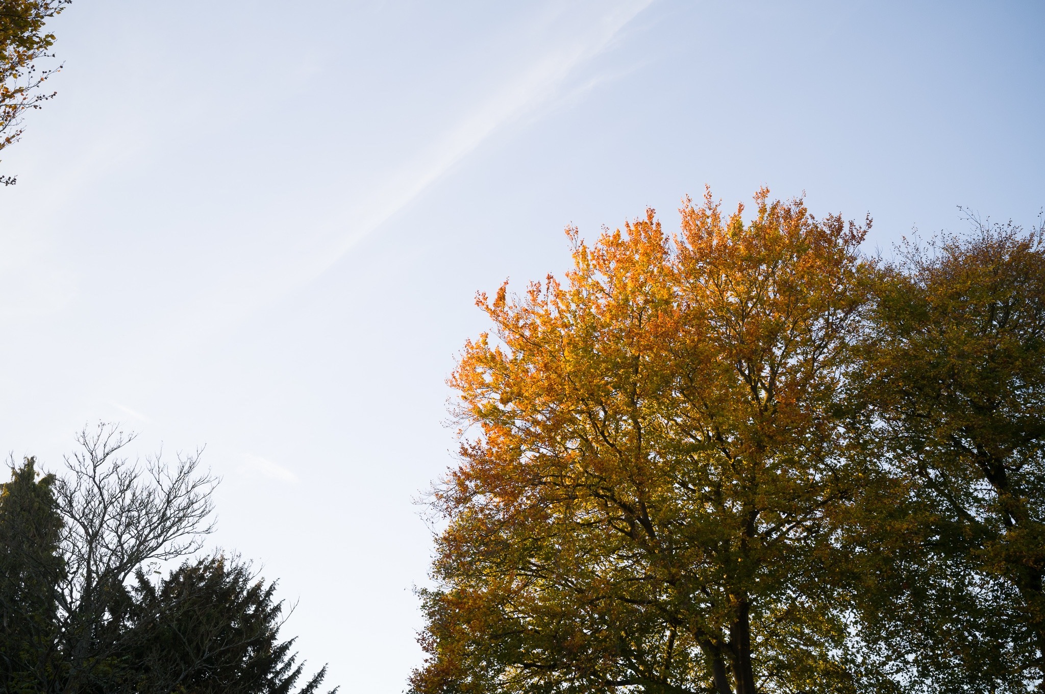

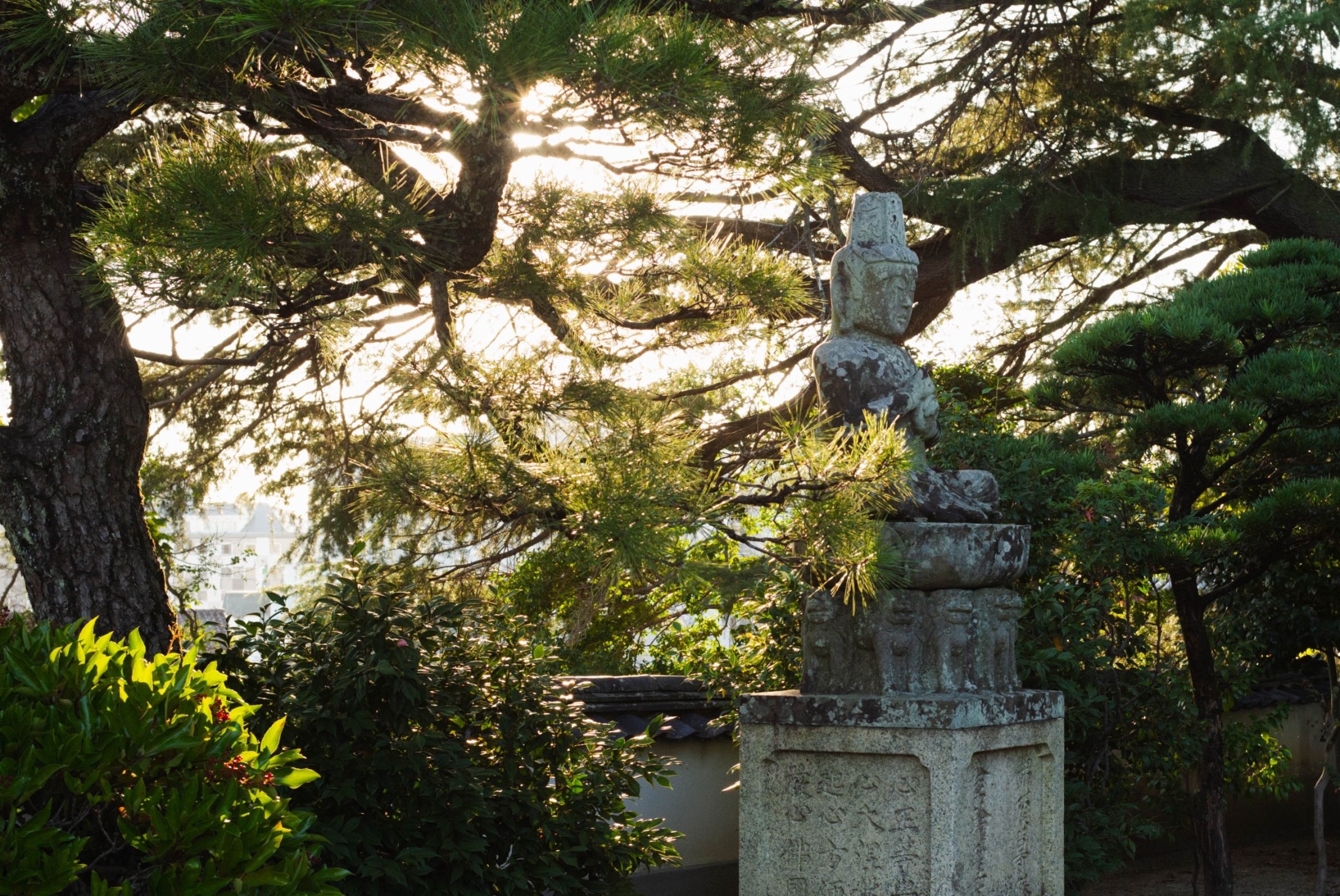

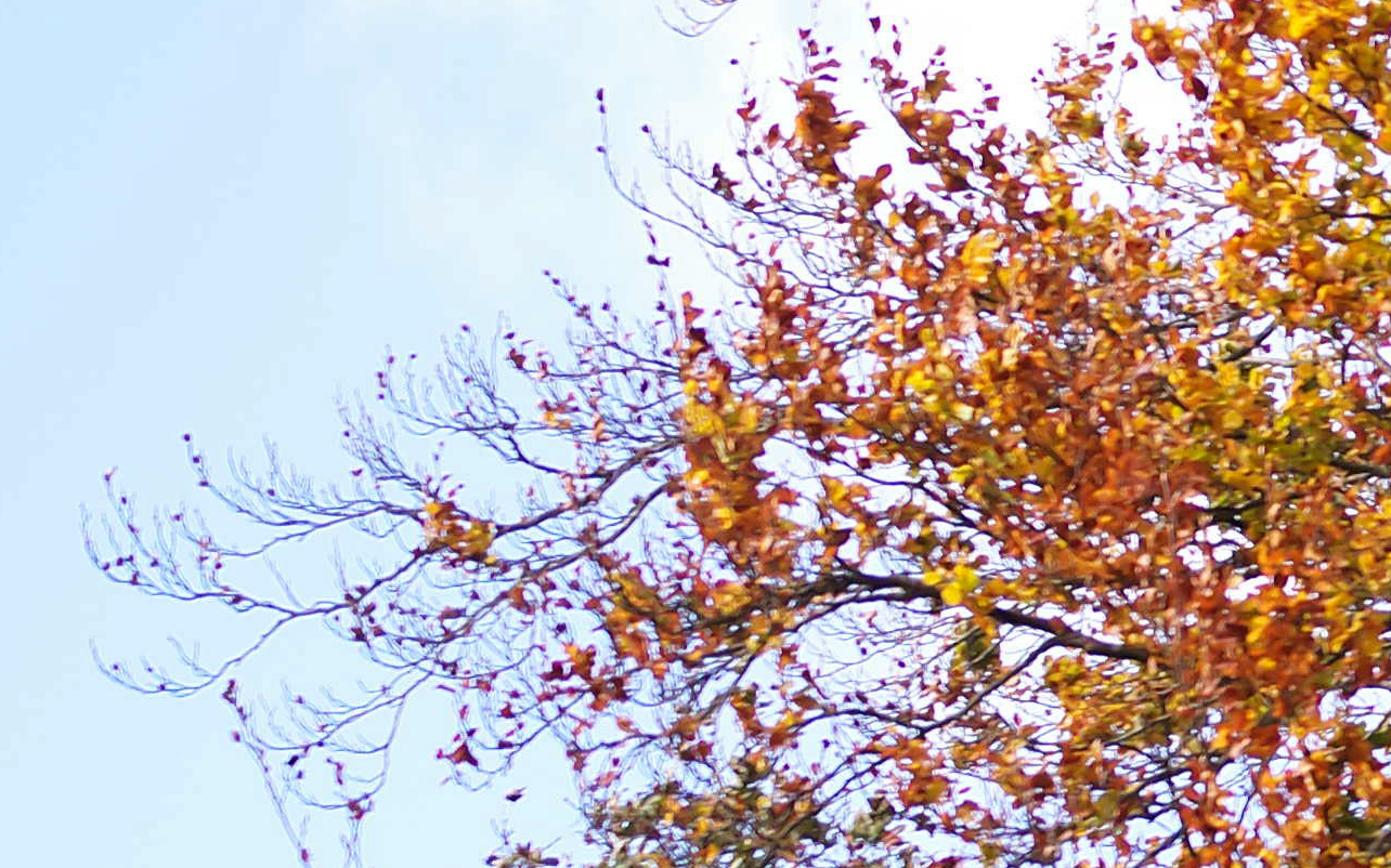

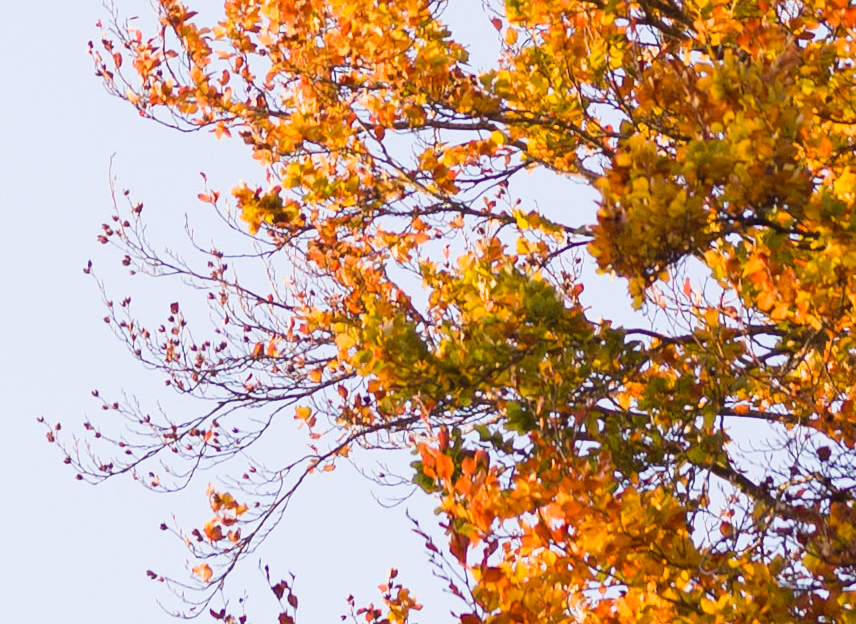

Derbyshire Man Posted 5 hours ago Share #1 Posted 5 hours ago Advertisement (gone after registration) I bought this lens in perfect used condition last week and took it out for some landscape testing. It has great resolution but in high contrast areas it on screen at lest has the attached level of chromatic aberration. Am I expecting too much? These are screen grabs from LR. I have to say it wasn't what I was expecting and makes me wonder if it's the reason the lens looks brand new! Ie sent to Leica and returned 'within specification'. Clearly two of these are contrejour but it looks no better than my Summilux 28mm wide open! Anyone else got one who can comment on this? Welcome, dear visitor! As registered member you'd see an image here… Simply register for free here – We are always happy to welcome new members! Link to post Share on other sites Simply register for free here – We are always happy to welcome new members! ' data-webShareUrl='https://www.l-camera-forum.com/topic/425010-chromatic-aberration-in-35mm-summicron-m-apo/?do=findComment&comment=5882808'>More sharing options...

Derbyshire Man Posted 5 hours ago Author Share #2 Posted 5 hours ago And this final one is at f16, the others were f4. The other odd thing is that the embedded preview has none, it's only on switching to the develop module. Welcome, dear visitor! As registered member you'd see an image here… Simply register for free here – We are always happy to welcome new members! Link to post Share on other sites Simply register for free here – We are always happy to welcome new members! ' data-webShareUrl='https://www.l-camera-forum.com/topic/425010-chromatic-aberration-in-35mm-summicron-m-apo/?do=findComment&comment=5882810'>More sharing options...
UliWer Posted 5 hours ago Share #3 Posted 5 hours ago (edited) I think the examples don‘t show chromatical aberrations but purple fringing. Both are often mixed up even though they have totally different causes: the first results from optical faults of the lens, the second from the sensor. You may find an explanation here: https://www.imatest.com/docs/sfr_chromatic/ Edited 4 hours ago by UliWer 1 Link to post Share on other sites More sharing options...
jaapv Posted 4 hours ago Share #4 Posted 4 hours ago What camera? It can occur on any sensor but high resolution sensors are more prone. Link to post Share on other sites More sharing options...
jaapv Posted 4 hours ago Share #5 Posted 4 hours ago 10 minutes ago, UliWer said: I think the examples don‘t show chromatical aberrations but purple fringing. Both are often mixed up even though they have totally different causes: the first results from optical faults of the lens, the second from the sensor. You may find an explanation here: https://www.imatest.com/docs/sfr_chromatic/ I'm sure you are right. Unfortunately these images are too small to show the final proof - lack of a yellow counterfringe. Link to post Share on other sites More sharing options...
Derbyshire Man Posted 4 hours ago Author Share #6 Posted 4 hours ago (edited) Thanks both. Attacking it with bit of purple de-fringing sorts it. Feel free to delete the topic in case it becomes some sort of slur on 35mm apo's! Edited 4 hours ago by Derbyshire Man Link to post Share on other sites More sharing options...

Derbyshire Man Posted 4 hours ago Author Share #8 Posted 4 hours ago 21 minutes ago, jaapv said: What camera? It can occur on any sensor but high resolution sensors are more prone. Just to reply with the full facts its a crop of an M11 image with the summicron m 35 apo Link to post Share on other sites More sharing options...

jaapv Posted 4 hours ago Share #11 Posted 4 hours ago Imatest is a major supplier of lens testing infrastructure, used by most photographic magazines and lens makers. One may assume that they know exactly what they are talking about. https://en.wikipedia.org/wiki/Imatest Of course the lenses would show a different amount. The fringing is dependent on the micro contrast a lens can produce and that differs by lens. The better the lens, the stronger it will be. These are not beliefs or opinions, but simple facts. If this were CA, where is the yellow counter fringe in these images? Link to post Share on other sites More sharing options...

Derbyshire Man Posted 4 hours ago Author Share #13 Posted 4 hours ago 9 minutes ago, jaapv said: Imatest is a major supplier of lens testing infrastructure, used by most photographic magazines and lens makers. One may assume that they know exactly what they are talking about. https://en.wikipedia.org/wiki/Imatest Of course the lenses would show a different amount. The fringing is dependent on the micro contrast a lens can produce and that differs by lens. The better the lens, the stronger it will be. These are not beliefs or opinions, but simple facts. If this were CA, where is the yellow counter fringe in these images? Yes and it's bilateral/circumferential reddish purple fringing, no partner colour. 1 Link to post Share on other sites More sharing options...

jaapv Posted 3 hours ago Share #16 Posted 3 hours ago 18 minutes ago, Derbyshire Man said: Yes and it's bilateral/circumferential reddish purple fringing, no partner colour. Well, final proof of Uliwer's post. 1 Link to post Share on other sites More sharing options...
