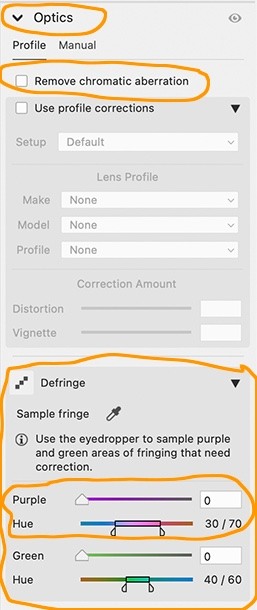

adan Posted September 25 Share #5 Posted September 25 It is unlikely to be an equipment failure. It is a natural, somewhat common, and expected effect in digital photography. So common that most digital photography post-processing software includes (at some expense to the software maker) a control exactly intended to get rid of of such color fringing. It can happen any time with any lens/camera/sensor (except the Leica Monochrom-only cameras, obviously 😉 ) This is from Adobe's Camera Raw, but most other editing programs will have a similar set of controls. Welcome, dear visitor! As registered member you'd see an image here… Simply register for free here – We are always happy to welcome new members! jaapv suggests "blooming" - I suspect color aliasing (a feature of even healthy Bayer-pattern sensors, using extra-sharp lenses) http://www.tedfelix.com/ColorAliasing/index.html ) .....and/or chromatic aberrations (no such thing as a perfect lens, even for Leicas). Localized overexposure (such as these sunlit and shiny hairs, compared to the rest of the dog's black fur) can emphasize it. 2 Link to post Share on other sites Simply register for free here – We are always happy to welcome new members! jaapv suggests "blooming" - I suspect color aliasing (a feature of even healthy Bayer-pattern sensors, using extra-sharp lenses) http://www.tedfelix.com/ColorAliasing/index.html ) .....and/or chromatic aberrations (no such thing as a perfect lens, even for Leicas). Localized overexposure (such as these sunlit and shiny hairs, compared to the rest of the dog's black fur) can emphasize it. ' data-webShareUrl='https://www.l-camera-forum.com/topic/424421-seeking-kind-advice-blue-fringing/?do=findComment&comment=5867560'>More sharing options...
jaapv Posted September 25 Share #6 Posted September 25 5 minutes ago, adan said: It is unlikely to be an equipment failure. It is a natural, somewhat common, and expected effect in digital photography. So common that most digital photography post-processing software includes (at some expense to the software maker) a control exactly intended to get rid of of such color fringing. It can happen any time with any lens/camera/sensor (except the Leica Monochrom-only cameras, obviously 😉 ) This is from Adobe's Camera Raw, but most other editing programs will have a similar set of controls. Welcome, dear visitor! As registered member you'd see an image here… Simply register for free here – We are always happy to welcome new members! jaapv suggests "blooming" - I suspect color aliasing (a feature of even healthy Bayer-pattern sensors, using extra-sharp lenses) http://www.tedfelix.com/ColorAliasing/index.html ) .....and/or chromatic aberrations (no such thing as a perfect lens, even for Leicas). Localized overexposure (such as these sunlit and shiny hairs, compared to the rest of the dog's black fur) can emphasize it. I suggested blooming because it is blue. Aliasing is more often red-green, purple fringing on its own is a high-contrast sensor effect, purple-yellow (the yellow often hard to see) fringing longitudinal chromatic aberration. Lateral chromatic aberration is red-green. take your pick, the remedy is always the same: Sliders or colour replacement brush. 1 Link to post Share on other sites More sharing options...
