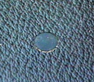

jerzy Posted July 3 Share #6 Posted July 3 (edited) vor einer Stunde schrieb ejg1890: Curious what that’s for this is rangefinder window, lever is for correcting eyesight, +- 2 dioptries? Edited July 3 by jerzy Link to post Share on other sites More sharing options...
ejg1890 Posted July 3 Author Share #7 Posted July 3 Advertisement (gone after registration) 4 minutes ago, jerzy said: this is rangefinder window, lever is for correcting eyesight, +- 2 dioptries? Thanks. Thats the only thing I could think of. Link to post Share on other sites More sharing options...
