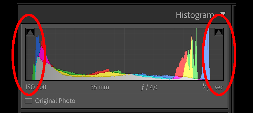

9 hours ago, evikne said:
Yes, it corresponds to what you would see on the histogram if you scanned a real film image. The "empty parts" give a matte effect, which I really like. I used a film simulation, since I don't have many scanned images, but the result is the same. Image information is cut off at both ends, but of course the profile does much more than that.
What you are describing is not wrong, but it is also not really scanning "properly". Setting a black point and white point in the scanning software allows for the full distribution of tones to mapped onto the output file. What you are doing is outputting a file whose tonal range is artificially compressed. While it is a good idea to scan flat, as you want to capture all the tones in the original, the "ideal" way to scan would be to take the whitest white in the original and have it just under clipping on the output, and have the black point just above the 0 point of the file. Then you have a true black and white and can make use of the full tonal range of the file. In the case of 8 bit black and white that is only 256 shades, so you really don't want to give up 10 or 20 on either size of the histogram if you want to have the best tonality.

Thank you for the thorough explanation. As I said, I don't have much experience with scanning real film, but this was just one example of several hundred different film simulation profiles I have. This one is from RNI, which is well regarded. So I assumed they make them typical of scanned images of these film types.
But you're probably right that it's not the lower dynamic range I like, but rather the more attenuated highlights and shadows.

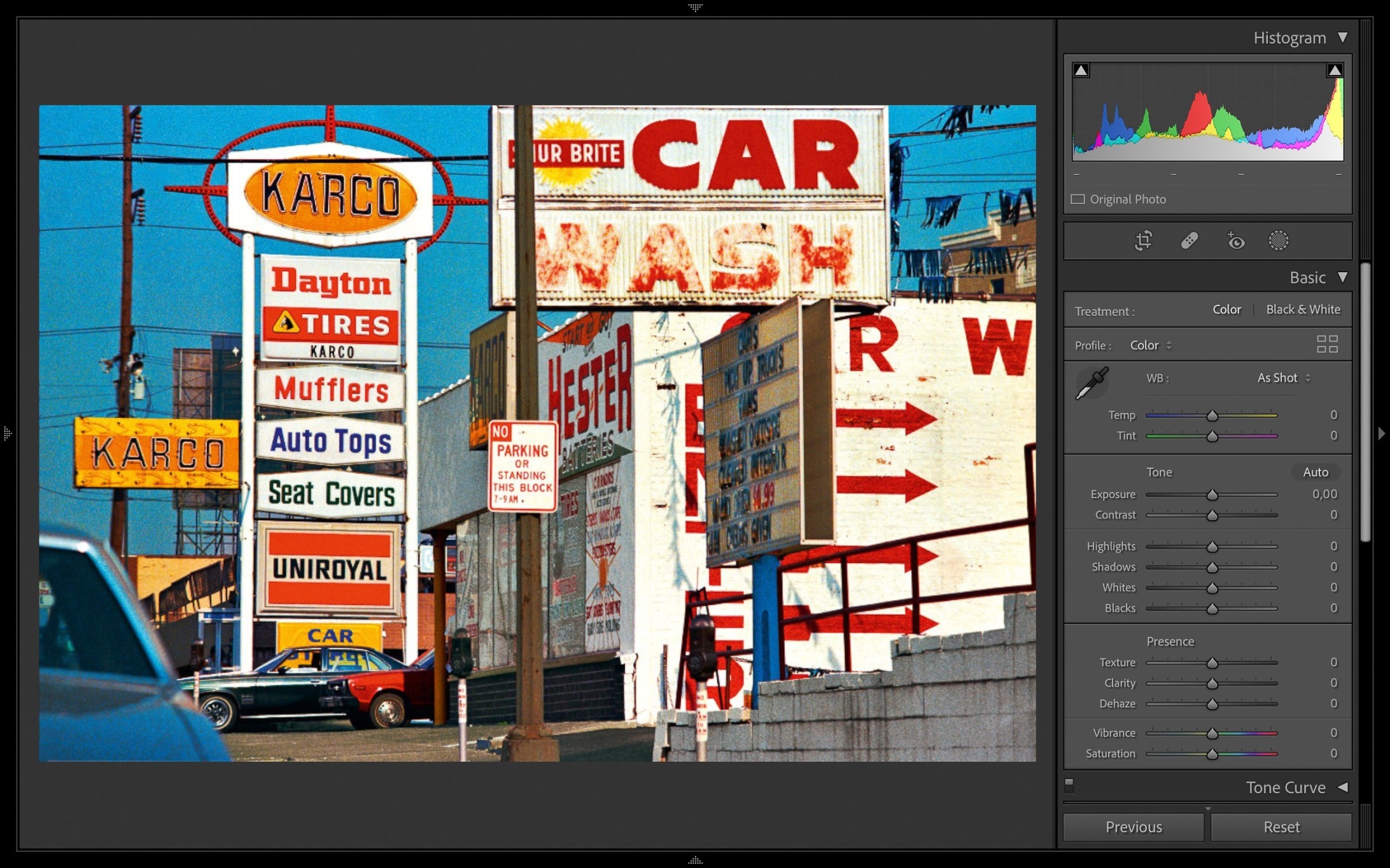

You're right. I downloaded some random images by Eggleston and checked them in LR. The histogram extends well to both sides. But it still looks like film, and it's exactly the look I love.
(I hope it's okay to post one of his pictures as an example.)
Edited by evikne
