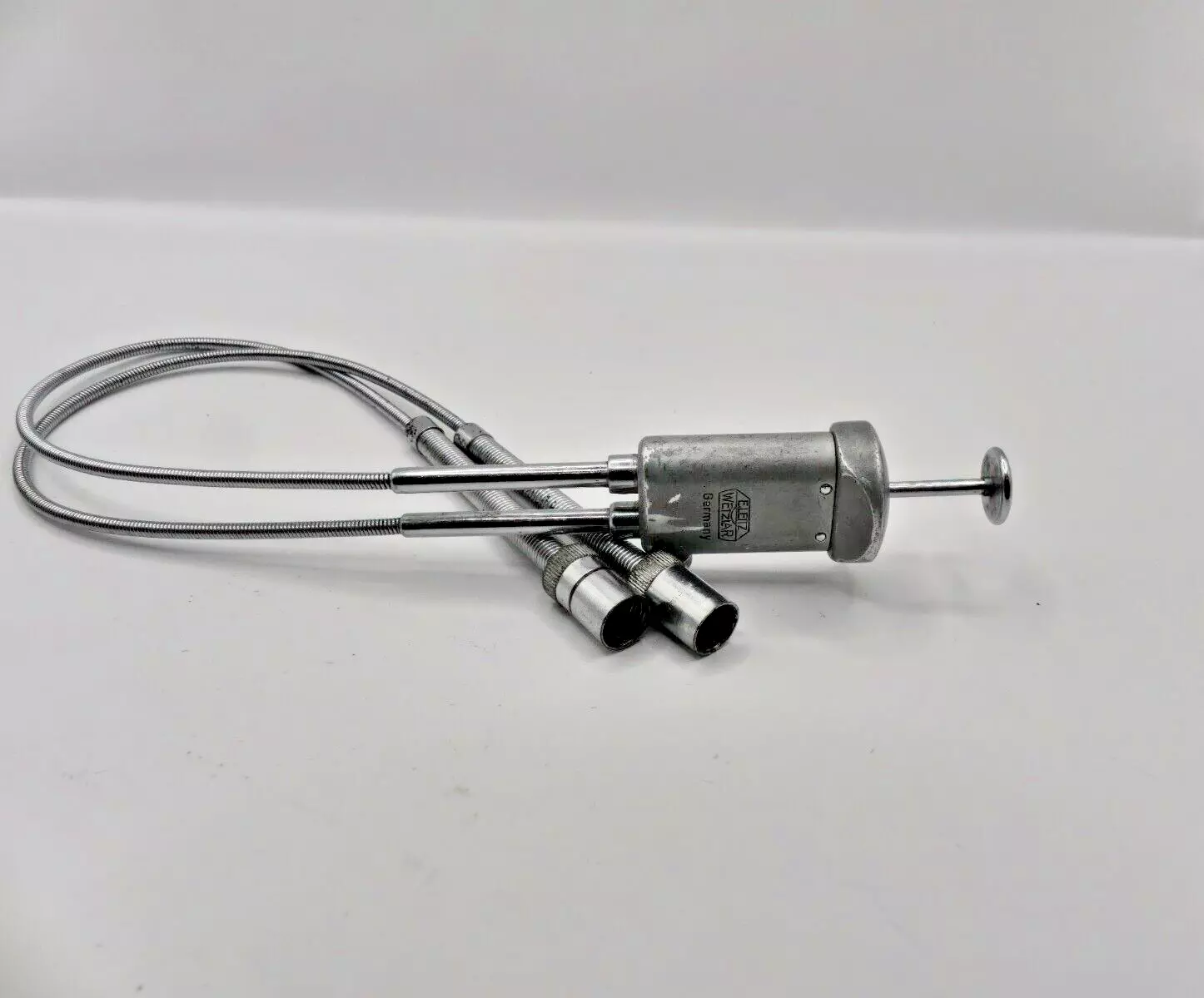

There are plenty of double cable releases with equal length cables available, what I think you need is the Nikon F/F2, Leica, Yashica, cable release adapter which screws on over the unthreaded button of Barnack Leica's, Nikon S, Nikon F etc..
This allows a normal threaded cable release to be used without unscrewing the shutter button surround of the Leica. The Nikon AR-2 is a single cable release with this adapter fitted, so at a pinch use two of those, and the Nikon double cable release the AR-8 is unfortunately different length cables and only one has the adapter fitted so that wouldn't work.

On further investigation this OZWTO should work?
But there seems to be many variations on the OZWTO theme.
vor 1 Stunde schrieb 250swb:
the Leica-double cable releases will work with the mirror boxes, so there will be a delay between the two, on of them is also marked with a black ring around the collar (afaik the one for the mirror)
Thanks, I didn’t see the black ring.
In my box of artifacts from 1940, I have two short, regular screw in cable releases.  If I understand this correctly, I can screw the Leica adapters on to each of these and then screw both onto the cameras?

A little update on my work to understand my 1940 photographer.  I purchased 2 of these cable release connectors and they attached perfectly to my two 1940 cable releases shown above in my photo and then, after unscrewing the knurled nut around the shutter on the cameras, connected perfectly and worked!
So from a photo and two artifacts, I have found cameras that perfectly fit the stereo bar and can now connect the period cable releases to the cameras.
Thanks much to everyone for their help!
Mike
You normally don't need to unscrew the shutter surround, but then the adapter and Leica's shutter surrounds may have design differences from one model to the next.
