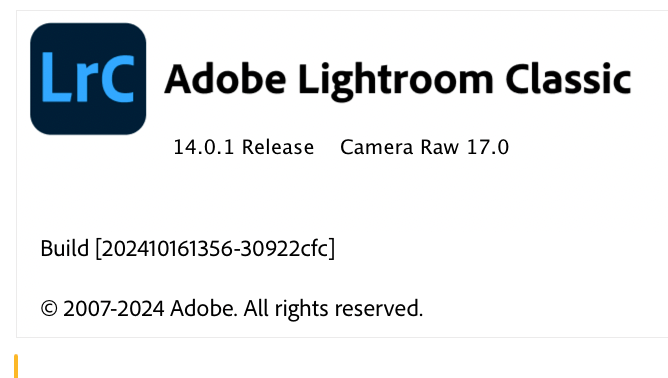

ramarren Posted November 23, 2024 Share #15 Posted November 23, 2024 Hmm. Adobe Lightroom Classic reads any file (raw, PNG, JPEG, TIFF, PSD) and promotes it internally (in memory and in the LR previews) to 16-bit per channel, ProPhoto RGB for editing. Doesn't matter whether the file is monochrome or not; 16-bit RGB and ProPhoto RGB cover the maximum image editing space possible with current imaging systems. Obviously, with a monochrome source file, all three channels are identical. If you go into the Tone Curve tool, with a Leica M10 Monochrom raw file, the editing mode is set to grayscale (all three channels simultaneously) and the Monochrom's embedded tone curve is displayed by default. You can, if you so desire, click on each of the three channels and adjust the color of the file, creating some fun special effects, and export that image file in any file type you want with any color profile you want, in either 8- or 16-bit depth (depending upon the limitations of the file type; JPEGs are always 8-bit). It's worth noting that bit-depth and color profile is applied ONLY on export ... you are ALWAYS editing in 16-bit per channel, ProPhoto RGB, and when you export a file, LR Classic does its best to make any combination of file format and color profile look as identical to what you see on the editing screen as possible. With that in mind, I did a test to see how close the results looked: I took one of my recent M10 Monochrom files with a broad lighting range from bright highlights very close to the white clipping point to deep, dark tones very close to the black point. I exported it as 16-bit TIFF, ProPhoto RGB and Adobe RGB as well as 8-bit JPEG (compression @80) Adobe RGB and sRGB. I examined the exported files, side by side, in Affinity Photo (so as to decouple as much as possible from any Adobe/LR-PS sneakiness) at 100% and 400%. The export files do show differences in the histogram curves ... however, the differences in the output images whatever differences might be there are, even at 400% display, so insignificant as to be considered non-existent. If you are interested to see the files, let me know and I'll figure a way to send you the .zip file containing all four of them. The image is this one, posted yesterday: Welcome, dear visitor! As registered member you'd see an image here… Simply register for free here – We are always happy to welcome new members! The Wall Around The Olive Grove - Santa Clara 2024 Leica M10 Monochrom + Voigtländer Heliar Classic 50mm f/1.5 VM; ISO 160 @ f/2.8 @ 1/350 sec G Link to post Share on other sites Simply register for free here – We are always happy to welcome new members! The Wall Around The Olive Grove - Santa Clara 2024 Leica M10 Monochrom + Voigtländer Heliar Classic 50mm f/1.5 VM; ISO 160 @ f/2.8 @ 1/350 sec G ' data-webShareUrl='https://www.l-camera-forum.com/topic/417353-monochrom-editing-export-and-color-space/?do=findComment&comment=5710604'>More sharing options...

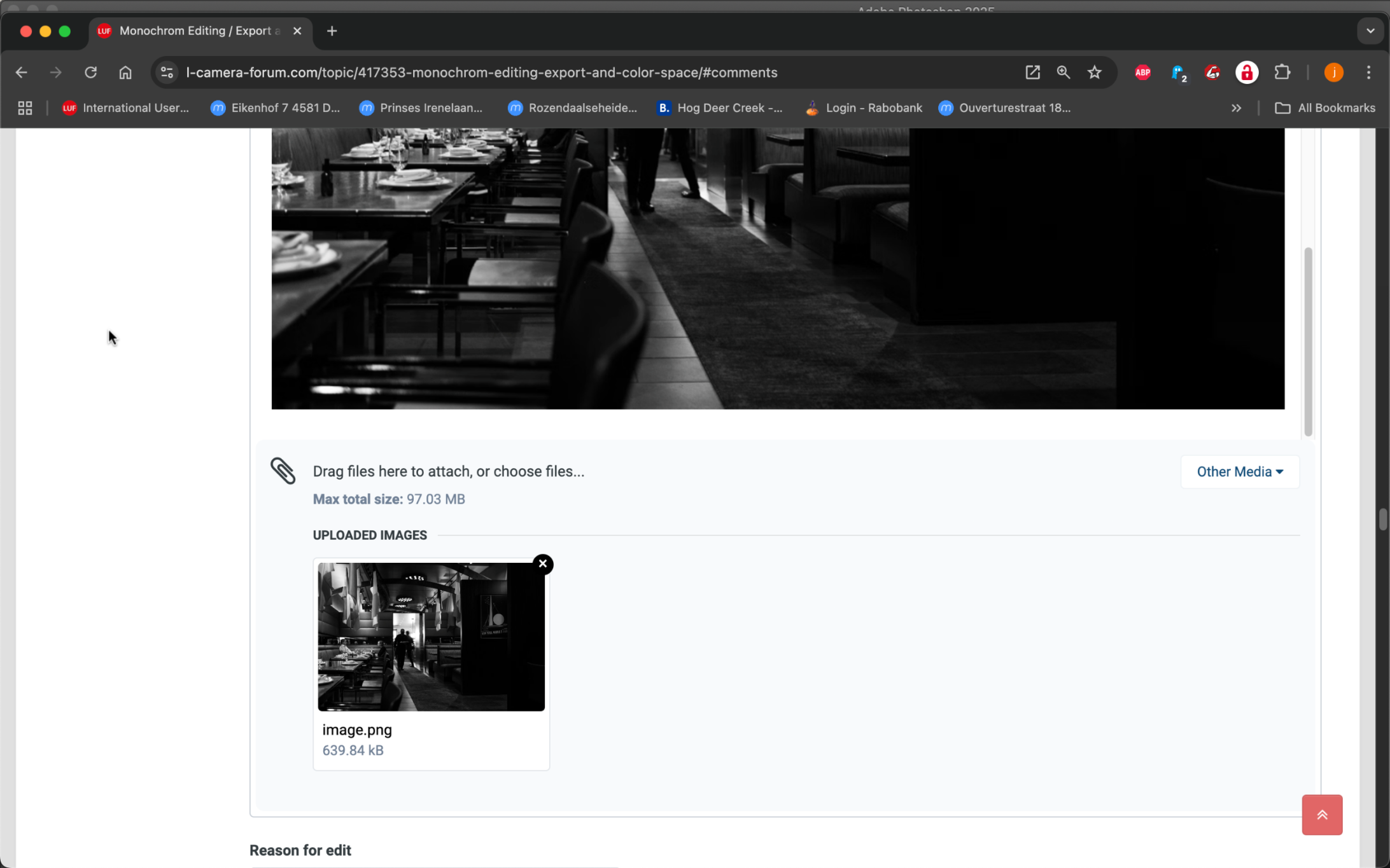

ph0toni Posted November 23, 2024 Share #17 Posted November 23, 2024 2 hours ago, ramarren said: It's worth noting that bit-depth and color profile is applied ONLY on export ... you are ALWAYS editing in 16-bit per channel, ProPhoto RGB, and when you export a file, LR Classic does its best to make any combination of file format and color profile look as identical to what you see on the editing screen as possible. Yes, of course I have been using Photoshop (version 2.5) since 1993, in 2005-2007 I tried Aperture and Lightroom... then I deleted them. As I wrote in the first post on this site LINK , I am also interested in ultraviolet photography (to emulate wet collodion) and infrared photography. Camera Raw works well for IR ... but it doesn't work at all with UV, so for 6 years I have been using Capture One to develop my Raw, then I use PH for everything else. C1 works like LR, but as I said it sees UV files much better and is very convenient with the tethering function. Link to post Share on other sites More sharing options...
