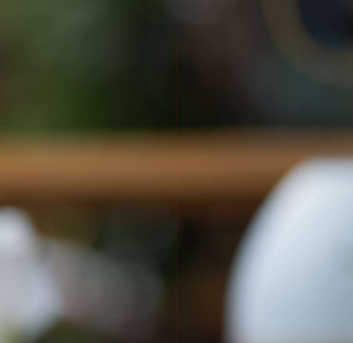

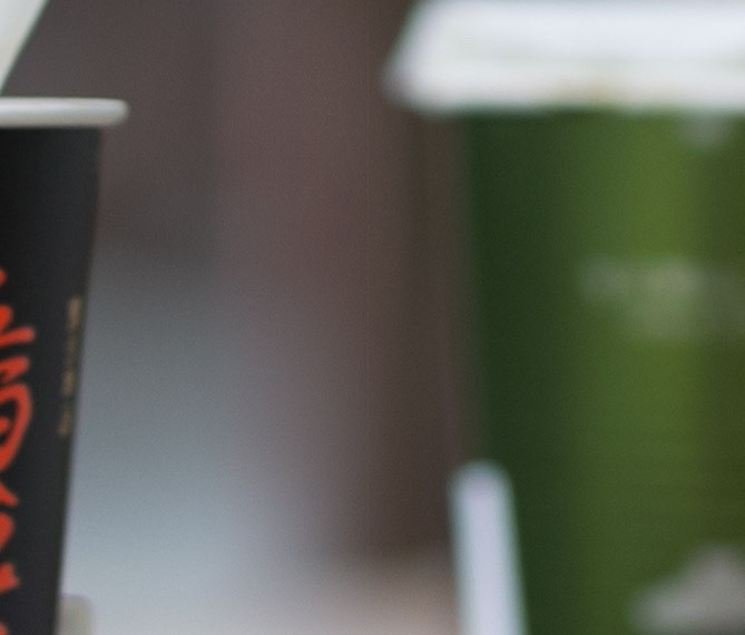

chrismuc Posted November 18, 2024 Author Share #21 Posted November 18, 2024 Advertisement (gone after registration) an update I got a second hand S006 from Leica store Beijing. The camera looks in very nice condition, no visible issues on the sensor when lifting the mirror. No effects from sensor glass corrosion visible on images up to f5.6. At f8 slight spots in even areas, from f11 more spots become visible. AF is pretty consistent well (sometimes slight shift to foreground), using the S35f2.5, S70f2.5 and S120f2.5 which I also got. The lenses are plenty sharp and low aberrations. I mostly used the 70 and 120 at open aperture or only slightly closed for street photography. Colors are great, as expected. I find the images similar to the M9 in color but slightly less contrast, which gives a bit more latitude to adjust in post, I am fine with that. But: The camera sensor unfortunately has two issues. 1. A very light one pixel wide visible line vertically in the center where the two exposed tiles from the wafer manufacturing touch. 2. A more visibly vertical line one pixel width of red hot pixels in the right half of the image. They can be removed in post with some effort. But that's not a nice outlook ... would have to be done in every single image. Question to other S2/ S2P/ S006/S-E users: Did you explore similar hot or cold pixel issues and/or visibility of the sensor tiles? Is it possible to send to Leica Germany dng files and would they be able to write a sensor pixel re-mapping and send me a particular firmware for my camera? (I sent them an email and ask for that.) Or would I have to send the camera to Leica to do that? Or no way to solve the issue? If no way or too complicated or too cost intensive, I would return the elsewhere nice camera and get ('try') another one. Two Chinese friends told me in the meantime, that they had three S CCD cameras in total because all the time one or the other had an issue ... . From what I read online, M8 and M9 had similar hot/cold pixels issues with their CCD sensors and Leica could re-map. I am aware that basically every sensor (CCD or CMOS) has a certain percentage of hot or cold pixels, very most cameras nowadays have that built-in function to carry out a re-mapping of such pixels. Unfortunately the Leica S CCD cameras don't have that function (does the S007 air S3 have it?) Enclosed 100% crops of the two lines. Welcome, dear visitor! As registered member you'd see an image here… Simply register for free here – We are always happy to welcome new members! Link to post Share on other sites Simply register for free here – We are always happy to welcome new members! ' data-webShareUrl='https://www.l-camera-forum.com/topic/416230-leica-s006-sensor-corrosion-question/?do=findComment&comment=5702566'>More sharing options...

helged Posted November 18, 2024 Share #25 Posted November 18, 2024 4 hours ago, chrismuc said: an update I got a second hand S006 from Leica store Beijing. The camera looks in very nice condition, no visible issues on the sensor when lifting the mirror. No effects from sensor glass corrosion visible on images up to f5.6. At f8 slight spots in even areas, from f11 more spots become visible. AF is pretty consistent well (sometimes slight shift to foreground), using the S35f2.5, S70f2.5 and S120f2.5 which I also got. The lenses are plenty sharp and low aberrations. I mostly used the 70 and 120 at open aperture or only slightly closed for street photography. Colors are great, as expected. I find the images similar to the M9 in color but slightly less contrast, which gives a bit more latitude to adjust in post, I am fine with that. But: The camera sensor unfortunately has two issues. 1. A very light one pixel wide visible line vertically in the center where the two exposed tiles from the wafer manufacturing touch. 2. A more visibly vertical line one pixel width of red hot pixels in the right half of the image. They can be removed in post with some effort. But that's not a nice outlook ... would have to be done in every single image. Question to other S2/ S2P/ S006/S-E users: Did you explore similar hot or cold pixel issues and/or visibility of the sensor tiles? Is it possible to send to Leica Germany dng files and would they be able to write a sensor pixel re-mapping and send me a particular firmware for my camera? (I sent them an email and ask for that.) Or would I have to send the camera to Leica to do that? Or no way to solve the issue? If no way or too complicated or too cost intensive, I would return the elsewhere nice camera and get ('try') another one. Two Chinese friends told me in the meantime, that they had three S CCD cameras in total because all the time one or the other had an issue ... . From what I read online, M8 and M9 had similar hot/cold pixels issues with their CCD sensors and Leica could re-map. I am aware that basically every sensor (CCD or CMOS) has a certain percentage of hot or cold pixels, very most cameras nowadays have that built-in function to carry out a re-mapping of such pixels. Unfortunately the Leica S CCD cameras don't have that function (does the S007 air S3 have it?) Enclosed 100% crops of the two lines. Welcome, dear visitor! As registered member you'd see an image here… Simply register for free here – We are always happy to welcome new members! Love the images! Re your question regarding hot pixel removal as menu option on S007 and S3: No such option (but SL2 and SL3 have it). Back to 006: Some hot/dead pixels are not uncommon. But lines of dead pixels should not be seen, possibly except for one line when shadows are heaviky lufted, presumably where two wafels are stitched together. I saw such a veetical line (by chance) on S006 after lifting shadows in long exposure images by many stops in Lightroom. I was concerned, but a second 006 body showed the same line in the same position under the same conditions, so I guess this is how it is... But you should not see lines of dead pixels in 'ordinary' exposed and not overly adjusted images in post. Link to post Share on other sites More sharing options...
Tirpitz666 Posted November 18, 2024 Share #26 Posted November 18, 2024 (edited) Hi, very nice street pics indeed. and color are pretty amazing as expected. Sorry to hear about those sensor issues, the middle line is likely something unavoidable, if the sensor is designed like that and hopefully will pop up only in extreme exposure scenarios, the other line is unfortunate and honestly a Leica Store should have at least declare it before selling the camera. At least in "normal" shots, none of those is visible at normal magnifications.. Edited November 18, 2024 by Tirpitz666 Link to post Share on other sites More sharing options...
chrismuc Posted November 19, 2024 Author Share #27 Posted November 19, 2024 Advertisement (gone after registration) I asked Leica Germany if they can do a pixel remapping for the sensor. My understanding was, that Leica is offering this in particular for Leica cameras with CCD sensors like M8, M9, S2/ S2P/ S006/ S-E. Their reply: "The probability to accidentally destroy the sensor by applying a pixelmapping is very high, so we don't offer it. We only offer an upgrade to S007." Sorry what nonsense is that? Pixelmapping is applied by software after the image is read out of the sensor. It does not affect the sensor (hardware) at all. (correct me if I am wrong)s Anyhow, can't expect any support from the home base in that matter. Also, seems no software from some smart hacker available out there. Like pixelfixer.org, but seems he's stopped in 2015 further developing his program, and at that time no S CCD camera dng support. Link to post Share on other sites More sharing options...
Tirpitz666 Posted November 19, 2024 Share #28 Posted November 19, 2024 Hi, nonsense indeed, but at the end, if you are happy with the camera and how much you paid for it, I'd keep it at the end, since those defects are basically invisible in normal shots. Maybe you can just ask the shop for a discount for not returning it, taking into account that if you want to resell it in the future, a prospective buyer could do the same to you. Link to post Share on other sites More sharing options...
Stuart Richardson Posted November 19, 2024 Share #29 Posted November 19, 2024 (edited) That is a strange response. I would encourage you to try to talk to another person there, if possible, to confirm. Or talk to one of the Leica country agencies like Leica USA. I had this on my DMR when I first bought it and they fixed it. Also on the M9 at one point. Again, fixed, no problem. I thought that they had fixed this issue with the automatic dark frame that Leicas tend to do. I think it is once a month or so that the cameras automatically take a dark frame (you can hear it take a picture when the camera is turned off) and it will use that dark frame to subtract any artifacts. You can try to advance the calendar in the camera a few months and see if it will do a dark frame. I can't remember if the S does this. It is my understanding that this is caused by one pixel or pixel amp being broken, which causess a cascade effect down the line of pixels in the same column. As far as I understood, the solution is to turn off that one pixel and map it to the surrounding pixels. So the solution may indeed be pre-software, but either way, I found that Leica did it for me at least twice, never mentioning any difficulty or risk. Edited November 19, 2024 by Stuart Richardson Link to post Share on other sites More sharing options...
davidmknoble Posted November 23, 2024 Share #30 Posted November 23, 2024 (edited) On 11/18/2024 at 1:37 AM, helged said: your question regarding hot pixel removal as menu option on S007 and S3: No such option (but SL2 and SL3 have it) My recollection is that you can send a DNG to Leica and they can return a patch or firmware fix that negates the hot pixels. I know I have had that for an M camera. Assume the same for the S? Anyone know for sure? Too quick on the post! I see the response now and it sounds like they said ‘no’ to the S006. I do think the M camera that I had it done for was CMOS (M-D 262). Edited November 23, 2024 by davidmknoble 1 Link to post Share on other sites More sharing options...
