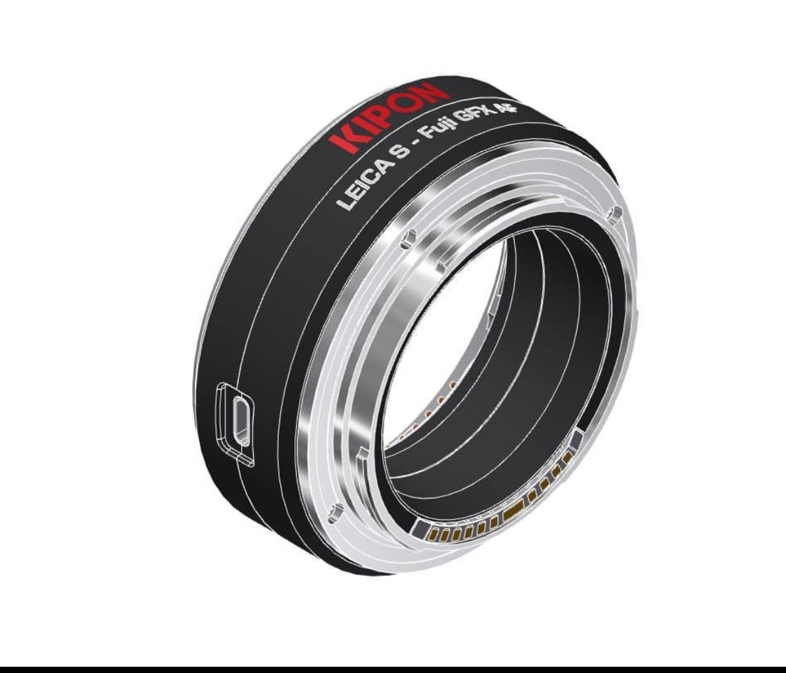

Einst_Stein Posted October 16, 2024 Author Share #21 Posted October 16, 2024 (edited) Advertisement (gone after registration) 1 hour ago, Stuart Richardson said: I hope they have the AF speed modulated properly, as it would suck if the adapter killed the AF motors in the S lenses (particularly unmodified ones). It is my understanding that the S adapter L only provides AF with S lenses on SL bodies because they are concerned about third parties causing problems. For example, if Panasonic were to crank up the AF speed on their bodies, that might increase the rate of failure of the lenses, which of course would be a service headache for Leica when they have almost zero service capacity remaining. To be safe, never use third party AF lens adapter. I.e. , the adapter without the authorization of both the lens and the camera. Adapter through unauthorized reverse engineering is no no. If you like adventure, then at least check the power system to make sure at least, they have the same voltage. Secondly, check loading of the lens (components) with respect to the camera’s driver algorithm, make sure it would not over drive. Edited October 16, 2024 by Einst_Stein Link to post Share on other sites More sharing options...

ZHNL Posted October 17, 2024 Share #22 Posted October 17, 2024 This is a very big deal. I only need aperture control. AF on S is super slow anyway. I bought and sold GFX100Ii, menu is a disaster if you want to mix and match OEM and manual lenses, but if I use it for S only, I can tailor the camera just for S, then I don’t need touch menu and UI. S glass is really the best with generous sensor coverage. This is one of the biggest reason I love them. 1 Link to post Share on other sites More sharing options...
Einst_Stein Posted October 17, 2024 Author Share #23 Posted October 17, 2024 (edited) Be aware that GFX power system is 10.8v while Leica S is 7.3v. Even if you do not use AF, once they are connected, somewhere needs to regulate the voltage, otherwise, the Leica S side will experience over drive. Check the adapter, see if it has proper voltage regulator. I have used Contax 645 to GFX adapter. It burnt the first connected Contax 645 lens. That drove me to bite the bullet to get Leica S. Both adapter and GFX are returned immediately. Edited October 17, 2024 by Einst_Stein Link to post Share on other sites More sharing options...

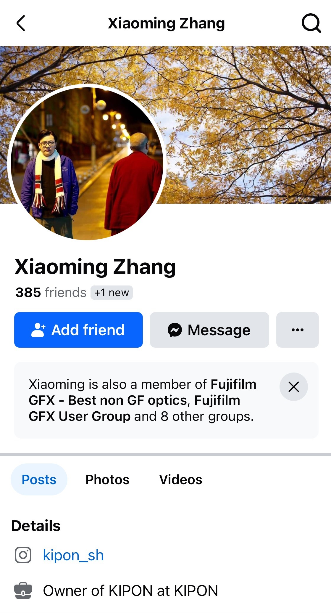

Sarnian Posted October 17, 2024 Share #24 Posted October 17, 2024 All valid points. Thank you. The person who told me about the adapter is as pictured. Whether his details are true or not I just don't know. I've asked him about the voltage of the adapter. I'll report back if he replies. Welcome, dear visitor! As registered member you'd see an image here… Simply register for free here – We are always happy to welcome new members! 1 1 Link to post Share on other sites Simply register for free here – We are always happy to welcome new members! ' data-webShareUrl='https://www.l-camera-forum.com/topic/413669-s-format-54x36mm/?do=findComment&comment=5660319'>More sharing options...
Einst_Stein Posted October 17, 2024 Author Share #25 Posted October 17, 2024 (edited) 25 minutes ago, Sarnian said: All valid points. Thank you. The person who told me about the adapter is as pictured. Whether his details are true or not I just don't know. I've asked him about the voltage of the adapter. I'll report back if he replies. Welcome, dear visitor! As registered member you'd see an image here… Simply register for free here – We are always happy to welcome new members! Since you know him well, just ask him about the voltage matching details, better yet, publish the official specs. It would help many people interested in this route. DC Voltage business is only the first step, to fully validate his adapter, we also need to know how he dealt with the loading variations of different lenses, bow to avoid over drive in the AC sense. Edited October 17, 2024 by Einst_Stein Link to post Share on other sites More sharing options...
Sarnian Posted October 17, 2024 Share #26 Posted October 17, 2024 16 minutes ago, Einst_Stein said: Since you know him well, just ask him about the voltage matching details, better yet, publish the official specs. It would help many people interested in this route. DC Voltage business is only the first step, to fully validate his adapter, we also need to know how he dealt with the loading variations of different lenses, bow to avoid over drive in the AC sense. If he replies to my question about the voltage of the adapter I'll ask further questions. I did offer to beta test an adapter for him! (I wouldn't test it on my 30-90mm but on my 70mm CS) Link to post Share on other sites More sharing options...

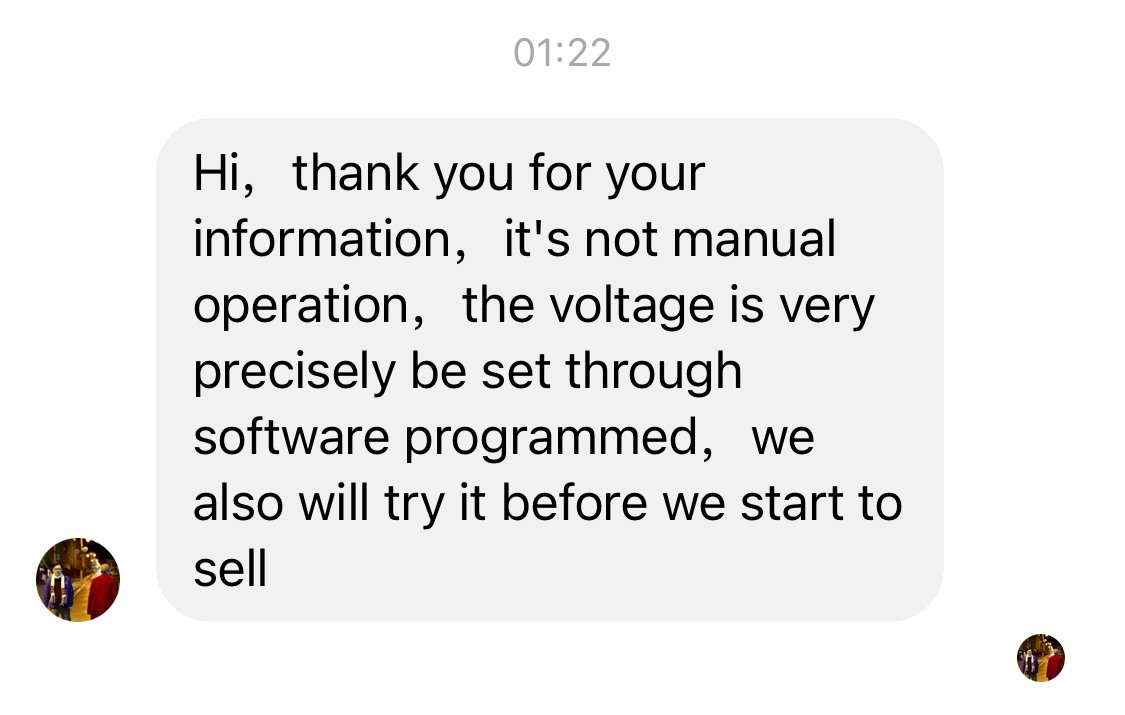

Sarnian Posted October 18, 2024 Share #27 Posted October 18, 2024 (edited) Advertisement (gone after registration) Pictured is the response that I got. Any further questions (bearing in mind that English isn't his first language so nothing too 'wordy')? I'd like to know of there will be a AF/MF switch so that the user can decide whether to use it purely to change the aperture. I've pre-set my 30-90mm to f11 and use it on a dumb adapter, but it would be nice to not have to go through that process just to change the aperture. Welcome, dear visitor! As registered member you'd see an image here… Simply register for free here – We are always happy to welcome new members! Edited October 18, 2024 by Sarnian 1 Link to post Share on other sites Simply register for free here – We are always happy to welcome new members! ' data-webShareUrl='https://www.l-camera-forum.com/topic/413669-s-format-54x36mm/?do=findComment&comment=5660619'>More sharing options...
Einst_Stein Posted October 18, 2024 Author Share #28 Posted October 18, 2024 In cases like this, rich user’s or firmware programmability sounds like lack of confidence. But it is good to let him understand the problems and complexity. For other lenses, such as contex 645 or Hasselblad h, people might reverse engineering Leica S adapter, but that cannot cover the algorithms built in the camera. Besides, what works for contex lens not necessary for Leica S. Glad someone willing to step in to make things like this. Wish him good luck and success. Link to post Share on other sites More sharing options...

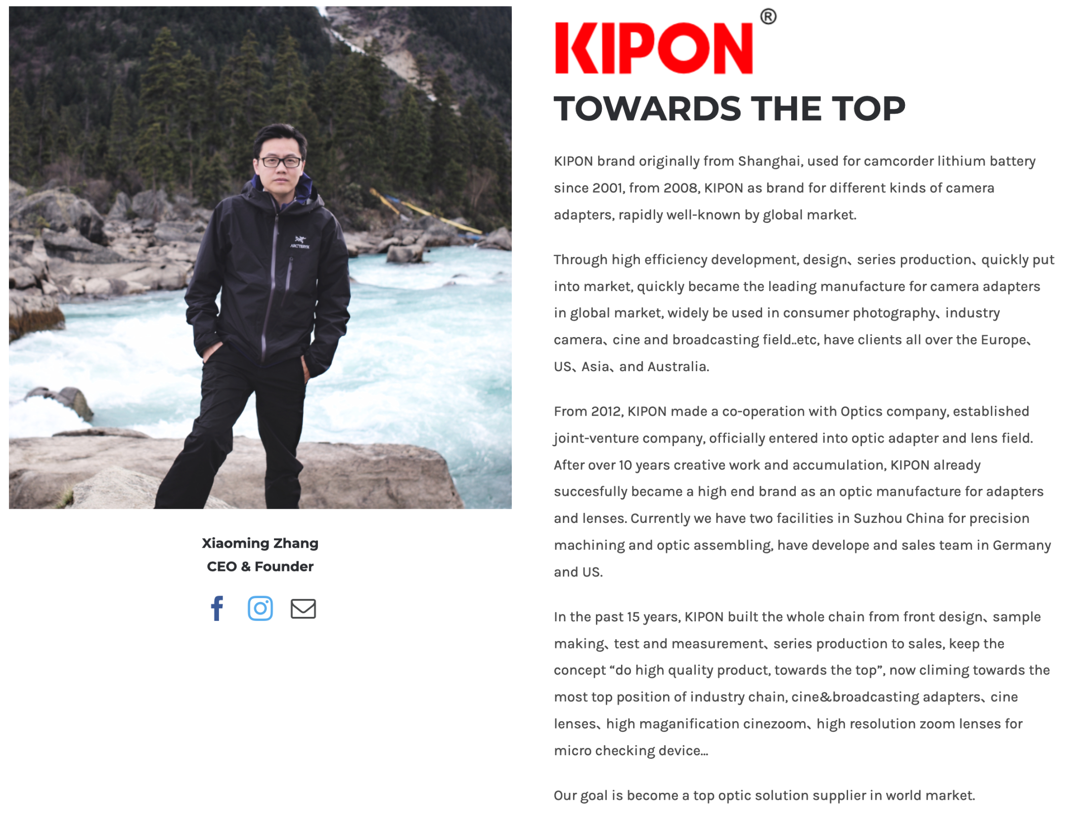

Sarnian Posted October 18, 2024 Share #32 Posted October 18, 2024 2 hours ago, Tirpitz666 said: Are we sure it's not all a fake? There is nothing on Google about it, not even a rumor, I think that if it's due for release in November, Kipon would have heavily announced it (or at least done some "targeted leaks") in order to create some real traction/expectation. The only place I've actually read about it is here, so let's hope it's really legit, for now I remain skeptical.. I'll ask him if he's fake. 😶 I guess all rumours have to start somewhere..! 1 Link to post Share on other sites More sharing options...
Einst_Stein Posted October 18, 2024 Author Share #33 Posted October 18, 2024 I found over 2K mount adapter on B&H web site. Kipon alone has over 400. As far as I can remember, not many of them has been announced, may be none. But if Leica or Fujifilm is going to offer such things, I am sure there will be announcement, and perhaps starts with "rumor". Link to post Share on other sites More sharing options...
Sarnian Posted October 19, 2024 Share #34 Posted October 19, 2024 On 10/18/2024 at 7:56 AM, Sarnian said: I'd like to know of there will be a AF/MF switch so that the user can decide whether to use it purely to change the aperture. I've pre-set my 30-90mm to f11 and use it on a dumb adapter, but it would be nice to not have to go through that process just to change the aperture. His reply: "normally we have a button to shift from AF to MF" Link to post Share on other sites More sharing options...
Stuart Richardson Posted October 19, 2024 Share #35 Posted October 19, 2024 If the guy is the head of Kipon, he probably knows more about adapters than anyone here, so I am inclined to hear him out, haha. One hopes that their engineering team is aware of the potential issues, but of course I would not want to be the one to test it with my favorite S lens. I am inclined to agree with ZHNL that having aperture actuation is enough. Just being able to have metering info transmitted and the lens aperture electronically controlled would be a huge win. I might even consider getting a used GFX to use with my S lenses. 2 Link to post Share on other sites More sharing options...
