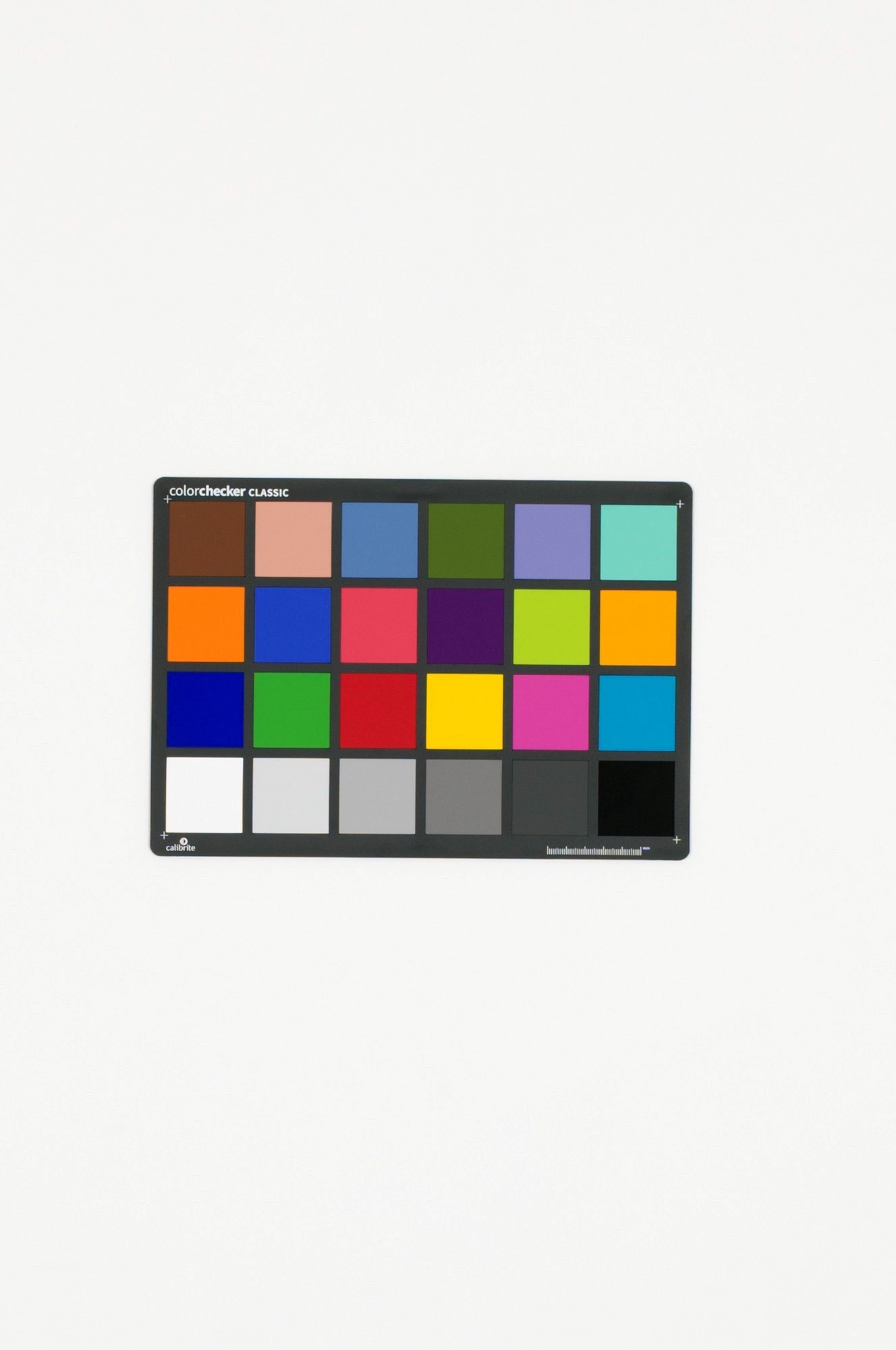

CDodkin Posted November 26, 2024 Share #81 Posted November 26, 2024 Advertisement (gone after registration) 4 Step Process using X-Rite Color Passport and a Color Spyder 1. Capture a ref Image: Proper Lighting: Shoot the ColorChecker Passport under the lighting conditions you'll be shooting your photos in. Camera Settings: Use a tripod to ensure sharp focus. Shoot in RAW (DNG) format to capture the most image data on your M11. Exposure: Aim for a neutral exposure. Over or underexposure can negatively impact the profile. Use your hand-held meter to meter the correct exposure. 2. Use X-Rite ColorChecker Passport Software: Install: Install the X-Rite ColorChecker Passport software on your computer. Launch the software. Import the M11 DNG: Drag and drop the M11 DNG file of your ColorChecker Passport image into the software. Create Profile: Click the "Create Profile" button. The software will analyze the image and generate a custom DNG profile. For C1 you'll need to save as a custom ICC profile, as C1 does not use DNG profiles. 3. Apply the Profile: Adobe Lightroom: Go to the "Camera Calibration" panel. Select the newly created profile from the "Profile" dropdown menu. Adobe Photoshop: Open the image in Camera Raw. Go to the "Camera Calibration" panel. Select the newly created profile from the "Profile" dropdown menu. CaptureOne: I believe you're using C1 - follow the instructions in this video to import the custom ICC profile into C1. Using a custom profile for your lighting+lens+camera will ensure accurate color, and consistent color - when ever you process art images using the same lighting+lens+camera. 4. Monitor Calibration: You will 100% need to calibrate your monitor in order to accurately see the color and contrast in your images - use a spyder tool to calibrate your monitor, and aim to update that calibration on a regular basis. Take note of ambient lighting in the room where you process your images, and follow the X-rite instructions to avoid ambient light from effecting your perceived color on you calibrated monitor. FWIW - using the row of 'gray scale' patches on the passport's chart to set WB will get you wildly varying results - that's not the recommended target for accurate WB data, and is a common mistake when using color passport charts. If you are interested in setting accurate custom WB in-camera, use a transmission WB target, such as the Expodisc. Place the M11 at the subject position, pointed at your lighting. Use the M11's 'Grey Card' custom WB feature in-camera to set custom WB, with the Expodisc over the end of your Leica lens. This will give you accurate WB for your lights every time, and that WB setting will be stored in each image you then take of the artwork for that session. Along with using the custom color profile for color accuracy in your raw converter, you'll be able to get accurate and consistent color for all of your work. Hope this helps. It looks like a lot of work, but once it's set up, it's point and click for accurate color ever time. 1 Link to post Share on other sites More sharing options...

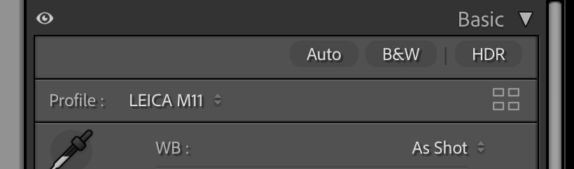

marchyman Posted November 26, 2024 Share #82 Posted November 26, 2024 15 hours ago, CDodkin said: Adobe Lightroom: Go to the "Camera Calibration" panel. Select the newly created profile from the "Profile" dropdown menu. That is confusing. There is a "calibration" pane, but that is not where the profile is selected. The selection is made in the basic panel. Welcome, dear visitor! As registered member you'd see an image here… Simply register for free here – We are always happy to welcome new members! 1 Link to post Share on other sites Simply register for free here – We are always happy to welcome new members! ' data-webShareUrl='https://www.l-camera-forum.com/topic/413636-m11-p-advice-for-achieving-the-best-colour-accuracy/?do=findComment&comment=5713542'>More sharing options...

Steadimann Posted November 29, 2024 Share #88 Posted November 29, 2024 This is a bit out of topic but still concerning M11 colours I intend to do a test with colour chart and a person to see how Leica M11 sensor reacts to tungsten (3200k) and daylight (5600k), maybe for the sake of interest I will include also LED lights at same temperatures. This will make an interesting result for seeing colour rendering results in different light sources + how much does camera sensor calibration under specific light changes the final result comparing stock camera profile vs. calibrated with colour chart under various lights. Link to post Share on other sites More sharing options...
