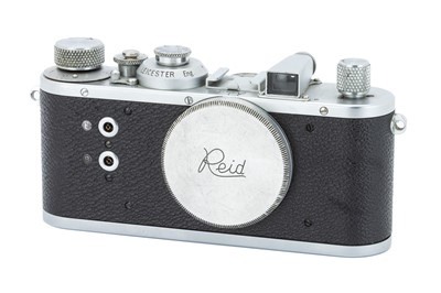

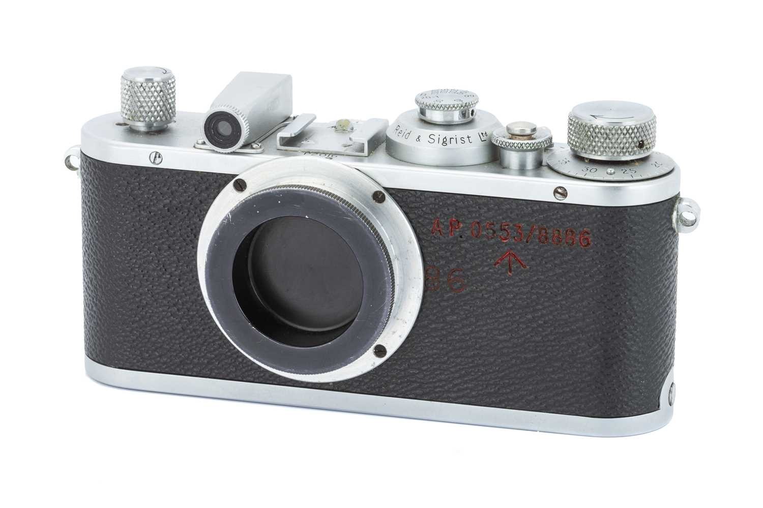

willeica Posted October 9, 2024 Share #12 Posted October 9, 2024 The LENEU was the I Model C This looks like it has been modified for periscope use like this Royal Navy Reid from the 1950s. Welcome, dear visitor! As registered member you'd see an image here… Simply register for free here – We are always happy to welcome new members! I was offered one once, but did not purchase it - I have a similar Royal Navy Reid with no hole at the back. I think I may have material somewhere about how this worked, probably in a Zoom talk by Tim Goldsmith to PCCGB about the John Vincent Reid Collection. If you Google, you might find out how this worked. I imagine that the camera was connected from the back end for view/focus and from the front for taking. How the film was handled is another matter. William 2 Link to post Share on other sites Simply register for free here – We are always happy to welcome new members! I was offered one once, but did not purchase it - I have a similar Royal Navy Reid with no hole at the back. I think I may have material somewhere about how this worked, probably in a Zoom talk by Tim Goldsmith to PCCGB about the John Vincent Reid Collection. If you Google, you might find out how this worked. I imagine that the camera was connected from the back end for view/focus and from the front for taking. How the film was handled is another matter. William ' data-webShareUrl='https://www.l-camera-forum.com/topic/413431-need-help-identifying-this-vintage-leica-rangefinder/?do=findComment&comment=5650616'>More sharing options...
willeica Posted October 10, 2024 Share #13 Posted October 10, 2024 8 hours ago, willeica said: The LENEU was the I Model C This looks like it has been modified for periscope use like this Royal Navy Reid from the 1950s. Welcome, dear visitor! As registered member you'd see an image here… Simply register for free here – We are always happy to welcome new members! I was offered one once, but did not purchase it - I have a similar Royal Navy Reid with no hole at the back. I think I may have material somewhere about how this worked, probably in a Zoom talk by Tim Goldsmith to PCCGB about the John Vincent Reid Collection. If you Google, you might find out how this worked. I imagine that the camera was connected from the back end for view/focus and from the front for taking. How the film was handled is another matter. William At about 23 minutes in, Tim Goldsmith doubts whether the periscope Reids were real. That would not be surprising as 'Major Reid' was a Walter Mitty type and there was a lot of illusion and trickery as regards the whole Reid project. You need to watch this in full plus Part 2 to get the full flavour of the whole Reid business. https://www.l39cambase.co.uk/about_reid.php There is some interesting material here about a Kodak design with a viewfinder on top which would have allowed viewing while the camera was on the periscope and there are some photos here, but no hole in the back of a camera. https://catalogs.marinersmuseum.org/object/CL28506 The Imperial War Museum would be a good place to start looking for periscope cameras. William Link to post Share on other sites More sharing options...
