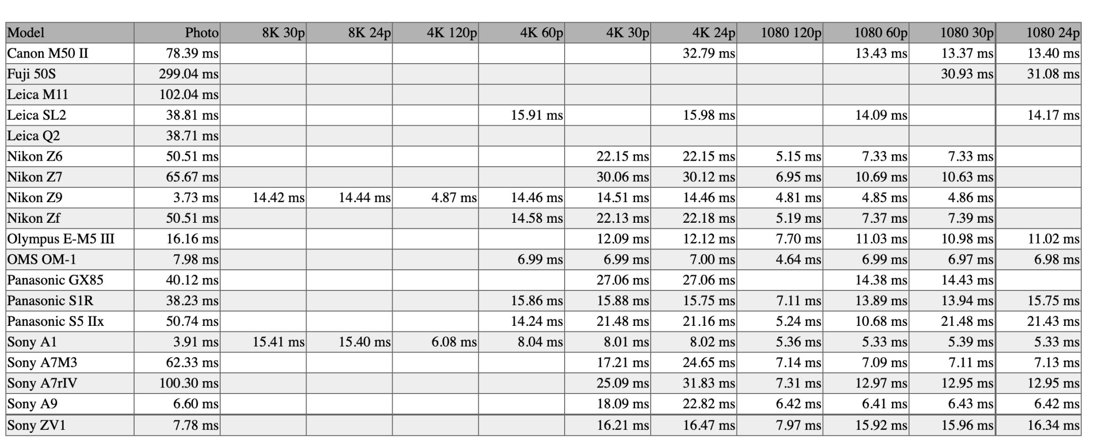

tomasis7 Posted March 8, 2024 Share #8  Posted March 8, 2024 (edited) someone can verify 30ms sensor readout for 24p 4k? I saw it in Sebs post. Sl2 has a lower readout, 16ms. Edited March 8, 2024 by tomasis7 Link to post Share on other sites More sharing options...
