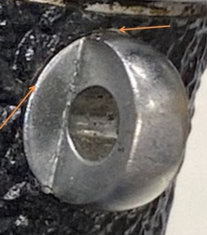

it may well be, but there are some abrasion lines/marks clearly showing, suggesting to me that a mechanical abrasive such as sandpaper has been used too, on the underlying metal, even if it has been sandblasted afterwards.
Just a pity that the rechroming has been done so inexpertly... Quite apart from the mechanical removal of the old chrome, there are places where the chrome has not taken, like the edge of the bottom plate and under the righthand screw of the top plate. The "vulcanite" replacement does not fit all too well either...

it looks to me like replacement vulcanite (4008?). Original vulcanite was applied on bare shell, lugs were fixed in the next step, on /through vulcanite. With replacements there are holes cut for the lugs, on one place you may see the shell
Allow me to post original size image link for you: https://imgur.com/a/IHC9MKv
And I take additional photos: https://imgur.com/a/vPZaeBh
If this is recovered new skin, it could mean original cover already lost (due painted grey cover becomes brittle).
I guess the intact original parts left is shutter curtain.

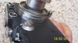

I am adding an article about your IIIc K. Willy Hahne, founder of the famous Leica Historica in Burg Staufenberg, has compiled this list which includes both the Leica IIIc K for military use and the civilian versions.
List of gray IIIc all Willy Hahne models:
-N°387'201 to 387'300 (99) -N°387'501 to 390'524 (23) -N°391'026 to 391 039 (13) -N°387'201 to 387'300 (99) ) -N°387'501 to 390'524 (23) -N°391'026 to
391,039 (13) 391,424 to 391,699 (275).
Your IIIc K 390175 is therefore in this list.
It is actually known that the American army had recovered the last IIIc K and also a stock of gray paint and that these devices would have been intended for officers and intelligence services.
I had in my collection this gray IIIc K No. 390946 with its Summitar.
In any case, it's a shame indeed that this IIIc K has been distorted by re-chroming if that is the case.

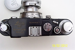

I have Leica IIIcK # 390 732 in my collection. It is finished in gray without any military engravings.
I did a search in Lager’s Wehrmacht Leica, and this camera is not listed. I did some research on this camera some years back and seem to recall it was issued to US Army Signal Corps after April/ May of 1945.

Bill, I was told by the Leica Archive some years ago that one of my two grey Leica IIIcs was issued to the Luftwaffe . I forget at this stage whether it was the K or the ordinary one. Having checked with Jim Lager, Lars Netopil and the Luigi Cane book, I am convinced that it was not issued to the military, but was just sent to Berlin, usually shown as 'Bln' on the records. As I did not buy either camera as a military item, this did not bother me. Lars told me about 10 years ago that if an item was in Cane's book, it was definitely German military. If It was not, then specific proof would be required.

Hi Bill, from research it appears that from serial number No. 390451 to No. 391190, with a few exceptions, they all have the delivery "US. Army 1945/46.
