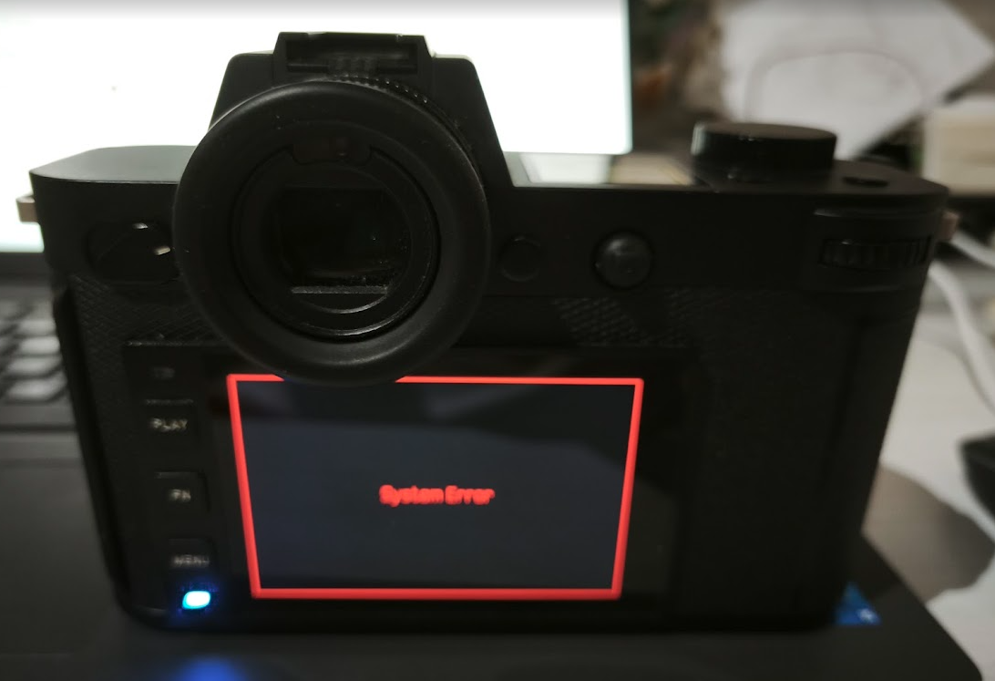

CptSlevin Posted November 18, 2024 Share #62  Posted November 18, 2024 Had one system error recently, no reason at all, camera behaved perfectly all day and then bam - error. I have like 18k shots in mechanical mode and more than 200k in electronic. Got my camera to repairs and they were shocked, they fought shutter died, but died IBIS. They had to reassemble it. Welcome, dear visitor! As registered member you'd see an image here… Simply register for free here – We are always happy to welcome new members! CAMERA MODEL and Serial - SL2S (5644642) DATE of PURCHASE - 2021/11/05 DATE OF FAILURE (if known) - 2024/11 Link to post Share on other sites Simply register for free here – We are always happy to welcome new members! CAMERA MODEL and Serial - SL2S (5644642) DATE of PURCHASE - 2021/11/05 DATE OF FAILURE (if known) - 2024/11 ' data-webShareUrl='https://www.l-camera-forum.com/topic/383396-poll-sl2-sl2-s-system-error-fault/?do=findComment&comment=5702646'>More sharing options...

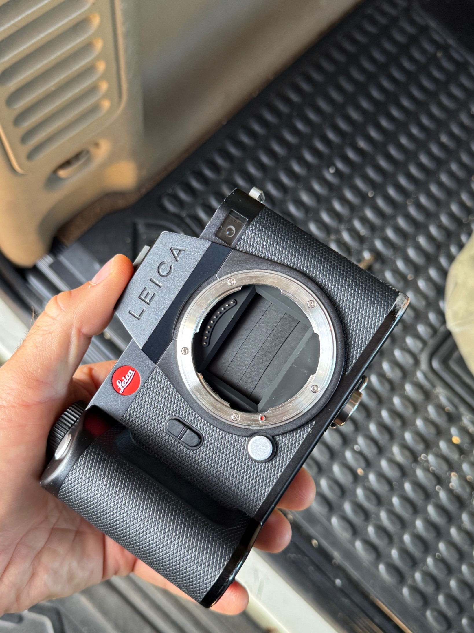

brenton Posted November 20, 2024 Share #63  Posted November 20, 2024 We just had a similar SYSTEM ERROR issue today. We have 2 x SL2-S bodies. When we put in a new SD card and took a test photo, the camera bricked. Nothing will reset it. Screen and EVF are black. The LCD on top turns on, but that's about it. We tried everything, swapping batteries, lens, SD cards, Off/On, Press and Hold Various button combos, etc, repeat. Finally noticed that the shutter is stuck over the sensor. Sounds like a Shutter Unit. I guess we have to send it into Leica? Welcome, dear visitor! As registered member you'd see an image here… Simply register for free here – We are always happy to welcome new members! Link to post Share on other sites Simply register for free here – We are always happy to welcome new members! ' data-webShareUrl='https://www.l-camera-forum.com/topic/383396-poll-sl2-sl2-s-system-error-fault/?do=findComment&comment=5705372'>More sharing options...

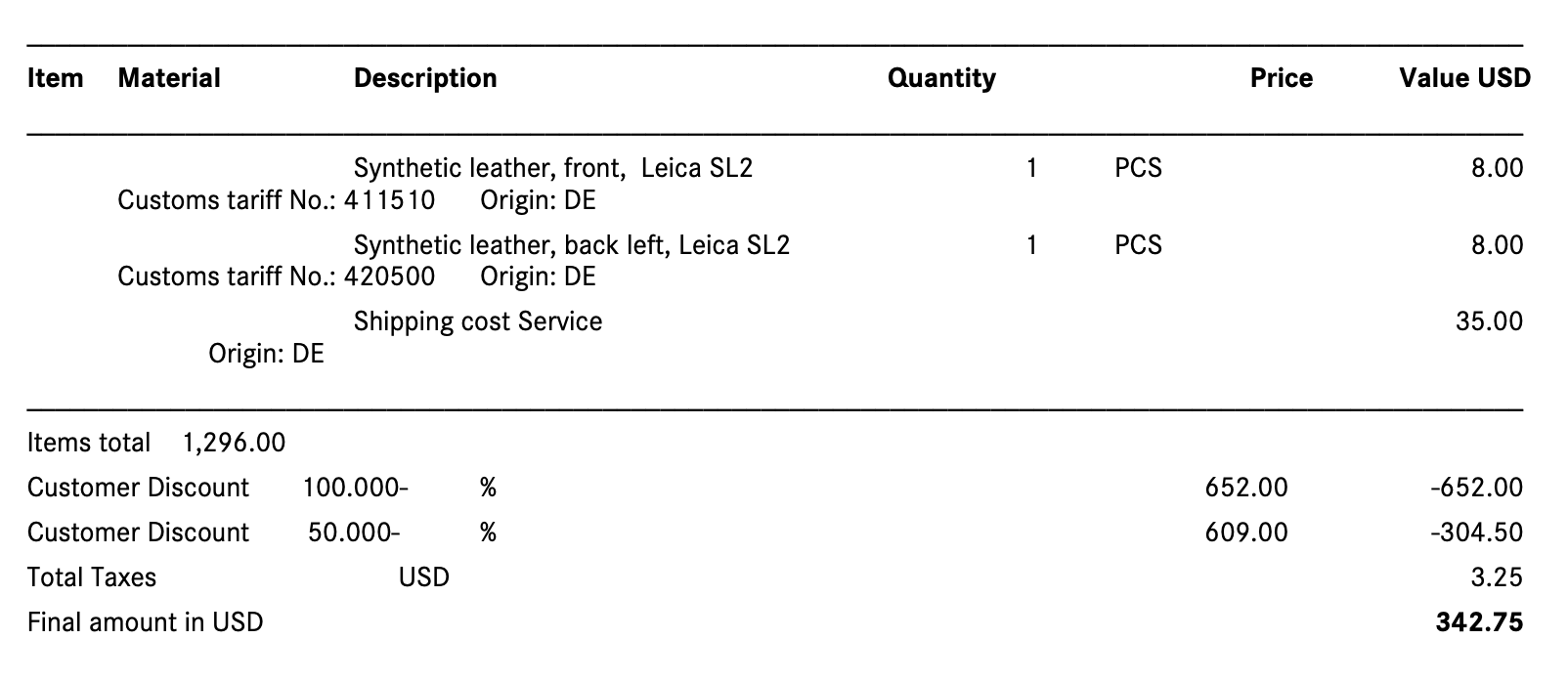

hellobrandonscott Posted December 30, 2024 Share #68  Posted December 30, 2024 Following up - I sent the camera to repair and this is what they've quoted me for a full shutter replacement.  Welcome, dear visitor! As registered member you'd see an image here… Simply register for free here – We are always happy to welcome new members! Link to post Share on other sites Simply register for free here – We are always happy to welcome new members! ' data-webShareUrl='https://www.l-camera-forum.com/topic/383396-poll-sl2-sl2-s-system-error-fault/?do=findComment&comment=5731286'>More sharing options...
Olaf_ZG Posted December 30, 2024 Share #69 Â Posted December 30, 2024 I would say a fair quote for a camera with 400k clicks. 1 Link to post Share on other sites More sharing options...
hellobrandonscott Posted February 7 Share #70  Posted February 7 Following up, got the camera back and it's good as new! All in, it was about 7 weeks. They replaced the entire shutter assembly and gave it a clean. Taking it to it's first wedding of the season today!   Welcome, dear visitor! As registered member you'd see an image here… Simply register for free here – We are always happy to welcome new members! 1 Link to post Share on other sites Simply register for free here – We are always happy to welcome new members! ' data-webShareUrl='https://www.l-camera-forum.com/topic/383396-poll-sl2-sl2-s-system-error-fault/?do=findComment&comment=5753389'>More sharing options...

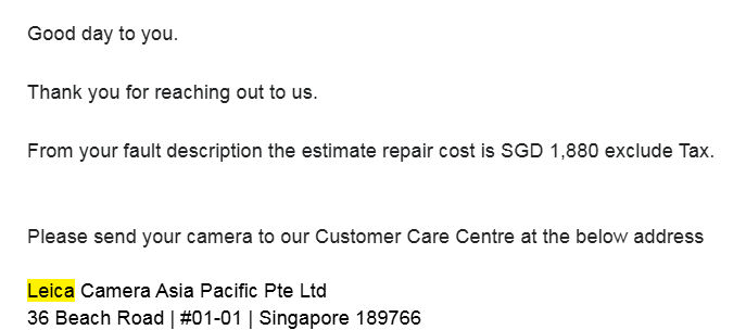

WDP Posted September 26 Share #78  Posted September 26 MY SL2-S , System error, shutter stuck, bluetooht connect working. CAMERA MODEL and Serial - SL2-S no. ***30045 DATE of PURCHASE - 2021/05/17 DATE OF FAILURE (if known) - 2025/07 Leica SG quote me 1,880 SGD est. 1,400-1,500 USD Could it be 3xx USD as @hellobrandonscott case? Or I could sell it as part? Welcome, dear visitor! As registered member you'd see an image here… Simply register for free here – We are always happy to welcome new members! Link to post Share on other sites Simply register for free here – We are always happy to welcome new members! ' data-webShareUrl='https://www.l-camera-forum.com/topic/383396-poll-sl2-sl2-s-system-error-fault/?do=findComment&comment=5868148'>More sharing options...
