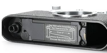

Giuliobigazzi Posted September 9, 2023 Share #1 Posted September 9, 2023 Advertisement (gone after registration) I’ve come into possession of this Leica iiib upgrade, or so it would seem by the serial number lettering. However I can’t figure out what it would have be upgraded from or to, as the iiib is a different size to both the iiia and iiic. It has no flash sync or other additions. The only thing that looks different to me is the bottom mechanism and information plate. Welcome, dear visitor! As registered member you'd see an image here… Simply register for free here – We are always happy to welcome new members! Link to post Share on other sites Simply register for free here – We are always happy to welcome new members! ' data-webShareUrl='https://www.l-camera-forum.com/topic/381820-iiib-upgrade/?do=findComment&comment=4853433'>More sharing options...

willeica Posted September 9, 2023 Share #2 Posted September 9, 2023 42 minutes ago, Giuliobigazzi said: I’ve come into possession of this Leica iiib upgrade, or so it would seem by the serial number lettering. However I can’t figure out what it would have be upgraded from or to, as the iiib is a different size to both the iiia and iiic. It has no flash sync or other additions. The only thing that looks different to me is the bottom mechanism and information plate. Welcome, dear visitor! As registered member you'd see an image here… Simply register for free here – We are always happy to welcome new members! I suspect the 'upgrade' might be in the shutter with later features, ball race ? You would probably have to strip down the camera to find out. There is nothing unusual about the external bodywork. The IIIa and IIIb overlapped and sometimes you will find IIIas with later features than some IIIbs, e.g. window with no indent. The following selection from my collection illustrates this. William 1 Link to post Share on other sites More sharing options...
jerzy Posted September 10, 2023 Share #3 Posted September 10, 2023 Giulio, bottom cover plat5e is indeed unusual, never seen such before. But this alone is not yet evidence that the camera has been upgraded, as William wrote we would need to see inernals of the camera. "Regular" upgrades of IIIb have not been offered and the only upgrade of IIIb that would make sense to me would be shutter brake like it was in most of IIIa syn. But we do not see it on your photos. But would you show a photo showing reverse lever in R posuition like on my photo below? I cannot see it very clearly on your photos but suspect that your camera might not have a feature introduced already in 1936 to all models excl Standard Welcome, dear visitor! As registered member you'd see an image here… Simply register for free here – We are always happy to welcome new members! William, I believe that we communicated before about your camera in the middle. IIIb is from the very first batch and has stepped viewer window. From approx 241xxx all II and IIIs have non-stepped 1 1 Link to post Share on other sites Simply register for free here – We are always happy to welcome new members! William, I believe that we communicated before about your camera in the middle. IIIb is from the very first batch and has stepped viewer window. From approx 241xxx all II and IIIs have non-stepped ' data-webShareUrl='https://www.l-camera-forum.com/topic/381820-iiib-upgrade/?do=findComment&comment=4854031'>More sharing options...
Giuliobigazzi Posted September 10, 2023 Author Share #4 Posted September 10, 2023 Jerzy, here is a photo of the lever you mention Giulio Welcome, dear visitor! As registered member you'd see an image here… Simply register for free here – We are always happy to welcome new members! Link to post Share on other sites Simply register for free here – We are always happy to welcome new members! ' data-webShareUrl='https://www.l-camera-forum.com/topic/381820-iiib-upgrade/?do=findComment&comment=4854040'>More sharing options...

Giuliobigazzi Posted September 10, 2023 Author Share #6 Posted September 10, 2023 I’ve asked Leica for a delivery date, and for any repair info. Maybe it was a swap for a lost/damaged iiib or a camera produced postwar using an unused serial. Will report back once if I hear anything 1 Link to post Share on other sites More sharing options...
Giuliobigazzi Posted September 11, 2023 Author Share #7 Posted September 11, 2023 Advertisement (gone after registration) So I’ve heard back from leica. Camera delivered 21.3.1938 and went back to the factory 27.12.1960. No notes on what was done but looking under the bottom cover it looks like the shutter is the regular kind without ball bearings. Link to post Share on other sites More sharing options...
jerzy Posted September 11, 2023 Share #8 Posted September 11, 2023 ... and Giulio made me aware about unusual bottom cover plate - I have seen it before (but forgot) - it may be found on postwar IIIa, 18x24 (Leica 72) that were produced in late 50-ties and early 60-ties and as well on some (not all) upgrades to IIIa syn performed after 1954. I have not seen it on Monte en Saare, but there were assembled earlier Welcome, dear visitor! As registered member you'd see an image here… Simply register for free here – We are always happy to welcome new members! 2 Link to post Share on other sites Simply register for free here – We are always happy to welcome new members! ' data-webShareUrl='https://www.l-camera-forum.com/topic/381820-iiib-upgrade/?do=findComment&comment=4855218'>More sharing options...
willeica Posted September 18, 2023 Share #9 Posted September 18, 2023 On 9/11/2023 at 5:26 PM, jerzy said: ... and Giulio made me aware about unusual bottom cover plate - I have seen it before (but forgot) - it may be found on postwar IIIa, 18x24 (Leica 72) that were produced in late 50-ties and early 60-ties and as well on some (not all) upgrades to IIIa syn performed after 1954. I have not seen it on Monte en Saare, but there were assembled earlier Welcome, dear visitor! As registered member you'd see an image here… Simply register for free here – We are always happy to welcome new members! I have this post war 1948-50 IIIa which has been converted to what one might call IIIf BD status, except that the chassis is not as wide. It is not totally dissimilar to what has been posted by Giulio and Jerzy, except that it does not have what I call the 'cover' or the 'illustration'. These may have been removed while the sync conversion was being done. This was clearly done in the Leica HQ facility. I'd be interested in Jerzy's comments on the technical aspects of this. I will probably check on the delivery/service history of this item when I am in the Leica Archives in October. William Link to post Share on other sites More sharing options...
jerzy Posted September 18, 2023 Share #10 Posted September 18, 2023 William, your camera received improved curtain brake, drum type, known from IIIc. Some details of top cover indicate that conversion was done after 1954, maybe you will get more precise date from Archive. Wind knob with DIN/ASA indicator was standart feature in upgrades, I believe. 1 Link to post Share on other sites More sharing options...
