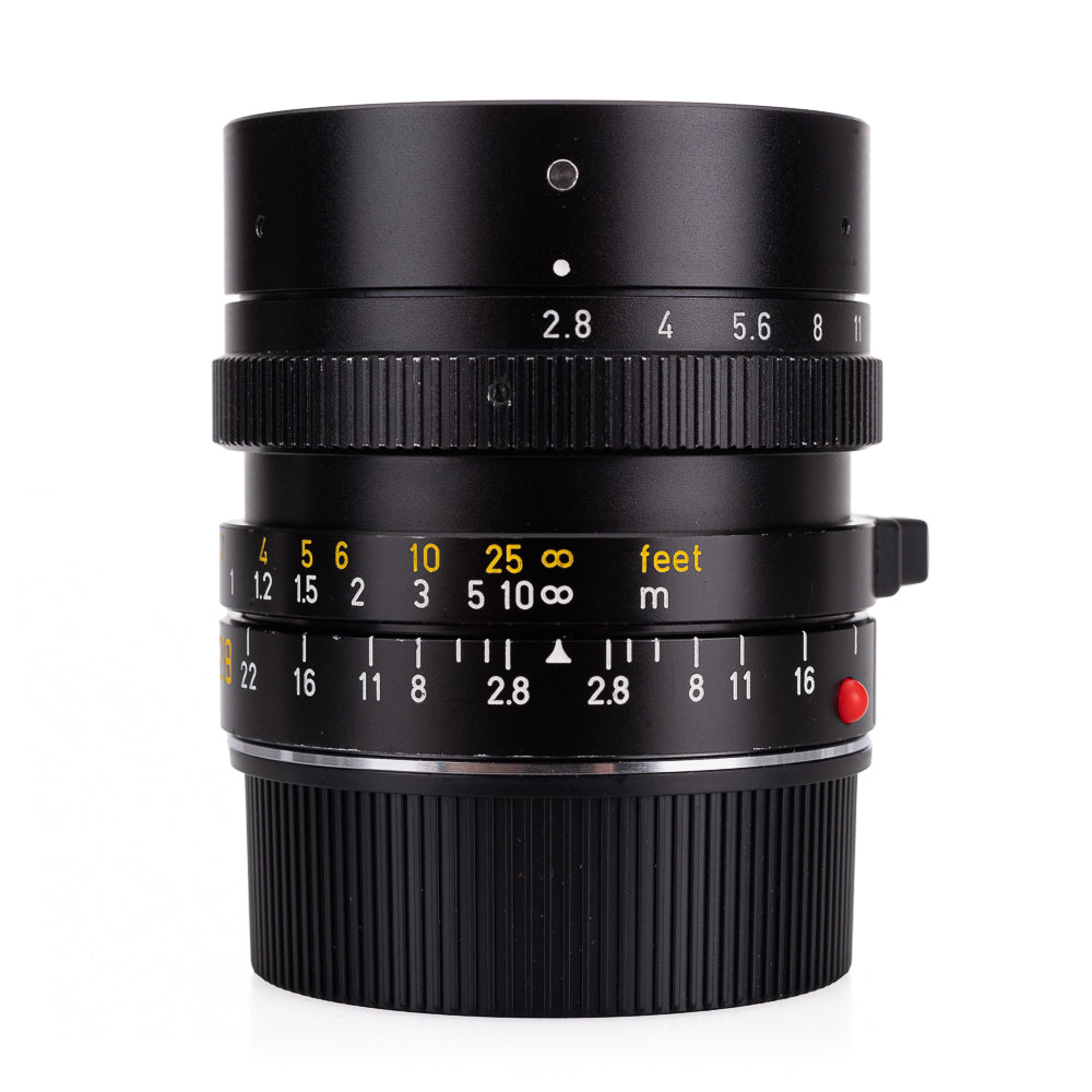

Landberg Posted August 18, 2023 Share #1 Posted August 18, 2023 (edited) Advertisement (gone after registration) Hi! My lens makes this clicking sound when I focus fast and just stop. Is this normal or might something inside have become loose? It makes no sound if I only shake it. Listen here it’s not at the hard stop, it’s when ever I just stop focusing. Edited August 18, 2023 by Landberg Link to post Share on other sites More sharing options...

Landberg Posted August 18, 2023 Author Share #2 Posted August 18, 2023 41 minutes ago, Multicoated said: Sounds like a sticky focusing action. Something with the grease. Hard to tell in 4 seconds. If you focus normally can you hear it? Because that’s not a way anyone would move their focusing ring. Since you didn’t mention anything about the lens or how old it is, then I would assume it needs a CLA. I would imagine that re-greasing the focusing ring will fix it. Thanks! it sounds like that even when I do it slow. Every time I start and or stop focus. It’s the version 1 Elmarit 28mm ASPH. Link to post Share on other sites More sharing options...

lifeandmylens Posted August 18, 2023 Share #4 Posted August 18, 2023 Does the patch line up or does it jump when you hear that noise? Link to post Share on other sites More sharing options...
Landberg Posted August 18, 2023 Author Share #5 Posted August 18, 2023 6 minutes ago, lifeandmylens said: Does the patch line up or does it jump when you hear that noise? Nope, it works just fine! 1 Link to post Share on other sites More sharing options...
lifeandmylens Posted August 18, 2023 Share #6 Posted August 18, 2023 1 minute ago, Landberg said: Nope, it works just fine! Good, sounds like it just needs a cleaning like @Multicoated said. Link to post Share on other sites More sharing options...
wizard Posted August 18, 2023 Share #7 Posted August 18, 2023 Advertisement (gone after registration) vor 2 Minuten schrieb Landberg: Nope, it works just fine! Well then, why bother. Just use the lens as it is, the sound will not impair your shots in any way. Link to post Share on other sites More sharing options...
Landberg Posted August 18, 2023 Author Share #8 Posted August 18, 2023 9 minutes ago, wizard said: Well then, why bother. Just use the lens as it is, the sound will not impair your shots in any way. It won’t do harm in the long run? Link to post Share on other sites More sharing options...

Bronco McBeast Posted August 22, 2023 Share #11 Posted August 22, 2023 This lens is notorious for wobbling; and there is nothing that can be done. No amount of tightening will correct it. If you take off the hood you will notice a tiny play in the front optical cell where is the aperture ring. it’s just how the lens is made; and it’s a shame. Link to post Share on other sites More sharing options...
Landberg Posted August 22, 2023 Author Share #12 Posted August 22, 2023 8 hours ago, Bronco McBeast said: This lens is notorious for wobbling; and there is nothing that can be done. No amount of tightening will correct it. If you take off the hood you will notice a tiny play in the front optical cell where is the aperture ring. it’s just how the lens is made; and it’s a shame. On 8/21/2023 at 10:33 AM, wizard said: There is a saying "Never change a running system", so why do something now if it works just fine as you say. The sound won't do any harm in the long run either. Once the lens does not work fine, send it in and have it CLAed. Why waste money now. After all, it is the result that counts, and the results seem to be fine. I see. Well, then i’ll just keep on shooting;) 1 Link to post Share on other sites More sharing options...

Bronco McBeast Posted August 24, 2023 Share #17 Posted August 24, 2023 The wobble is actually the whole optical cell, not just the front group. While you make it wobble, look at the rear lens and you will see it wobble as well. There is no fix for that, except maybe macgyvering something llike adding shimss to the locking ring, or actually shaving it down. Or glue. Regrding the elmarit asph V1, the problem really is just a mistake in the production tolerances. Cute design, very sexy size, but obviously an economy move from Leica to create an economy lens . It is far from the Summicron in all aspects, including its imaging characteristics which are rudimentary and raw compared to the extremely well behaved and gentleSummicron. Link to post Share on other sites More sharing options...
Landberg Posted November 20, 2023 Author Share #18 Posted November 20, 2023 I just got the lens back from Germany. This is what they found during service “Our service technician has detected a centering error”. now the lens feels like new, no noise. 1 Link to post Share on other sites More sharing options...
