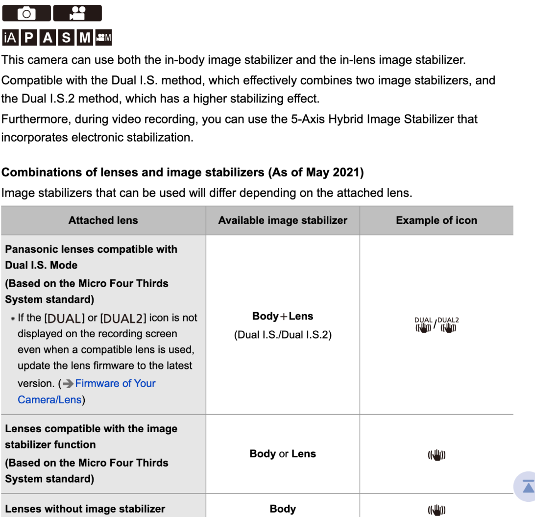

Please -reread multiple posts in this thread-not only by me. BTW Panasonic has a good clarification of five-axis stabilization by IBIS-OIS interaction on its site, albeit for MFT
I note that you have still not provided any references or justification for your statements that OIS and IBIS, “will only work if a lens and camera are of the same brand.”  This information you provide related to Panasonic in no way corroborates or validates your claims.  I have nothing further to add on this, and, as I said above, will seek clarification directly from the manufacturers.
