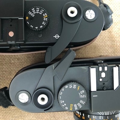

Anbaric Posted April 23, 2023 Share #18 Posted April 23, 2023 Do you like the M6 rewind crank, or will this eventually end up as the MP you could have bought instead? 🙂 1 5 Link to post Share on other sites More sharing options...

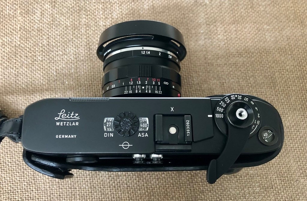

newtoleica Posted April 23, 2023 Share #19 Posted April 23, 2023 I just did this to my M7. Huge improvement and the collar came off really easily….. Welcome, dear visitor! As registered member you'd see an image here… Simply register for free here – We are always happy to welcome new members! 2 Link to post Share on other sites Simply register for free here – We are always happy to welcome new members! ' data-webShareUrl='https://www.l-camera-forum.com/topic/375844-changing-the-film-advance-lever-on-the-new-m6/?do=findComment&comment=4756655'>More sharing options...
