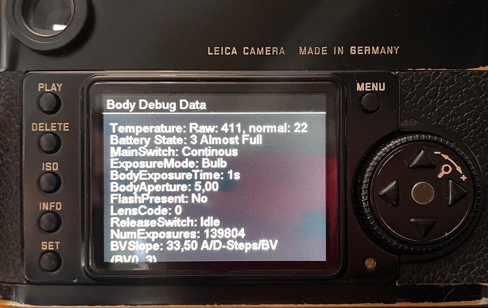

Overgaard Posted January 14, 2023 Share #4 Posted January 14, 2023 Here is a screen shot of M9: Welcome, dear visitor! As registered member you'd see an image here… Simply register for free here – We are always happy to welcome new members! Link to post Share on other sites Simply register for free here – We are always happy to welcome new members! ' data-webShareUrl='https://www.l-camera-forum.com/topic/360254-does-this-picture-prove-that-this-m9-monochrom-has-had-its-sensor-changed/?do=findComment&comment=4642780'>More sharing options...
Overgaard Posted January 14, 2023 Share #5 Posted January 14, 2023 To get the shutter count and the rest of what is called "Body Debug Data" on the Leica M9, Leica M9-P, Leica Monochrome and Leica M-E: Push the Delete button, push the UP x 2 (on the Central Setting dial for navigation), push the DOWN x 4, push the LEFT x 3, push the RIGHT x 2; then push Info button. Go to Hardware IDs to get the sensor model. Go to Body Debug Data for shutter count (scroll down a couple of lines to see "NumExposures: 1 1 Link to post Share on other sites More sharing options...
Overgaard Posted January 14, 2023 Share #6 Posted January 14, 2023 Go to Body Debug Data for shutter count (scroll down a couple of lines to see "NumExposures": Welcome, dear visitor! As registered member you'd see an image here… Simply register for free here – We are always happy to welcome new members! 1 Link to post Share on other sites Simply register for free here – We are always happy to welcome new members! ' data-webShareUrl='https://www.l-camera-forum.com/topic/360254-does-this-picture-prove-that-this-m9-monochrom-has-had-its-sensor-changed/?do=findComment&comment=4642814'>More sharing options...
69xchange Posted January 15, 2023 Share #7 Posted January 15, 2023 Advertisement (gone after registration) 15 hours ago, Overgaard said: Go to Body Debug Data for shutter count (scroll down a couple of lines to see "NumExposures": Welcome, dear visitor! As registered member you'd see an image here… Simply register for free here – We are always happy to welcome new members! Wow, the shutter count on yours! Link to post Share on other sites More sharing options...
Overgaard Posted January 15, 2023 Share #8 Posted January 15, 2023 1 hour ago, 69xchange said: Wow, the shutter count on yours! Yes, and still going strong. I think the only thing that was ever changed was the sensor (twice), and then normal focus adjustments. 3 Link to post Share on other sites More sharing options...

colint544 Posted January 26, 2023 Share #12 Posted January 26, 2023 On 1/14/2023 at 9:59 PM, Overgaard said: To get the shutter count and the rest of what is called "Body Debug Data" on the Leica M9, Leica M9-P, Leica Monochrome and Leica M-E: Push the Delete button, push the UP x 2 (on the Central Setting dial for navigation), push the DOWN x 4, push the LEFT x 3, push the RIGHT x 2; then push Info button. Go to Hardware IDs to get the sensor model. Go to Body Debug Data for shutter count (scroll down a couple of lines to see "NumExposures: Thanks for this, Thorsten. Really helpful. I'd love to know the shutter count on my M9M, and I want to try this. After I've brought up this screen, and seen the data, what do I do to come out of that screen, and back to normal operation of the camera? Do I just switch it off and back on again? 1 Link to post Share on other sites More sharing options...
Overgaard Posted January 26, 2023 Share #13 Posted January 26, 2023 1 hour ago, colint544 said: Thanks for this, Thorsten. Really helpful. I'd love to know the shutter count on my M9M, and I want to try this. After I've brought up this screen, and seen the data, what do I do to come out of that screen, and back to normal operation of the camera? Do I just switch it off and back on again? Yes, off and on again and it's all back to normal. 1 Link to post Share on other sites More sharing options...
colint544 Posted January 26, 2023 Share #14 Posted January 26, 2023 (edited) 22 minutes ago, Overgaard said: Yes, off and on again and it's all back to normal. Thank you very much.. And it's worked - always wondered how that was done. Cheers! Edited January 26, 2023 by colint544 1 Link to post Share on other sites More sharing options...
colint544 Posted January 27, 2023 Share #15 Posted January 27, 2023 FWIW, a lowly 55K shutter actuations on my M9M. I've only used it for personal work, but I still thought I used it quite a bit. @Overgaard the 140K on your M9 is really something! Welcome, dear visitor! As registered member you'd see an image here… Simply register for free here – We are always happy to welcome new members! Link to post Share on other sites Simply register for free here – We are always happy to welcome new members! ' data-webShareUrl='https://www.l-camera-forum.com/topic/360254-does-this-picture-prove-that-this-m9-monochrom-has-had-its-sensor-changed/?do=findComment&comment=4660325'>More sharing options...
