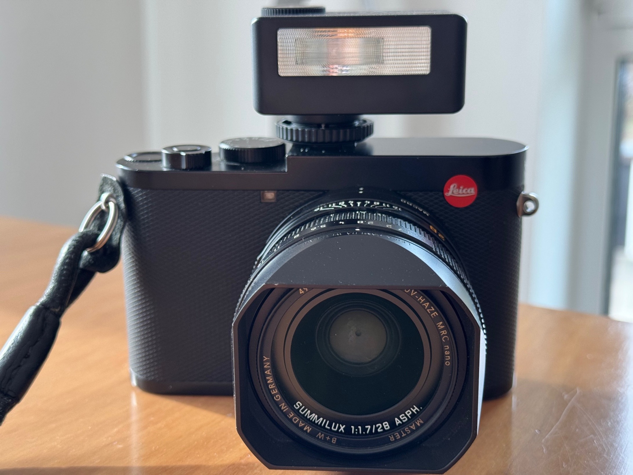

Daniel C.1975 Posted January 27, 2023 Share #18 Posted January 27, 2023 (edited) Hi, so, the Godox Lux Junior has arrived. I bought it at amazon.de for 85 Euro quit. Within the Amazon parcel was the box of the flash wrapped in plastic with a huge Made in China sticker and the sticker of the importer and some conformity sticker. If the Chinese know something than to give even such lower cost product a premium packaging. Once the wrapping was removed the box showed a Leica'este felling. Very sturdy nice black box with naming and photo and a magnetic lit to oben the box. Ah, forgot: on the outside of the box, held by the wrapping, was a diffusor which seems not be part of the original packaging. In the box the flash. The flash is of a good enough quality, nothing special, but it also does not feel cheap. In the box: - the flash - a flash-sync cable - a soft material pouch - a manual Outside of the box: A perfectly fitting diffusor. The square size of the top-view is 7x7cm. In manual mode you can only adjust the flash in full f-stops from 1/64 to 1/1 of power (1/64; 1/32; 1/16; 1/8; 1/4; 1/2; full). To help to find the right adjustment, there is a free spinning dial in the middle to adjust f-stop and iso based on distance (no real adjustment, just to support what to adjust). Very simple. I would have liked to get down to 1/128 of the power for more flexibility (but the Fuji was no better) and I would have liked to see half-stops for the adjustment. However, here comes the diffusor as a nice help. A, it diffuses quite nicely and B, it reduces the flash-power by roughly 2 f-stops - just an estimation after the first few minutes. Auto-Mode is funny. It is not really auto through a sensor or so, but seems to be a fixed flash value for f2.8; Iso 100 and a max. distance of 4m. To adjust you can play with the cameras aperture or Iso, but the flash-power is always the same. On the side is a switch to put the flash into slave mode: 1 = triggered by a flash without ttl-pre-flash; 2 = triggered by flash with ttl-pre-flash and Off. Quite nice for a simple flash set-up at home with my Nissin i40. Batteries are 2x AAA - I would have preferred 2x AA, but let's see how well this will work out. Out of the box the flash worked flawless. There is a very slight click when changing the dial with a nice feel. Colour temperature seems to be fine too. Overall a simple, nice looking and inexpensive manual flash which also can be used as a slave. All I can have asked for for the money. The Fuji EF-X20 was for sure a a bit nicer flash with a more premium feel, but this one is good enough and as easy to adjust manually. Attached a few fotos on the Q2 and the SL2s incl. the diffusor. Welcome, dear visitor! As registered member you'd see an image here… Simply register for free here – We are always happy to welcome new members! Edited January 27, 2023 by Daniel C.1975 6 4 Link to post Share on other sites Simply register for free here – We are always happy to welcome new members! ' data-webShareUrl='https://www.l-camera-forum.com/topic/336702-best-small-flash-for-leica-q-q2-for-indoors/?do=findComment&comment=4660993'>More sharing options...

SirBlunder Posted January 27, 2023 Share #20 Posted January 27, 2023 Daniel -- Thanks for all this great information!!! I had started writing a reply, then got distracted some work, and when I came back, you had made all your posts. Your post is going to be VERY helpful to those finding this thread for years to come. Looks great on the Q2 and appears to be of decent enough quality, especially for the $. Size looks right. Only question I have: How long does it take to recharge between shots? I'm basically between this one that you got, some small old/used clip on Fuji (NOT the $400+ one we've discussed), or the smallest Sunpak I can find. PS -- I have that same grip which I've stopped using in favor of the thumbs up (which I love), but obviously can't have two accessories in my hotshoe at once. 1 Link to post Share on other sites More sharing options...
