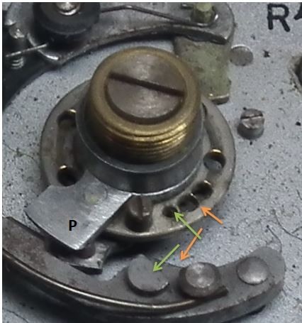

jerzy Posted June 25, 2022 Share #9  Posted June 25, 2022 (edited) it is because all of them share similar shutter construction. Here some internals - this is how it looks under the top cover of IIIa. Locking pawl holds and releases the second, closing curtain thus determines the speed. Locking pawl has additinal bolt (green) for 1/1000, all other speeds are released when part P touched the placed marked with orange arrow. Observe as well differnet diameter of holes on speed disc, this thes where the part P (to which speed dial is attached). Hole for 1/1000 is smaller, part P (and thus speed dial) sits higher Welcome, dear visitor! As registered member you'd see an image here… Simply register for free here – We are always happy to welcome new members!  Edited June 25, 2022 by jerzy spelling 7 3 Link to post Share on other sites Simply register for free here – We are always happy to welcome new members!  ' data-webShareUrl='https://www.l-camera-forum.com/topic/333883-just-bought-a-iiia-and-have-a-question/?do=findComment&comment=4459853'>More sharing options...

garryleica Posted June 25, 2022 Author Share #11  Posted June 25, 2022 10 minutes ago, jerzy said: it is because all of them share similar shutter construction. Here some internals - this is how it looks under the top cover of IIIa. Locking pawl holds and releases the second, closing curtain thus determines the speed. Locking pawl has additinal bolt (green) for 1/1000, all other speeds are released when part P touched the placed marked with orange arrow. Observe as well differnet diameter of holes on speed disc, this thes where the part P (to which speed dial is attached). Hole for 1/1000 is smaller, part P (and thus speed dial) sits higher Welcome, dear visitor! As registered member you'd see an image here… Simply register for free here – We are always happy to welcome new members!  Thanks for putting that up. I can see if they'd used the same size hole, it would overlap into the one next to it. Pretty sure my dad used to have a Leica repair book when I was a kid. I'll ask if he still has it, might come in useful. Link to post Share on other sites More sharing options...
