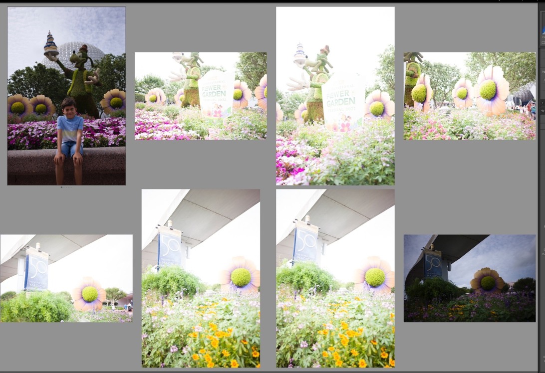

Advertisement Posted December 20, 2022 Posted December 20, 2022 Hi Harpomatic, Take a look here Why is my M11 randomly, drastically overexposing?. I'm sure you'll find what you were looking for!
