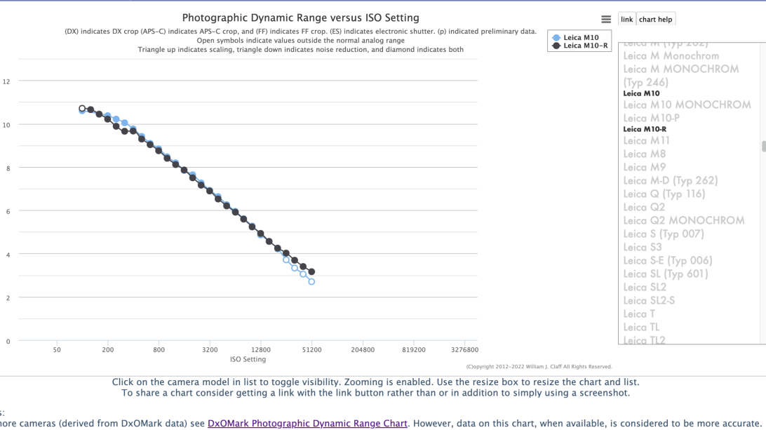

The M10-R has a better highlight recovery than the M10. However, the photonstophotos chart shows that the dynamic range of the M10 and M10-R is very similar and the shadow recovery of the M10 is a bit better than that of the M10-R:
https://www.photonstophotos.net/Charts/PDR.htm#Leica%20M9,Leica%20M10,Leica%20M10-R
Do you think the M10-R distributes more of the available DR to the highlights than the M10 does? and that is why the M10-R has better treatment of highlights or, even, more dynamic range than the M10? but as shown in the charts linked above, that the shadow recovery of the M10-R is not as good as that of the M10 — and in some other comparisons the M10R has more noise than M10 .
I'm wondering if we shoot with M10 1 stop under what we shoot with M10-R (both at ISO 200) and then add 1 stop exposure to the shadows (for M10 picture) in post processing, how much the highlight recovery and shadows details/noise will be different between those camera? Has anyone did this comparison?
No significant difference...   A third of an EV is less than the tolerance of your exposure metering.

I'm wondering if the chart shows the recoverable highlights too.
Some M10-R users noted they were able to recover highlights 1 stop more than M10. (link below - min 7:50)  I'm wondering if that's just a 1 stop DR shift towards highlights in M10-R or the M10-R dynamic range is really 1 stop wider? Comparing the shadows (details and noise) maybe can give us a better a comparison.

I guess it has nothing to do with DR. Recovering highlights is done by interpolating the non-blown colour channels to create detail. It is quite possible that there is some difference in the algorithms used. There is certainly a difference in the amount of detail to recover.
Clipped highlights are not always user mistake. In high contrast situations when you try to expose the subject the bright part of the picture gets blown out and this is limited to the dynamic range. Wider dynamic range give you the ability to recover some of the blown out highlights.
My question was if this value is really one stop wider in M10-R? or it's mostly a software adjustment in M10-R firmware. (or both of them)
I'm not really sure if that chart is seeing/including the recoverable highlights too.

Some people think Leica just shifted the DR towards highlight for M10-R so it can keep more details in highlight after the clipping point and also I read some people said the shadows details and recovery is better in M10. If that's the case I'm wondering if shooting a half stop under exposed with m10 (to save the highlight from clipping) and then adding a half stop to shadows exposure in post-processing can give a very close result to M10-R? What do you think?
That would only mean that they adjusted the exposure curve to pull down the highlights and brighten the midtones and lift the shadows adjusting the black point at the same time in-camera before writing the DNG   That would certainly produce this effect if they adjusted the ISO value and exposure metering to match. Consider that a pixel produces an analog signal from base noise to 100% fill. The curve produced in between those two points can be modified.
The user can do a similar manipulation in postprocessing if he underexposes slightly, but this would make the process easier
I am sure that Leica can do more tricks than I can think of when designing their firmware.
