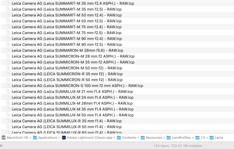

Here are some of the adobe lens profiles for Leica (mac file path at the bottom if you want to go a see on your own system)
Note that there's only one profile per lens...
It does not have a listing for every conceivable M body and M lens combination
For example take the summarit 35 entries. There are two, one for the 2.4 and one for 2.5, why? Because they're different lenses = different profiles
But it doesn't have a .lcp profile for say
Leica Camera AG M8 (Leica SUMMARIT-M 35 mm f2.4 ASPH.) - RAW.lcp
Leica Camera AG M9 (Leica SUMMARIT-M 35 mm f2.4 ASPH.) - RAW.lcp
Leica Camera AG M240 (Leica SUMMARIT-M 35 mm f2.4 ASPH.) - RAW.lcp
Leica Camera AG M10 (Leica SUMMARIT-M 35 mm f2.4 ASPH.) - RAW.lcp
Leica Camera AG M10R (Leica SUMMARIT-M 35 mm f2.4 ASPH.) - RAW.lcp
Leica Camera AG M11 (Leica SUMMARIT-M 35 mm f2.4 ASPH.) - RAW.lcp
It makes do with one .lcp for all of the M cameras
This is because adobe need to code the rendering of the M11 DNG to the existing lens profile, not create a new lens profile every time Leica make a new camera
Or put how you said it, yes actually it's exactly a case of recycling the recycling the existing lens profiles, and you can confirm this by counting how many M bodies they are Vs how many lens profiles there are for each lens (6 vs 1)
