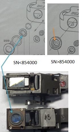

jerzy Posted February 23, 2022 Share #8 Posted February 23, 2022 (edited) vor 17 Stunden schrieb Brancbūth: Apparently there is nothing to fix very unusual.... as 105012 mentioned above consutruction of eyepiece/viewfinder change with 854000. Below there was a lens screwed on directly on viewfinder assy (and eypiece was just a black, empty ring), later the lens became part of eyepiece. And this is not plain glas, it is a lens. Without it you will nor see sharp. Your M3 is above 1Mio, so the lens shall be in eyepiece and not viewfinder. Because the lens is missing in your camera and you see everything sharp it means that possibly the viewfinder in your camera was replaced with the older one (lens mounted on viewfinder directly). But whatever, the main point is that camera works fine for you. Btw - do you see the notches on top and bottom of the rangefinder patch? This came as well with modified rangefinder from 854000 (however some of older rangefinders have been added this fetaure) Welcome, dear visitor! As registered member you'd see an image here… Simply register for free here – We are always happy to welcome new members! Edited February 23, 2022 by jerzy 1 Link to post Share on other sites Simply register for free here – We are always happy to welcome new members! ' data-webShareUrl='https://www.l-camera-forum.com/topic/326279-broken-glass-in-between-m3-viewfinder-glass-and-metal-ring/?do=findComment&comment=4389211'>More sharing options...
Brancbūth Posted February 23, 2022 Author Share #9 Posted February 23, 2022 11 hours ago, jerzy said: very unusual.... as 105012 mentioned above consutruction of eyepiece/viewfinder change with 854000. Below there was a lens screwed on directly on viewfinder assy (and eypiece was just a black, empty ring), later the lens became part of eyepiece. And this is not plain glas, it is a lens. Without it you will nor see sharp. Your M3 is above 1Mio, so the lens shall be in eyepiece and not viewfinder. Because the lens is missing in your camera and you see everything sharp it means that possibly the viewfinder in your camera was replaced with the older one (lens mounted on viewfinder directly). But whatever, the main point is that camera works fine for you. Btw - do you see the notches on top and bottom of the rangefinder patch? This came as well with modified rangefinder from 854000 (however some of older rangefinders have been added this fetaure) Welcome, dear visitor! As registered member you'd see an image here… Simply register for free here – We are always happy to welcome new members! Thanks for this information. I wonder why someone would have retrograded the viewfinder. I suppose it was just a matter of which parts were available at that particular time. I will take a look at my rangefinder patch when I get home. Link to post Share on other sites More sharing options...
