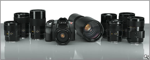

mgrayson3 Posted September 12, 2021 Share #12  Posted September 12, 2021 (edited) 15 minutes ago, Deliberate1 said: You know, Leica could resolve the issue by making a proper long lens for all of us. Perhaps it fears that many of us would perish from starvation after ponying up the price cost of admission. I quiver to think.... Best to you. David I believe the original plan was for a 350mm S lens.  There's even a picture of it (or a mockup) in the very early promotional material. The size, weight, and price (can you imagine?) made it impractical, so I was told. (There's a very funny video clip of "Things Leica Owners Say". It's in good fun and not at all hostile the way you might think. One brilliant bit is a woman wandering around singing to herself "Leica virgin. Broke for the very first time...") Matt Ah. Here we go... and there's a Tilt Shift lens off on the right... Welcome, dear visitor! As registered member you'd see an image here… Simply register for free here – We are always happy to welcome new members! Edited September 12, 2021 by mgrayson3 Quote Link to post Share on other sites Simply register for free here – We are always happy to welcome new members! ' data-webShareUrl='https://www.l-camera-forum.com/topic/324435-any-zeiss-tele-apotessar-350mm-shooters-out-there/?do=findComment&comment=4274055'>More sharing options...
