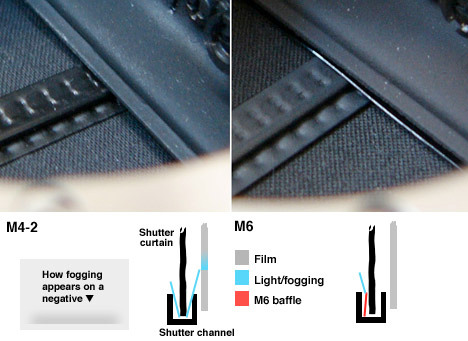

adan Posted May 23, 2021 Share #4 Posted May 23, 2021 Looks to me like failing light seals in the shutter curtain tracks. The darker strip of unfogged film right along the edge of the picture is fairly "signature" for a leak around the curtains, because that first mm or so of film is shaded by the thickness of the whole shutter opening. The cloth shutter curtains in film Leica Ms travel in top and bottom channels that are U shaped. Both to guide and reinforced the flexible cloth curtains, and as a light trap. To make them even more light-proof, they are lined with black felt (just like the lips of 35mm film canisters) in pre-M6 cameras. (M6 and later cameras use flexible black-plastic baffles in the channels, that "lean" against the shutter /| to seal out light). The felt lining will eventually wear out, as the shutter curtains slide back and forth over it for years. It is a fairly common item to replace when servicing cameras of that age. Happened with my M4-2, and (hah!) I just found an diagram I made 17 years ago for another forum that shows the M6 arrangement and explains the "protected" edges. Welcome, dear visitor! As registered member you'd see an image here… Simply register for free here – We are always happy to welcome new members! Anyway: needs the light seals replaced. As interim measures, make really sure to keep a lens cap on the lens at all times (yes, a lens lets in enough light, over time, to leak around the shutter if the seals are worn out) - and be sure to turn the camera away from the sun and into shade when changing lenses (did that with my M4-2 for about 6 months until I got a second body, and could let the M4-2 go into the shop for repair). Link to post Share on other sites Simply register for free here – We are always happy to welcome new members! Anyway: needs the light seals replaced. As interim measures, make really sure to keep a lens cap on the lens at all times (yes, a lens lets in enough light, over time, to leak around the shutter if the seals are worn out) - and be sure to turn the camera away from the sun and into shade when changing lenses (did that with my M4-2 for about 6 months until I got a second body, and could let the M4-2 go into the shop for repair). ' data-webShareUrl='https://www.l-camera-forum.com/topic/321134-m2-r-light-leak/?do=findComment&comment=4206008'>More sharing options...
Samascha Posted May 23, 2021 Author Share #5 Posted May 23, 2021 11 hours ago, adan said: Looks to me like failing light seals in the shutter curtain tracks. The darker strip of unfogged film right along the edge of the picture is fairly "signature" for a leak around the curtains, because that first mm or so of film is shaded by the thickness of the whole shutter opening. The cloth shutter curtains in film Leica Ms travel in top and bottom channels that are U shaped. Both to guide and reinforced the flexible cloth curtains, and as a light trap. To make them even more light-proof, they are lined with black felt (just like the lips of 35mm film canisters) in pre-M6 cameras. (M6 and later cameras use flexible black-plastic baffles in the channels, that "lean" against the shutter /| to seal out light). The felt lining will eventually wear out, as the shutter curtains slide back and forth over it for years. It is a fairly common item to replace when servicing cameras of that age. Happened with my M4-2, and (hah!) I just found an diagram I made 17 years ago for another forum that shows the M6 arrangement and explains the "protected" edges. Welcome, dear visitor! As registered member you'd see an image here… Simply register for free here – We are always happy to welcome new members! Anyway: needs the light seals replaced. As interim measures, make really sure to keep a lens cap on the lens at all times (yes, a lens lets in enough light, over time, to leak around the shutter if the seals are worn out) - and be sure to turn the camera away from the sun and into shade when changing lenses (did that with my M4-2 for about 6 months until I got a second body, and could let the M4-2 go into the shop for repair). I also think this is the most plausible case as well. In case i will not be replacing the light seal anytime soon, is there any tips or how can i avoid such leakage phenomenon in the picture, while using the camera? thank you Link to post Share on other sites More sharing options...
