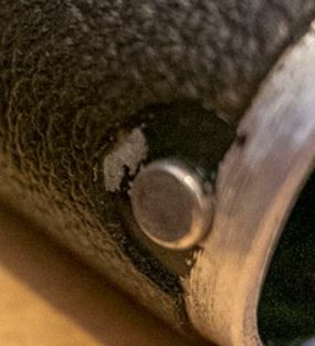

jerzy Posted December 19, 2020 Share #4 Posted December 19, 2020 accoring to Hahne list it was black painted, within a batch of 250 BP cameras (116001-116250). Where did you find it was chromed? Could you pls post additionally a photo of locking pin for bottom cover? It is for my researches. Link to post Share on other sites More sharing options...
nf3996 Posted December 19, 2020 Author Share #5 Posted December 19, 2020 1 hour ago, jerzy said: accoring to Hahne list it was black painted, within a batch of 250 BP cameras (116001-116250). Where did you find it was chromed? Could you pls post additionally a photo of locking pin for bottom cover? It is for my researches. I was looking at the list in G Rogliatti's Leica. The First Fifty Years (2nd edition), plus two searches on the internet - all came up with chrome for the serial number. Is the Hahne list available on the internet? I'm unsure which bit is the locking pin, so I've uploaded two photos of different parts that I think it might be. I hope one of them is correct ... Alan Welcome, dear visitor! As registered member you'd see an image here… Simply register for free here – We are always happy to welcome new members! Link to post Share on other sites Simply register for free here – We are always happy to welcome new members! ' data-webShareUrl='https://www.l-camera-forum.com/topic/316227-leica-iii-serial-number-curiosity/?do=findComment&comment=4101869'>More sharing options...
jerzy Posted December 19, 2020 Share #6 Posted December 19, 2020 vor einer Stunde schrieb nf3996: Is the Hahne list available on the internet? not that I am aware of. Some peoiple call it as well Band I, it is publication of Leica Historica Germany. Hardly available now, very seldom on auctions. This list contains as well mistakes and simplifications but is the best what is available. According to factory notes first, LLeitz started with test chroming on 106201-106300, these were II and it was January 1933. Re locking pin - thank you, yes, I meant this one Welcome, dear visitor! As registered member you'd see an image here… Simply register for free here – We are always happy to welcome new members! it is large pin, introduced in May 1933. Your III is very early, I thought it might have still small one. I never saw III with small pin, was curious. Link to post Share on other sites Simply register for free here – We are always happy to welcome new members! it is large pin, introduced in May 1933. Your III is very early, I thought it might have still small one. I never saw III with small pin, was curious. ' data-webShareUrl='https://www.l-camera-forum.com/topic/316227-leica-iii-serial-number-curiosity/?do=findComment&comment=4101930'>More sharing options...
Pyrogallol Posted December 19, 2020 Share #7 Posted December 19, 2020 Advertisement (gone after registration) I have a 111 in black and chrome, at least I think it is chrome it is difficult to tell in evening room light. No. 112674 with the large pin base lock. Welcome, dear visitor! As registered member you'd see an image here… Simply register for free here – We are always happy to welcome new members! Link to post Share on other sites Simply register for free here – We are always happy to welcome new members! ' data-webShareUrl='https://www.l-camera-forum.com/topic/316227-leica-iii-serial-number-curiosity/?do=findComment&comment=4102053'>More sharing options...
jerzy Posted December 20, 2020 Share #8 Posted December 20, 2020 until approx 1935 black painted cameras have nickeled fittings, if this one has chromed than it must have been replaced. Btw III is yet another example that serial numbers were not used in sequence - first one is 109001 from May 1933, IIIs with lower number (if not converted) were produced later, some even in 1934 Link to post Share on other sites More sharing options...
