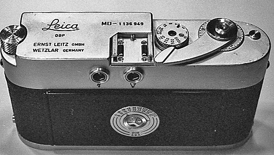

jc_braconi Posted November 10, 2020 Share #3 Posted November 10, 2020 This one is stamped "POST" like the MDa Welcome, dear visitor! As registered member you'd see an image here… Simply register for free here – We are always happy to welcome new members! 2 Link to post Share on other sites Simply register for free here – We are always happy to welcome new members! ' data-webShareUrl='https://www.l-camera-forum.com/topic/314988-did-leica-md-post-ever-exist/?do=findComment&comment=4077921'>More sharing options...

luigi bertolotti Posted November 14, 2020 Share #12 Posted November 14, 2020 Hello JC 😎; sorry... but what makes 1160439 different from a standard MD ? I miss some detail... Link to post Share on other sites More sharing options...
Pecole Posted November 14, 2020 Author Share #13 Posted November 14, 2020 I also had a M3 "Post" 24x36. And I agree with Luigi : what did your MD have special? Welcome, dear visitor! As registered member you'd see an image here… Simply register for free here – We are always happy to welcome new members! Link to post Share on other sites Simply register for free here – We are always happy to welcome new members! ' data-webShareUrl='https://www.l-camera-forum.com/topic/314988-did-leica-md-post-ever-exist/?do=findComment&comment=4080197'>More sharing options...
jc_braconi Posted November 15, 2020 Share #14 Posted November 15, 2020 22 hours ago, luigi bertolotti said: Hello JC 😎; sorry... but what makes 1160439 different from a standard MD ? I miss some detail... It is the only one, at least, I have that it is engraved MD Link to post Share on other sites More sharing options...
Pecole Posted November 15, 2020 Author Share #15 Posted November 15, 2020 1 hour ago, jc_braconi said: It is the only one, at least, I have that it is engraved MD This one too is engraved MD, and it is about 24000 "younger" than yours. Welcome, dear visitor! As registered member you'd see an image here… Simply register for free here – We are always happy to welcome new members! Link to post Share on other sites Simply register for free here – We are always happy to welcome new members! ' data-webShareUrl='https://www.l-camera-forum.com/topic/314988-did-leica-md-post-ever-exist/?do=findComment&comment=4080812'>More sharing options...

alan mcfall Posted November 17, 2020 Share #17 Posted November 17, 2020 (edited) Here are a couple of MD's from the 1160 201-1160820 batch to compare with JC's 1160439. They are consecutive serial numbers 703 and 704. I always liked MD's and MDa's. I have 15 including posts. My anaylis of the MD shows 3216 built with 227 posts of 24 x 36 and only 99 of the 27 x 36 format. With post cameras beginning before the MD, as mentioned in an above post. I believe there were 207 post cameras delivered before the first MD at 1102501. This may support that early MD post camera followed from the M1. Allways welcoming any new information.There were more than 1800 Mda's built before the first Mda Post at 1164866. My opinion, as assigned lots are always not consecutively serialized. May depend on when the Post Office placed their orders. Welcome, dear visitor! As registered member you'd see an image here… Simply register for free here – We are always happy to welcome new members! d1, Edited November 17, 2020 by alan mcfall 2 Link to post Share on other sites Simply register for free here – We are always happy to welcome new members! d1, ' data-webShareUrl='https://www.l-camera-forum.com/topic/314988-did-leica-md-post-ever-exist/?do=findComment&comment=4081766'>More sharing options...
