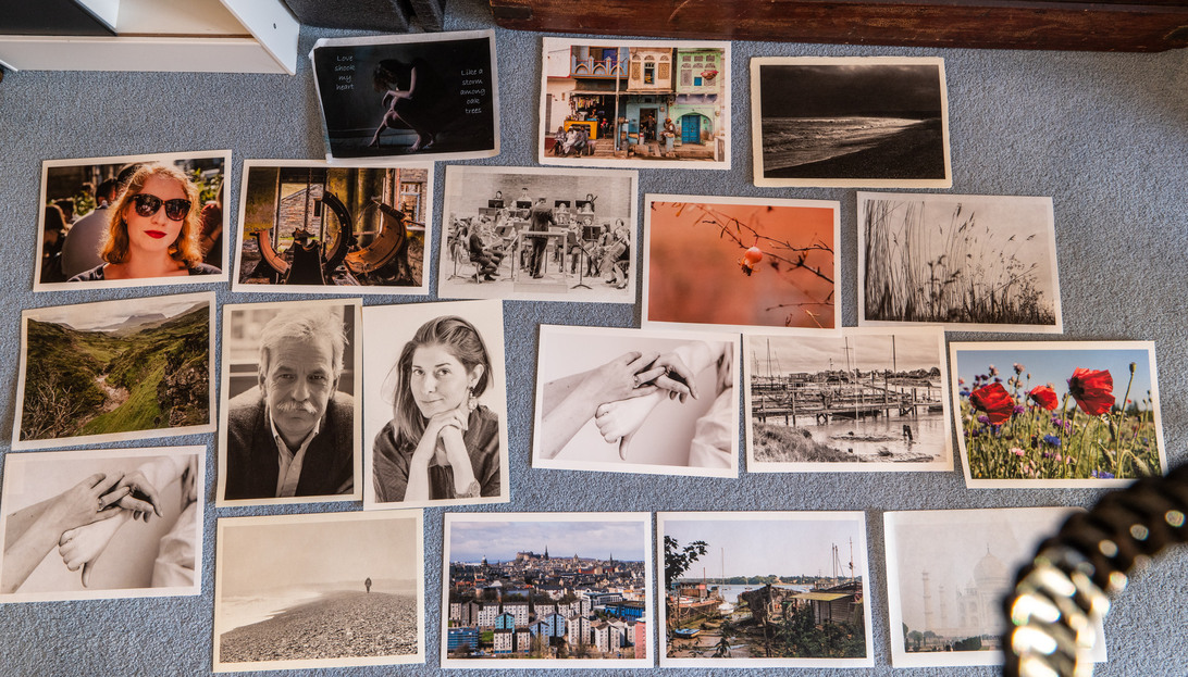

LocalHero1953 Posted November 5, 2020 Author Share #12  Posted November 5, 2020 I ordered two sample packs of papers, so I could run through one pack in ignorance, and the second pack with a bit more experience. Here is the result of printing the first pack with 18 random images (the duplicate pair of hands in the middle has been accidentally included, printed on Canson Rag Photographique). They were printed on an Epson P800, using the front feed tray, and with printer colour profiles downloaded from the Awagami website. Monochrome prints were made with the Epson Advanced Black & White defaul settings. (Sorry for the wrist strap protruding into the image!). Awagami also provide paper thicknesses which I used to set the printer. I printed a number of the images also on Canson Rag Photographique, as a generic 'western' matt paper. My early, unreliable, comments and conclusions so far: - Canson Rag Photographique wins hands down in terms of bright colour, contrast, punch and (mono & colour) detail. Obviously, as I learn more, I might improve contrast, perhaps colour punch, but probably not detail. - One cannot ignore the texture and feel of the Japanese paper. It reminds you every time that physical prints are different from screen images, in looks, light on the surface and feel in the hand. The Japanese paper prints, machine or hand made, have a more organic feel compared to the Canson equivalent. The Bamboo papers in this pack are the closest to the Canson in this sense, the thin papers, and deckle-edged Bizan papers are most alien. As Stuart wrote above, it would be a waste to frame these papers behind glass. - Delicate colours and tonal transitions are better served by the Japanese paper. In the image of the girl with red lipstick (Kozo White Medium), the skin texture looks better than in the Canson equivalent, even though the latter has a slightly greater contrast and punch. The pink berry also works well. - The thin papers are fascinating in their possibilities, whether single layer or double layer (which have to be carefully peeled to remove the pulp backing). The Mitsumata White Double Layer (Taj Mahal in mist, bottom right) is lovely and translucent in the hand, but how to mount and display it? The Kozo Double Layer (the dark figure with text, top left) needs more careful handling and peeling than I could give it, and it curled badly; it held ink well, though, to give a solid tone, despite the translucency. The thin single layer papers would be good in books. - The Unryu papers have distinctive surface reflectivity, almost like a timber wafer board. I've seen comments that it works well with portraits (e.g. the girl, centre left, monochrome). I'm not convinced - it just looks like skin blemishes! - In all cases but one the front feed worked well; the exception was when I forgot the Epson P800's common (design) fault of catching on the back support while feeding in. (I normally deal with this by pressing fingers on the rear support till the paper is in place). No head strikes, no blotches. A more general preliminary observation: that these papers are better with naturalistic subjects: landscapes and people. Buildings and artefacts are better with the Canson Rag Photographique. Welcome, dear visitor! As registered member you'd see an image here… Simply register for free here – We are always happy to welcome new members!  6 5 Quote Link to post Share on other sites Simply register for free here – We are always happy to welcome new members!  ' data-webShareUrl='https://www.l-camera-forum.com/topic/314672-washi-japanese-papers-for-inkjet-printing-experience/?do=findComment&comment=4074489'>More sharing options...

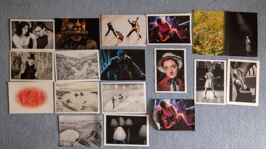

LocalHero1953 Posted November 16, 2020 Author Share #15  Posted November 16, 2020 (edited) I have just finished test prints on my second sample pack from Awagami. Building on what I learned from the first pack, I: - Printed photographs of people, landscape and nature, avoiding buildings and manmade objects. - Looked at how well borderless printing works. - Looked at how well the thin papers stood up to dense coloured images (lots of ink), as well as sparse images with lots of light background. - Printed on both sides of the Inbe Thin paper; although not marked on the pack as suitable for double sided, I'd seen remarks online that the Inbe paper was designed for double sided. Further conclusions: - Borderless printing presented no problems (I didn't expect any, but worth checking). - The Murakumo Kozo Select thin papers held ink well (dark blue image of man in the centre, and B&W girl singing top right corner) showed the image on the reverse, but with little obvious lateral seepage. The Kozo Thin papers showed even less (landscape with two rocky islands, centre left, two dancing couples, top centre). - The Inbe Thin White, which I printed double sided with dense coloured images (girl in the red jacket, centre right) showed no obvious sign of the images on the respective reverses. Common sense says this needs further examination, but if it remains the case, then this looks like a good paper for photobooks. - The double layered papers remain challenging, both to peel and mount. My experience from the first batch was repeated: the Mitsumata White Double Layered (landscape of Helvellyn, bottom left) was fairly easy to separate with care. The Kozo Double Layered is tricky and easy to tear as you start to peel, and remains curled (lovers in dark red, bottom right). I understand these papers are designed to be made into Japanese hanging scrolls. - I tried two different image types with the Unryu paper (the one with the waferboard-like surface texture). A borderless print of a wildflower garden (top right): the paper pattern was lost entirely; I can see no benefit to this paper for such an all-over image. The clunky vignette of pink plants (lower left): the paper adds something here because the texture is visible in the un-inked or light colour parts. This is not really the sort of photography I do, but I can see a benefit to the paper here.  - Generalising from the foregoing conclusion, all these papers show themselves at their best where the texture of the paper can be seen. I would be inclined to print dense colour images with a large border, or use these papers for images where there are plenty of light areas. - I don't think I have examined B&W landscapes particularly well here, though I included several (all given a similar high key, high contrast treatment). It's not a type of photography I do much of and I doubt that I am particularly good at processing them for printing on western paper, let alone these Japanese papers. So will I buy some more? Probably! I want to make some photobooks, so the Inbe Thin papers are attractive. The Bizan (handmade) papers are stunning, and expensive. They would make great presents, for holding. Or mounted held away from a plain background, to show the deckle edges - but these aren't for everyday use. Welcome, dear visitor! As registered member you'd see an image here… Simply register for free here – We are always happy to welcome new members! Edited November 16, 2020 by LocalHero1953 4 4 Quote Link to post Share on other sites Simply register for free here – We are always happy to welcome new members! ' data-webShareUrl='https://www.l-camera-forum.com/topic/314672-washi-japanese-papers-for-inkjet-printing-experience/?do=findComment&comment=4081142'>More sharing options...
