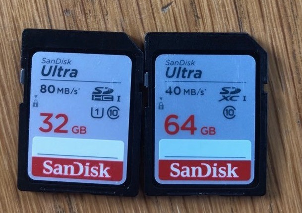

analog-digital Posted August 26, 2020 Share #17 Posted August 26, 2020 Welcome, dear visitor! As registered member you'd see an image here… Simply register for free here – We are always happy to welcome new members! This will work. The very newest NOT. Link to post Share on other sites Simply register for free here – We are always happy to welcome new members! This will work. The very newest NOT. ' data-webShareUrl='https://www.l-camera-forum.com/topic/312675-m-monochrom-fried-toast/?do=findComment&comment=4033905'>More sharing options...
Lew Posted August 26, 2020 Author Share #18 Posted August 26, 2020 17 minutes ago, analog-digital said: Welcome, dear visitor! As registered member you'd see an image here… Simply register for free here – We are always happy to welcome new members! This will work. The very newest NOT. It's a total mystery and the Tech I'm working with doesn't understand it either. I have 3 Transcend SDHC I's, 16 & 32gb, which bring the camera to a grinding halt. My 2 SDHC II's otoh, format & record just fine. 32gb is the largest card supported according to the tech spec sheet, btw. Link to post Share on other sites More sharing options...
