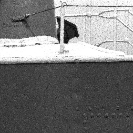

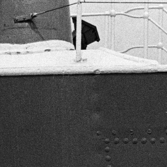

Richardgb Posted January 12, 2020 Share #8 Posted January 12, 2020 If you can post an enlarged section of the image to show the image structure more clearly, this would help establish whether it is 'grain' or something else. However, from the images posted (as others have said), it looks like 'grain'. As a related point of possible interest, many years ago (before digital) I went to a talk by a leading newspaper photographer (can't remember his name or the title now). He showed examples of an 8x10in print from a 35mm negative and the half-tone image printed in the paper (in those days, with relatively coarse paper, a 65dpi, or maybe slightly finer, half-tone screen would have been used). The dots of the half-tone image were far larger than the grain of the image in the print, where 400ISO (or ASA in those days!) film was normal. The point the photographer was making was that for normal newspaper work, 35mm film gave an image which was more than adequate for newspaper use, in many cases even when only part of the frame was used. 1 Link to post Share on other sites More sharing options...

dkmoore Posted January 12, 2020 Author Share #12 Posted January 12, 2020 18 minutes ago, Richardgb said: If you can post an enlarged section of the image to show the image structure more clearly, this would help establish whether it is 'grain' or something else. However, from the images posted (as others have said), it looks like 'grain'. As a related point of possible interest, many years ago (before digital) I went to a talk by a leading newspaper photographer (can't remember his name or the title now). He showed examples of an 8x10in print from a 35mm negative and the half-tone image printed in the paper (in those days, with relatively coarse paper, a 65dpi, or maybe slightly finer, half-tone screen would have been used). The dots of the half-tone image were far larger than the grain of the image in the print, where 400ISO (or ASA in those days!) film was normal. The point the photographer was making was that for normal newspaper work, 35mm film gave an image which was more than adequate for newspaper use, in many cases even when only part of the frame was used. I’ll send this later this evening when I’m back in front of the computer. Link to post Share on other sites More sharing options...
