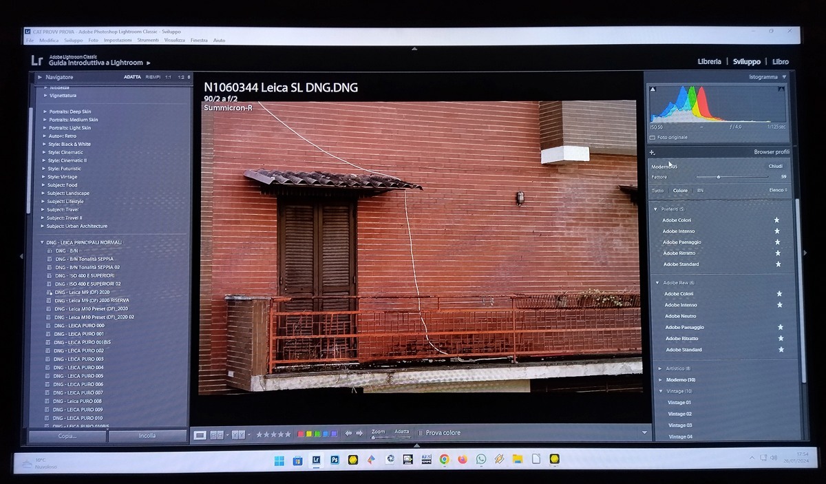

theseahawk Posted January 23, 2024 Share #19 Posted January 23, 2024 (edited) I understand that Leica embeds the camera and lens profiles in the DNG, and when I look at the EXIF metadata in the Library/metadata panel, it shows both. However doesn't the DNG also carry the camera sensor's color profile? I'm not understanding why the M10 color profile identifier shows up in the profile browser in the develop module but the SL2's doesn't... Also, above I confused presets with profiles. I'm more interested in why the latter is showing up differently between the two Leicas. Edited January 23, 2024 by theseahawk Link to post Share on other sites More sharing options...
