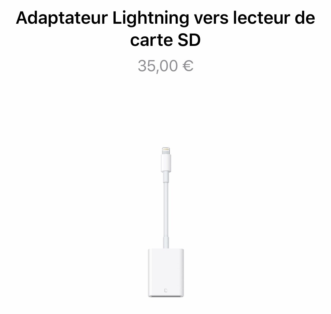

nicci78 Posted October 7, 2019 Share #14 Posted October 7, 2019 (edited) If you have an iPhone buy the SD card to Lightning from Apple. It works flawlessly, every time you need it. And it is way faster and more reliable than any WiFi connection. No need to fiddle with badly designed and poorly programmed App. Welcome, dear visitor! As registered member you'd see an image here… Simply register for free here – We are always happy to welcome new members! Edited October 7, 2019 by nicci78 1 Link to post Share on other sites Simply register for free here – We are always happy to welcome new members! ' data-webShareUrl='https://www.l-camera-forum.com/topic/302138-why-is-the-cl-does-not-connect-with-leica-fotos%E2%80%9C/?do=findComment&comment=3832299'>More sharing options...
jaapv Posted October 7, 2019 Share #15 Posted October 7, 2019 Yes I have it and it works well. However not as a remote and you have to remove the handgrip. I would like to have FOTOS for OSX, though. 1 Link to post Share on other sites More sharing options...
