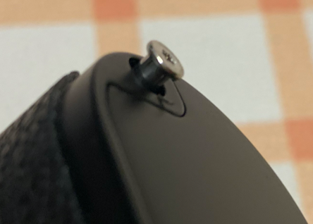

MaxHu Posted May 25, 2021 Share #15 Posted May 25, 2021 My M10 rangerfinder got stuck 2 days ago and I found the reason. As the picture show below, in the rangerfinder, lens rear fringe drive Part I, and Part I drive part II via a metal point(red dot) of Part I rub the edge of Part II (red line), here is the cause of sticky-----two metal parts interact via sliding friction rather than rolling friction, and due to lack of lubrication, Part I and Part II got sticky even stuck some day. Solution: It's very simple, a tiny drop of lube on the touch action surface ! Welcome, dear visitor! As registered member you'd see an image here… Simply register for free here – We are always happy to welcome new members! Step 1: Remove the top cap It's quite simple, just 2 screws(one is in the button conner, the other one in the battery room), as pictures shows below, easier than M240. Lubrication surface: see pictures below, the dark imprinting line(in red circle) is the scratch mark, put one drop of lube, it's down! 2 2 Quote Link to post Share on other sites Simply register for free here – We are always happy to welcome new members! Step 1: Remove the top cap It's quite simple, just 2 screws(one is in the button conner, the other one in the battery room), as pictures shows below, easier than M240. Lubrication surface: see pictures below, the dark imprinting line(in red circle) is the scratch mark, put one drop of lube, it's down! ' data-webShareUrl='https://www.l-camera-forum.com/topic/293403-m10-sticky-rangefinder-coupling/?do=findComment&comment=4207630'>More sharing options...
Oswalt Posted May 25, 2021 Share #16 Posted May 25, 2021 2 hours ago, MaxHu said: My M10 rangerfinder got stuck 2 days ago and I found the reason. As the picture show below, in the rangerfinder, lens rear fringe drive Part I, and Part I drive part II via a metal point(red dot) of Part I rub the edge of Part II (red line), here is the cause of sticky-----two metal parts interact via sliding friction rather than rolling friction, and due to lack of lubrication, Part I and Part II got sticky even stuck some day. Solution: It's very simple, a tiny drop of lube on the touch action surface ! Welcome, dear visitor! As registered member you'd see an image here… Simply register for free here – We are always happy to welcome new members! Step 1: Remove the top cap It's quite simple, just 2 screws(one is in the button conner, the other one in the battery room), as pictures shows below, easier than M240. Lubrication surface: see pictures below, the dark imprinting line(in red circle) is the scratch mark, put one drop of lube, it's down! Screws need to be removed from the bottom of the camera to remove the top plate? Quote Link to post Share on other sites More sharing options...
Gobert Posted May 25, 2021 Share #17 Posted May 25, 2021 Yes Quote Link to post Share on other sites More sharing options...
MaxHu Posted May 26, 2021 Share #18 Posted May 26, 2021 5 hours ago, Oswalt said: Screws need to be removed from the bottom of the camera to remove the top plate? yes,a very long Screw (about 70mm )go through from bottom to top Quote Link to post Share on other sites More sharing options...
jaapv Posted May 26, 2021 Share #19 Posted May 26, 2021 5 hours ago, Oswalt said: Screws need to be removed from the bottom of the camera to remove the top plate? Take care: There is a flex cable and connector between camera body and top. Be aware that yoiu will be forfeiting your guaranty. Quote Link to post Share on other sites More sharing options...
