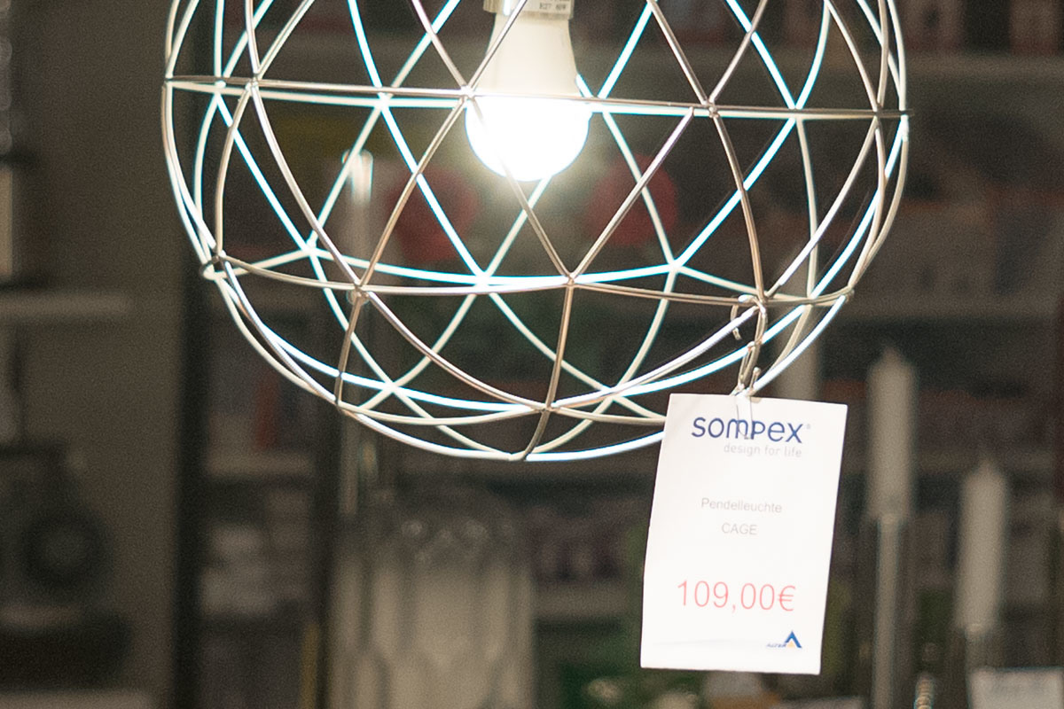

If one lifts the Shadows all the way and increases Exposure by 0.70 in LR
then the α7R III's DR can't handle it (crop with focus on the price tag of the lamp)
M10 (crop with focus on the price tag of the lamp)

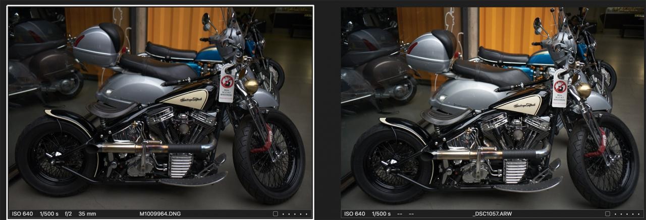

You got to be joking. You post JPEGs to prove your point? That's a good one. I'll just flood this thread with Raws to show Sony burned highlights. Let's face it, the α7R III sensor is an early 2015 design. It's a bit dated. Sony made a strategic blunder to use the same sensor as in the α7R II. The Nikon Zs and Panasonic's FF cameras to be revealed tomorrow have much better sensors. But then, again, Sony may reveal the α7R IV by year end. :)
No... That is a screen capture from a comparison view of the raw files in Capture One Pro 11.2.1. And they were imported to Capture One, and no settings were touched.
It seems to me like you have no idea what you are doing. Comparing two very different exposures (clearly evident by the changes in histograms) with each other, when one camera is known to use different ISO values to calculate exposures, and then saying that the camera that under-exposes images protects highlights... Seriously?
Your own raw files show different exposures. Just because the settings match, doesn't mean that the exposures match, when each camera calculates ISO values differently. You have to compare by having more or less matching histograms to have a valid exposure comparison.
