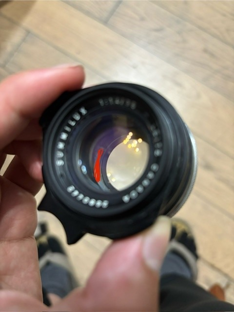

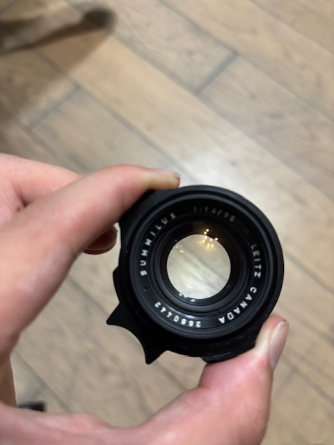

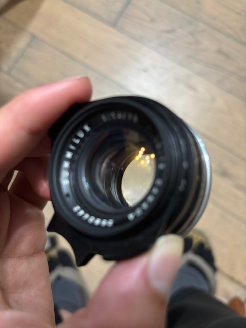

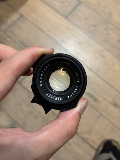

I examined the lens closely and thought I figured it out. There is a round shade behind the aperture blades. When you look through the lens from behind, and turn the aperture from 1.4 to 1.7, you won’t see the blades, because they are still block by the shade. So, the actual light transmission diameter is limited by this shade.
Attached are:
1. Red marks noting the shade I’m talking about.
2. When close half stop from 1.4, blades are still within the shade. (Front view)
3. Wide open, see how large is the area where light travels through.
4. 1.7, see the same area in the pic above, and they have the same area! And you can see the blades do come out but they block the same area as the shade behind.
So, in conclusion, what we’ve gotten since 1961 is a 35mm Summilux 1.7, judging from the real exposure results in image and metering.
