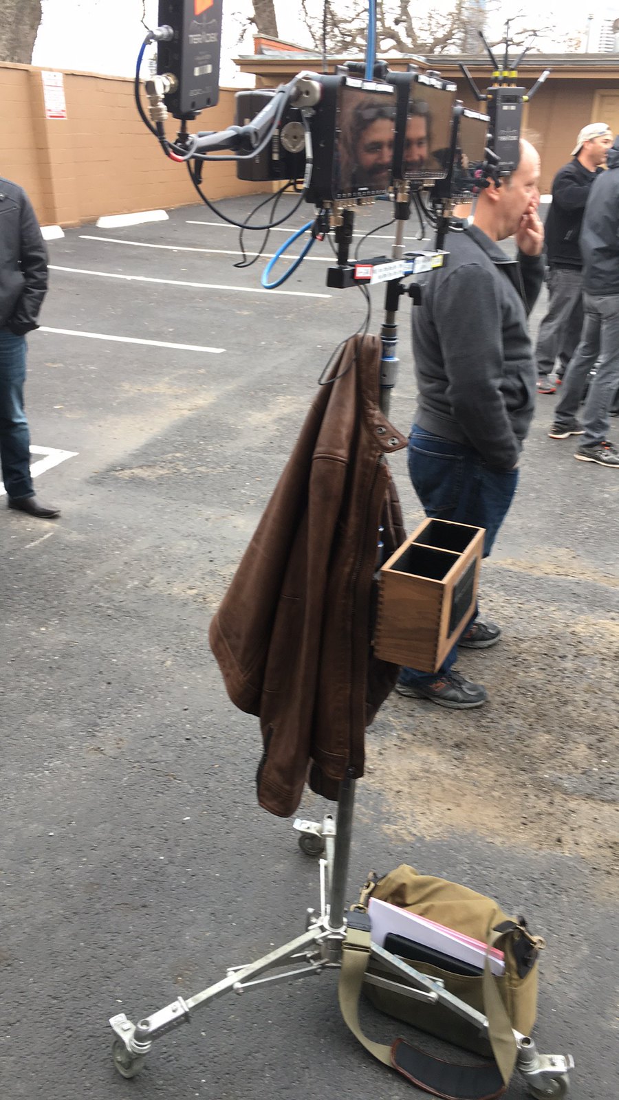

JohnBrawley Posted March 6, 2017 Author Share #7 Â Posted March 6, 2017 Advertisement (gone after registration) I have a ML-Grip made by PhotoEquip that I have used on my Ms. Very light weight, and adds about 1/4" to the height of the camera. Comfortable. Â It doesn't replace the original bottom plate, but once attached, you can load film without having to remove it. Â I'd give you the web address, but apparently I am supposed to throw a wet towel on you instead and insist you find that for yourself. Â Hello Old Wino. Â Thanks for the lead, that's a great tip. Â I've had a quick look at their website and they do seem to make what I'm after. Â Hopefully it doesn't add too much height. Â This will sound strange but an assistant of mine made me a special wooden holster case for my Leica's on set which I love using, but the tolerance on the height is very tight, so I need it to still fit into it's holster. If I add the standard Leica grip it won't fit into the case any more. Â At least I have somewhere to hang my wet towel. Â Untitled by John Brawley, on Flickr 3 Link to post Share on other sites More sharing options...
