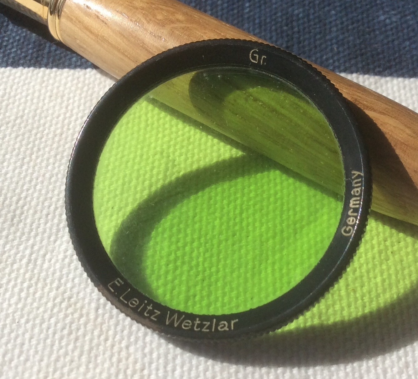

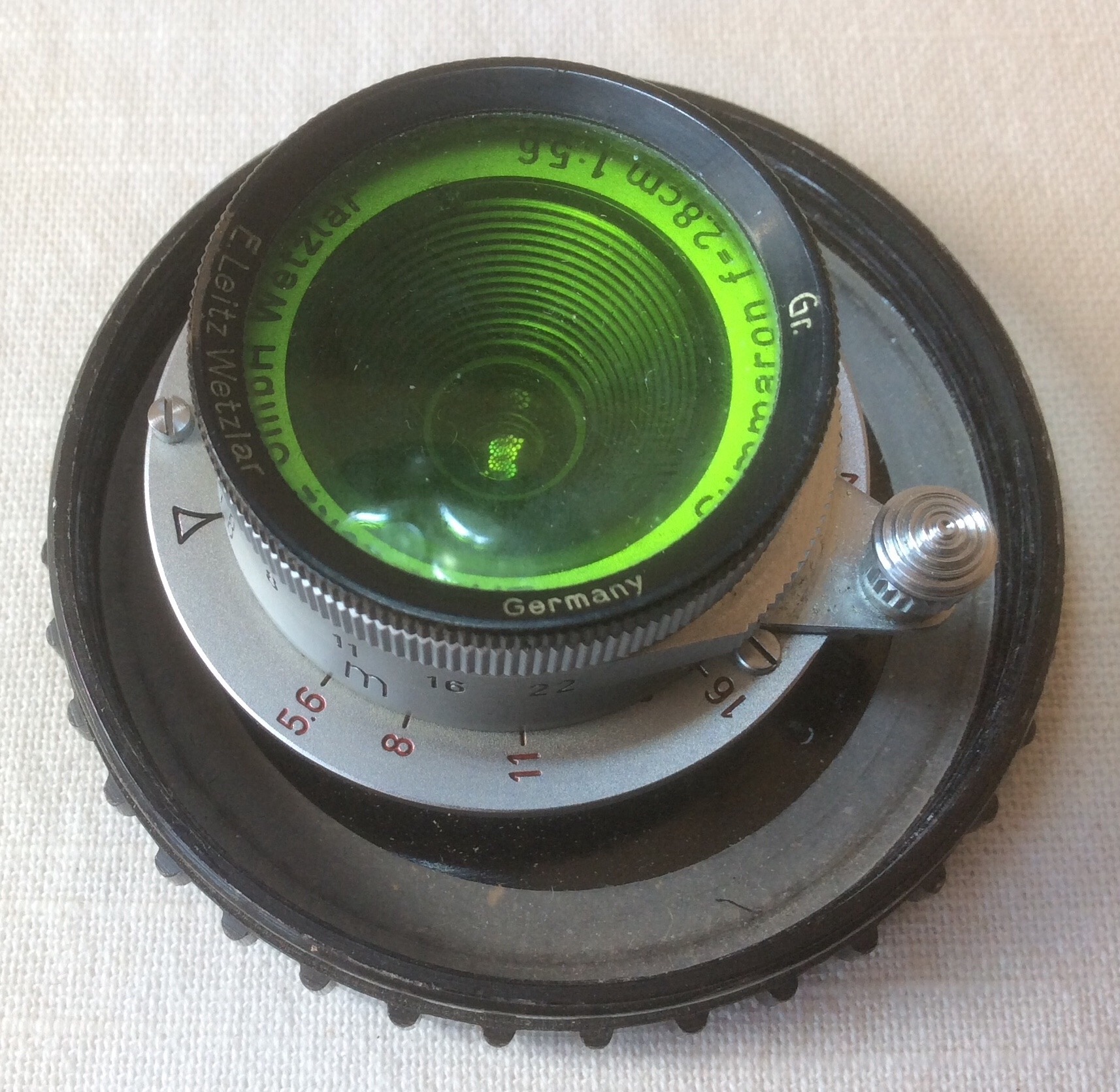

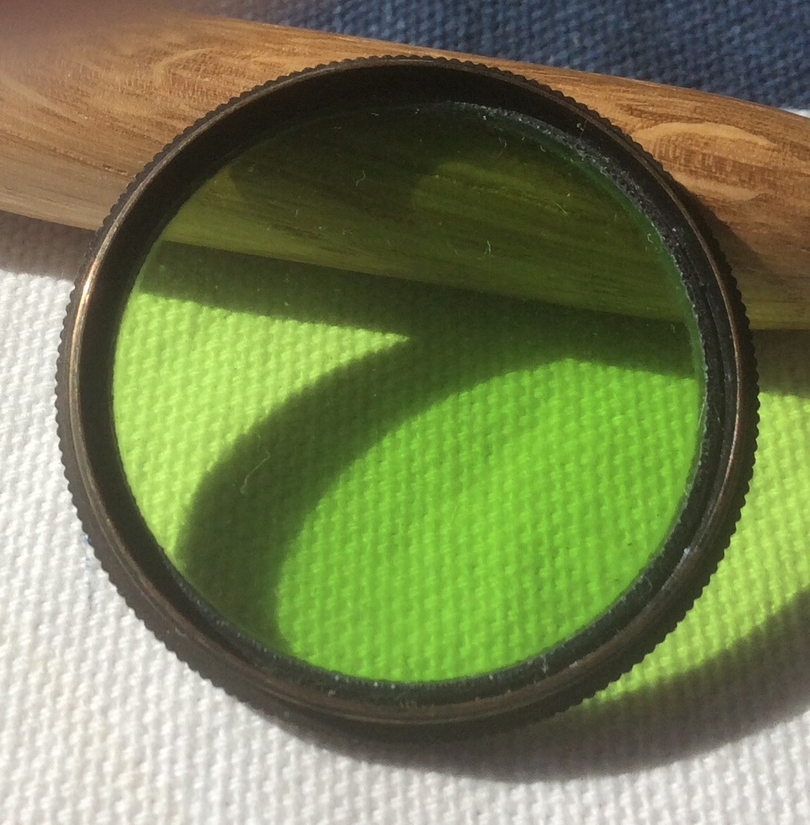

ramarren Posted April 15, 2024 Share #52 Posted April 15, 2024 21 hours ago, Pyrogallol said: Searching for “Leica filter Elmar hektor “ found one or two, but expensive. Try just searching for any Leica or Leitz filter and trawl through until you find something. https://www.ebay.co.uk/sch/i.html?_from=R40&_trksid=p2334524.m570.l1313&_nkw=leica+filter+elmar+hektor&_sacat=0&_odkw=leica+filter+elmar+hektor+summaron&_osacat=0 Okay, after half an hour of searching, I found one each of a yellow and a green filter in the E34 screw-in style. There are plenty of slip on and clamp on filters for A36, but of course Leica changed the outside diameter so they're not usable. ... But then, the Austrian vendor who has them blocks shipment to the USA... ??? Sheesh. Finding filters in the correct E34 size is a serious nightmare. Thanks, whomever it was who decided to make the 28 Summaron modern version with a 37.5mm OD and 34mm filter thread. 🤬 G 1 Link to post Share on other sites More sharing options...
