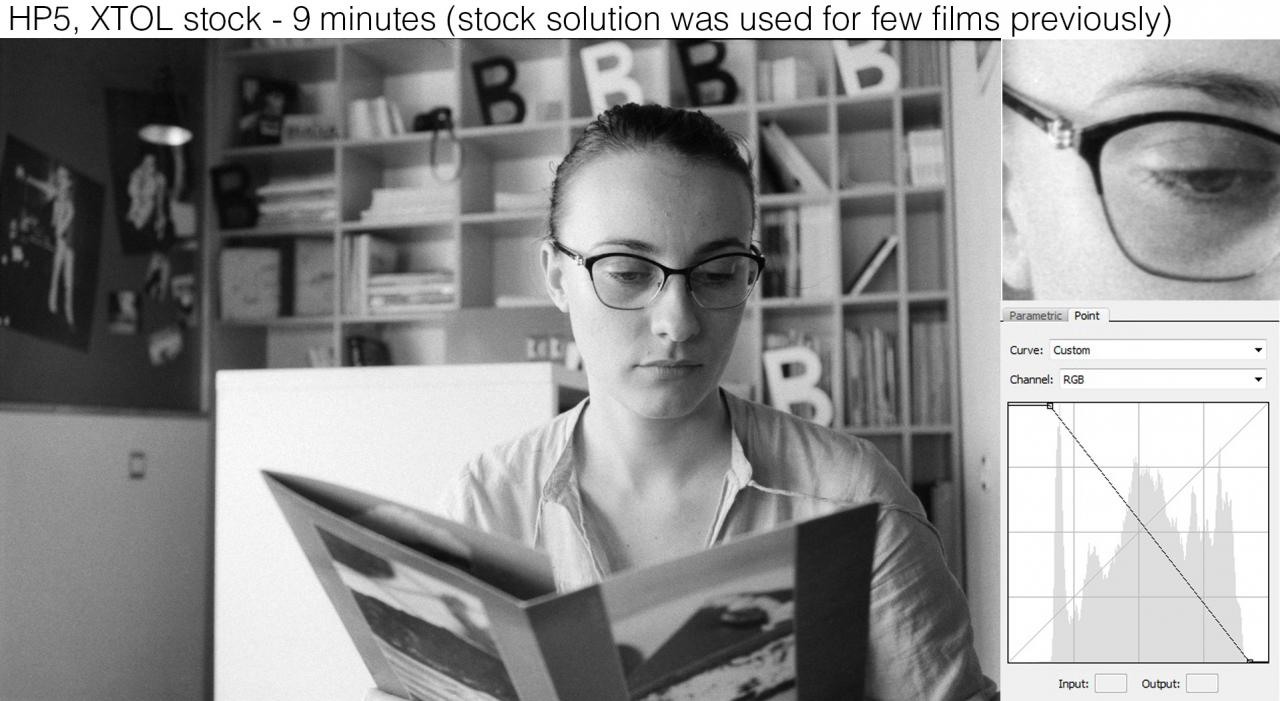

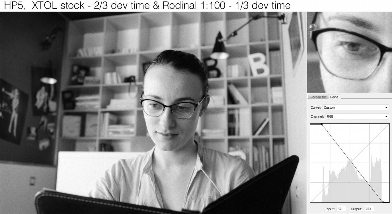

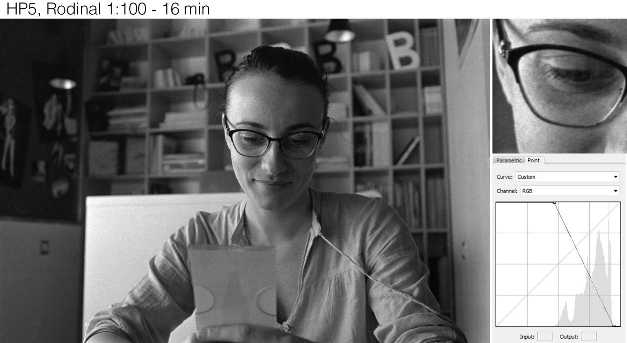

bruscwillis Posted April 4, 2018 Share #9 Posted April 4, 2018 Hi Martin, I know the thread it's silent for two years but I was looking these days for a formula of split development with Rodinal and Xtol. I have a 100 feet roll of HP5 at home and I developed it until now in Rodinal , D76 and Xtol. Rodinal at 1:50 gave me an ugly grain (I read later about this combo HP5 +Rodinal as being not pleasant all the time). D76 1+1 was ok. Xtol stock gave me fine grain, detail in shadows and also a flat look which was difficult to correct without ruining the skin tones (film is not digital, you can't push those sliders like on a 7D raw file). So.. I was realized that I liked the shadows of Xtol stock and Rodinal 1:50 highlights and I was thinking that maybe I could do a split development. Your images posted for HP5 split development looks amazing! Sharp, nice grain, very good separation between light, mid-tones and shadows, nothing mushy (like HP5 in straight Rodinal 1:50). Maybe can you share your recipe of split development? Something like Xtol stock or 1+1 for some% of total development time AND Rodinal 1:50/1:100 for rest of development time. Or maybe in the reversed order, I really have no idea. I hope you still have an account here and you will read this post at some time. Many thanks, Bogdan Link to post Share on other sites More sharing options...

Martin B Posted April 4, 2018 Author Share #12 Posted April 4, 2018 Hi Martin, I know the thread it's silent for two years but I was looking these days for a formula of split development with Rodinal and Xtol. I have a 100 feet roll of HP5 at home and I developed it until now in Rodinal , D76 and Xtol. Rodinal at 1:50 gave me an ugly grain (I read later about this combo HP5 +Rodinal as being not pleasant all the time). D76 1+1 was ok. Xtol stock gave me fine grain, detail in shadows and also a flat look which was difficult to correct without ruining the skin tones (film is not digital, you can't push those sliders like on a 7D raw file). So.. I was realized that I liked the shadows of Xtol stock and Rodinal 1:50 highlights and I was thinking that maybe I could do a split development. Your images posted for HP5 split development looks amazing! Sharp, nice grain, very good separation between light, mid-tones and shadows, nothing mushy (like HP5 in straight Rodinal 1:50). Maybe can you share your recipe of split development? Something like Xtol stock or 1+1 for some% of total development time AND Rodinal 1:50/1:100 for rest of development time. Or maybe in the reversed order, I really have no idea. I hope you still have an account here and you will read this post at some time. Many thanks, Bogdan Hi Bogdan, here is my recipe for HP5+ 400 at ISO 400: 20 deg C water temperature 1. Rodinal diluted 1:100 for 10 minutes. Agitate every 2 minutes. 2. 3x rinse with water for 30 seconds each time 3. Xtol diluted 1:2 for 6 minutes. Agitate every minute. 4. Stop solution for 1 minute, agitate. 5. Fixer solution for 10 minutes, agitate every minute. 6. 2x rinse with water 7. Hypo Clearing Agent wash for 2 minutes, agitate every 30 seconds. 8. Final water rinse. 2 Link to post Share on other sites More sharing options...

bruscwillis Posted April 5, 2018 Share #17 Posted April 5, 2018 Hi Martin, Thank you for your answer! It seems that you are using diluted Rodinal for 2/3 of total development time recommended for HP5 and diluted Xtol for another 1/3 of total development time recommended for this developer. Did you noticed any speed loss? I noticed that Rodinal is usually losing some speed of film. I will make some tests with some strips of HP5 using your recipe and, also, the same recipe but with Xtol stock (and shorter time, of course) because if this works too giving nice images, I will be able to re-use the stock solution of Xtol. Link to post Share on other sites More sharing options...
Martin B Posted April 5, 2018 Author Share #18 Posted April 5, 2018 Hi Martin, Thank you for your answer! It seems that you are using diluted Rodinal for 2/3 of total development time recommended for HP5 and diluted Xtol for another 1/3 of total development time recommended for this developer. Did you noticed any speed loss? I noticed that Rodinal is usually losing some speed of film. I will make some tests with some strips of HP5 using your recipe and, also, the same recipe but with Xtol stock (and shorter time, of course) because if this works too giving nice images, I will be able to re-use the stock solution of Xtol. Not sure what you mean as "speed loss". The diluted amounts are quite normal in development processes and lead especially in the Xtol case to better highlight effects. I adjusted the times accordingly to the dilution. I have never used Xtol in stock solution, always diluted it 1:2 or 1:3. Also keep in mind that at higher developer concentration the development time is reduced which can be a bit tedious in this two-step development process when switching developers. You want to give it a bit of lead time - if you are a bit over for example 10 minutes with Rodinal (1:100) when rinsing, it is not as critical as with half of the time at double the concentration. Link to post Share on other sites More sharing options...
bruscwillis Posted April 5, 2018 Share #19 Posted April 5, 2018 Oh, you are right, of course, about timing. Regarding speed loss.. Rodinal is losing some speed of film (at least for HP5). If I should make an analogy, I would say that HP5 400 exposed at EI 400 developed in Rodinal 1:50 looks like HP5 exposed EI 800 developed in D76. It looks pushed. Probably, HP5 exposed at EI 200 and developed in Rodinal 1:50 looks like and HP5 400 developed in D76 or Xtol (in terms of shadow details, not grain). So, from this perspective, Rodinal is losing a stop from film speed for me (more or less). I noticed also when shooting in low light that I had to overexpose a stop an HP5 (if I knew that I am going to develop in Rodinal) in order to get some shadow details and exposed normally after I bought some Xtol. I attached 2 pictures to exemplify. You will see that the shadow details is good in Rodinal, but it comes with a stop overexposure. First picture is Xtol, second is Rodinal Welcome, dear visitor! As registered member you'd see an image here… Simply register for free here – We are always happy to welcome new members! Link to post Share on other sites Simply register for free here – We are always happy to welcome new members! ' data-webShareUrl='https://www.l-camera-forum.com/topic/258970-dual-development-which-one-to-use-first/?do=findComment&comment=3494484'>More sharing options...
