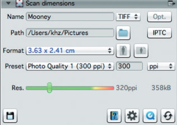

frame-it Posted October 26, 2018 Share #107 Posted October 26, 2018 (edited) Advertisement (gone after registration) Welcome, dear visitor! As registered member you'd see an image here… Simply register for free here – We are always happy to welcome new members! i use the plustek 8200i i can save the settings for each session..so what i do is setup the path / size / DPI etc and hit save on the bottom left of that menu box...and can recall it easily the SRDx tool works well for scratches provided one makes a mask, otherwise it will blur all over the place. i found a setting of 18, 3 seemed to work well for usual film handling scratches the IR SRD seems to work better for dust and simple scratches...i just leave it on detection 20 Edited October 26, 2018 by frame-it 2 Link to post Share on other sites Simply register for free here – We are always happy to welcome new members! i use the plustek 8200i i can save the settings for each session..so what i do is setup the path / size / DPI etc and hit save on the bottom left of that menu box...and can recall it easily the SRDx tool works well for scratches provided one makes a mask, otherwise it will blur all over the place. i found a setting of 18, 3 seemed to work well for usual film handling scratches the IR SRD seems to work better for dust and simple scratches...i just leave it on detection 20 ' data-webShareUrl='https://www.l-camera-forum.com/topic/257324-the-unthinkable-switching-from-vuescan-to-silverfast/?do=findComment&comment=3619982'>More sharing options...

Martin B Posted October 29, 2018 Share #114 Posted October 29, 2018 On 10/26/2018 at 9:05 AM, frame-it said: Welcome, dear visitor! As registered member you'd see an image here… Simply register for free here – We are always happy to welcome new members! i use the plustek 8200i i can save the settings for each session..so what i do is setup the path / size / DPI etc and hit save on the bottom left of that menu box...and can recall it easily the SRDx tool works well for scratches provided one makes a mask, otherwise it will blur all over the place. i found a setting of 18, 3 seemed to work well for usual film handling scratches the IR SRD seems to work better for dust and simple scratches...i just leave it on detection 20 Thanks for your helpful advice here - one problem with SilverFast is its fairly poor documentation when it comes to this kind of questions. What confuses me with SilverFast 8 is that there are multiple save buttons in different menus, and I gave up experimenting which save function saves which kind of control. In your example above, would this save button there only save the scan dimension and chosen resolution, or does it also save parameters in other menus below, for example usage of dust removal control etc? Link to post Share on other sites More sharing options...
frame-it Posted October 29, 2018 Share #115 Posted October 29, 2018 seems to save the dimensions and file details etc Link to post Share on other sites More sharing options...
